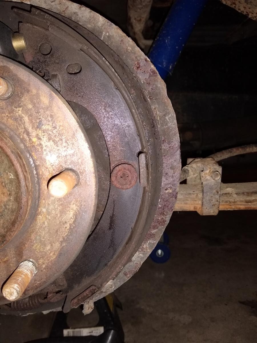

Oh, and the parking brake lever sticks a bit now that I got the right length cable, but I haven't taken it apart and cleaned all the rust out. Hoping that frees it up.
