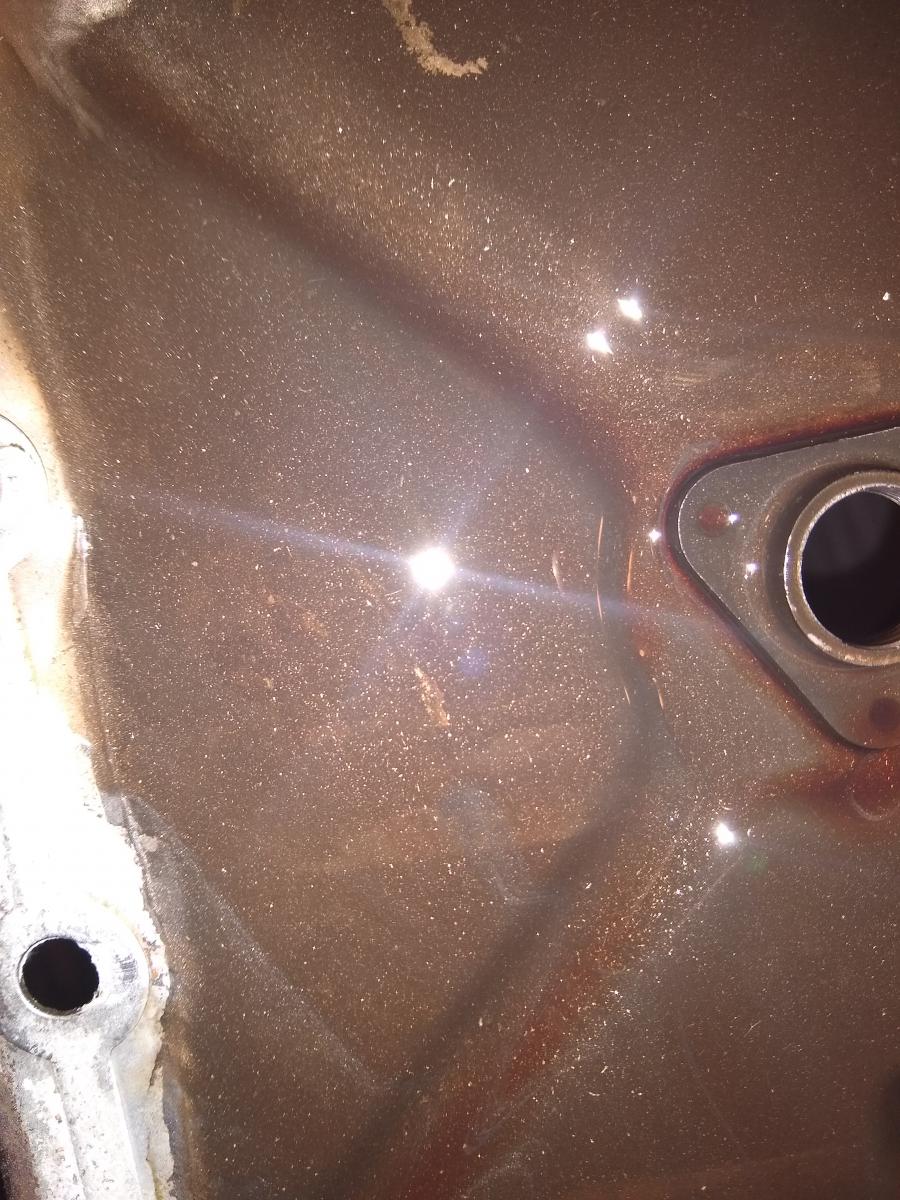

    Oh, and I "patched" the floor...
    My only regret is that I didn't have a street sign to use as a patch.

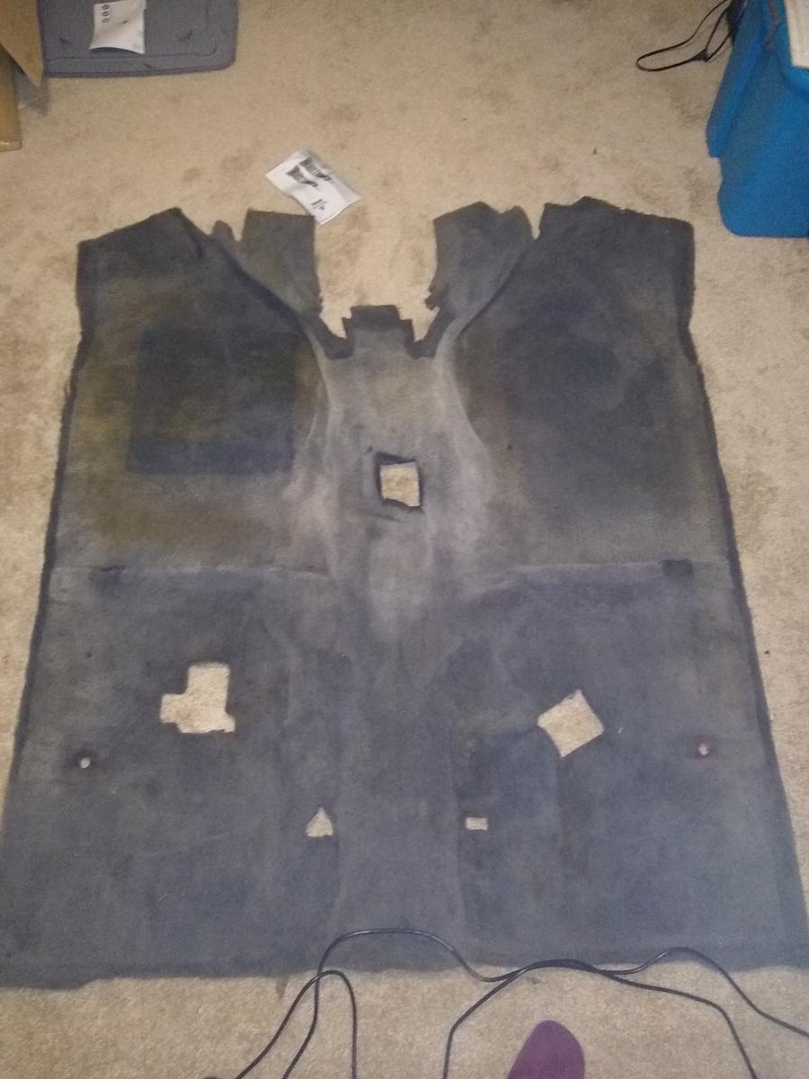

    Got the carpet as clean as it's ever going to be.
    That's after pressure washing, vacuuming, spraying down with upholstery cleaner, scrubbing with a stiff bristle brush, and finally using a carpet shampooer...
    I'm calling it good enough. I'm tired. Lol

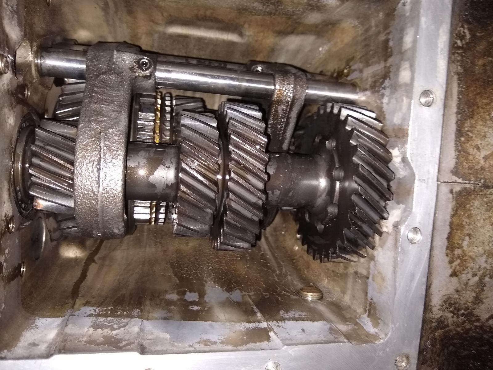

    I'm hoping there's a few people on here that have gone through the manual trans, might be able to tell me if there's any obvious wear that could result in issues down the road.
    Finally got all of the RTV off the bottom of the transmission, got the pan back on and filled it back up. No leaks, cork gasket FTW!

    Synchros appear to have relatively good sharp edges on them, no signs of unusual wear on the gear clusters in the pics. There looks like a few metal frags around the place though (guaranteed there will be a chipped gear tooth or 2 but that isn't abnormal...) Won't ever tell what the bearings are like from a pic but everything seems better than average

    There really wasn't much on the drain plug, but it did catch a few tiny flakes of steel.
    I figured the synchros would have more wear on them considering the amount of brass in the pan, but they've still got sharp edges. Lol

    The amount of brass in the pan is probably from
    the cone grooves, worn from an 30 year old? trans (lol).
    Can't see the 1'st gear ring, Can't see the 4'th gear ring
    (as the pics are taken with the trans in 4'th)
    Can't see the 5'th gear anything (duh) .
    However, a couple of things do stand out...
    1) Wear patterns on the main case gears (read counter and mainshaft)
    2) lubricant oxidation deposits = lack of service+ brief high load .
    Semi Helical gears develop VERY specific wear patterns .

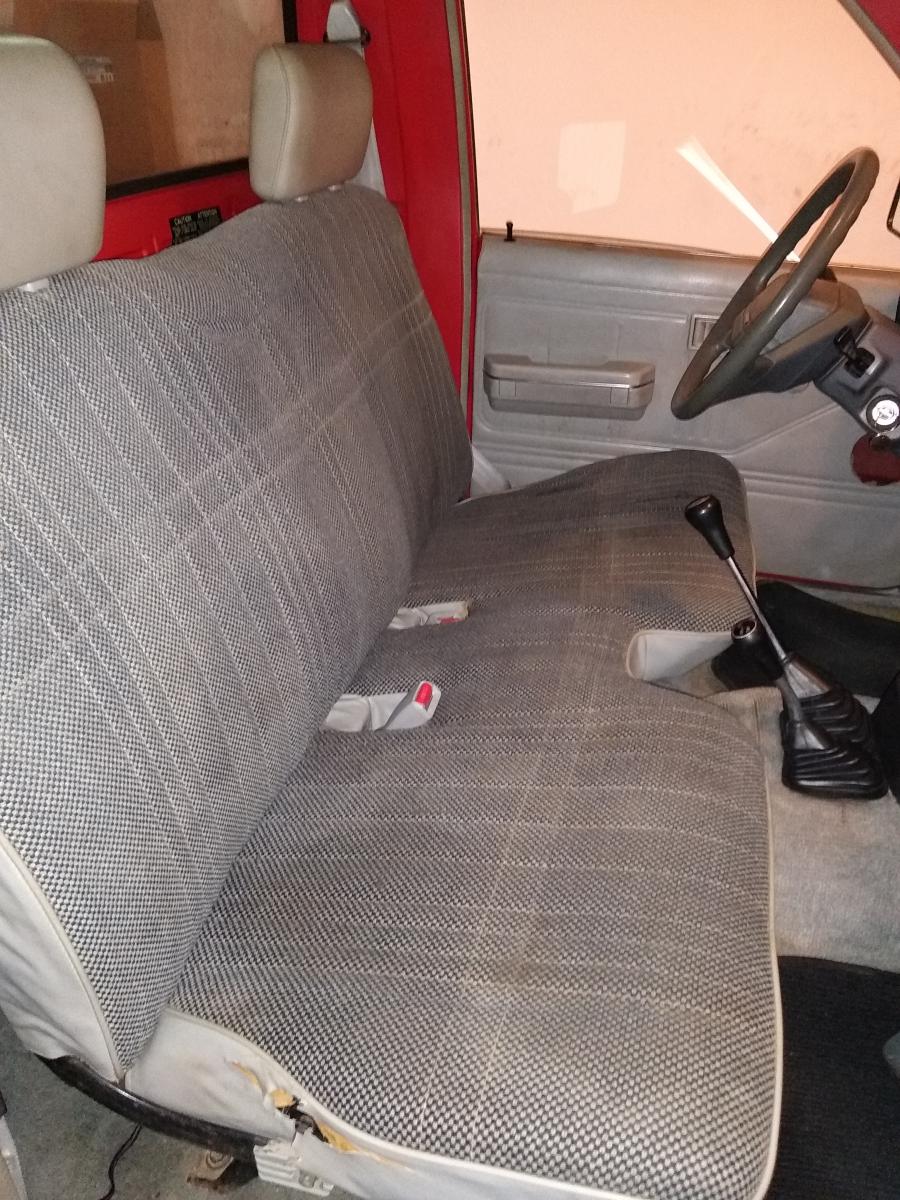

    I got quite a bit done today.
    Dropped the fuel tank to fix the blown out brake line, might have to bleed the master cylinder but at least the brake fluid isn't spraying onto the ground. While the fuel tank was down I got the fuel pump mounted to the underside of the bed, grounded it to the frame and ran the positive lead up to the engine compartment. I got the tailgate back on the bed, I'm gonna have to do some massaging to get it lined up properly, it's a little bent...
    Got the bench seat vacuumed and back in the truck, it's gonna need a deep cleaning but eventually I want to get it professionally reupholstered, it's one of the most comfortable bench seats I have ever sat on.
    It feels good to finally be able to sit in the cab without wanting to take a shower in bleach afterwards.

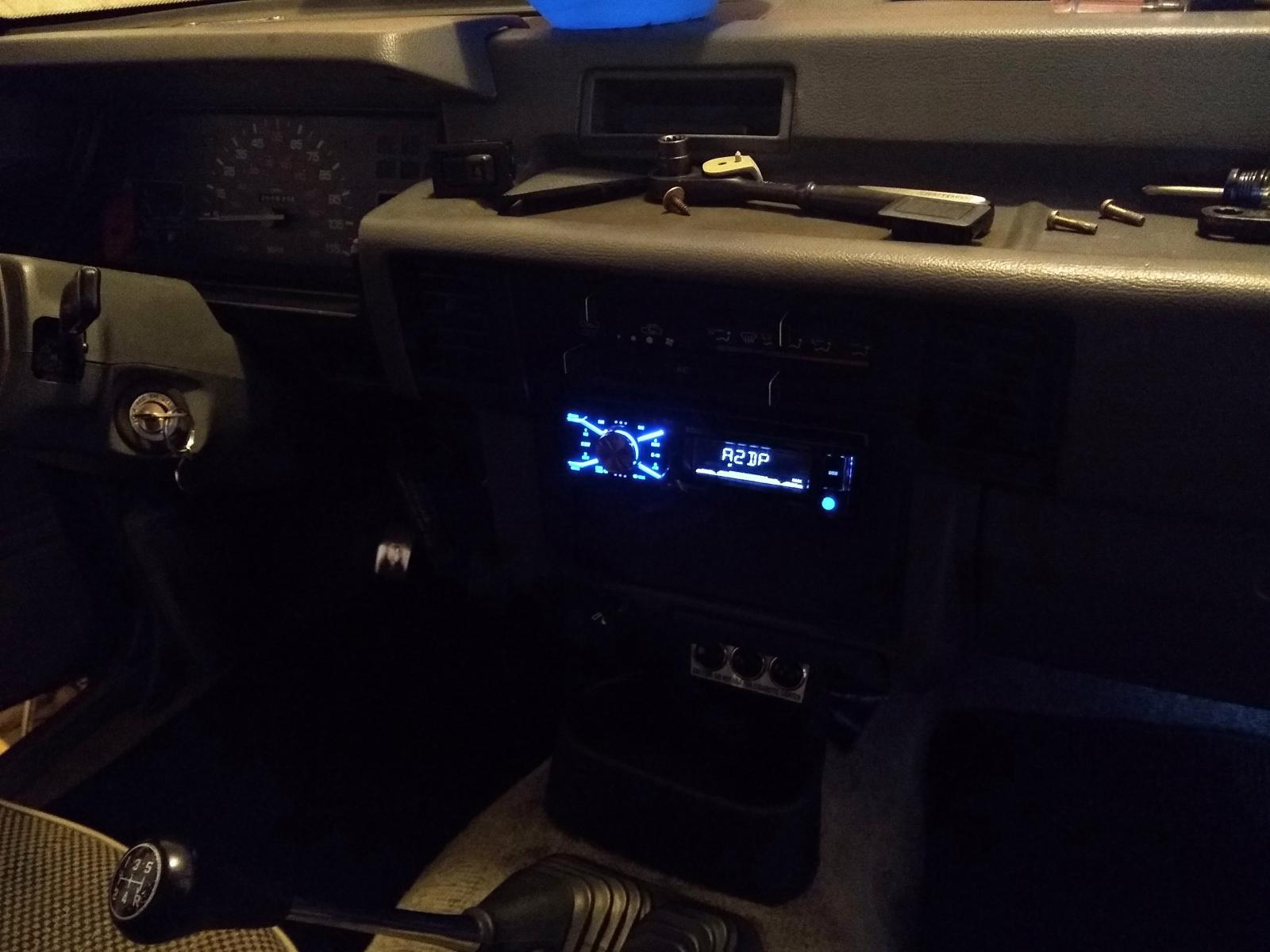

    I checked all the fuses, none of them look blown but I'm not getting switched +12v to the radio harness or the cigarette lighter, and the ashtray bulb went out.
    I tapped into the constant +12v for testing purposes, and I was mildly surprised that even with just the dash speakers it sounds decent.

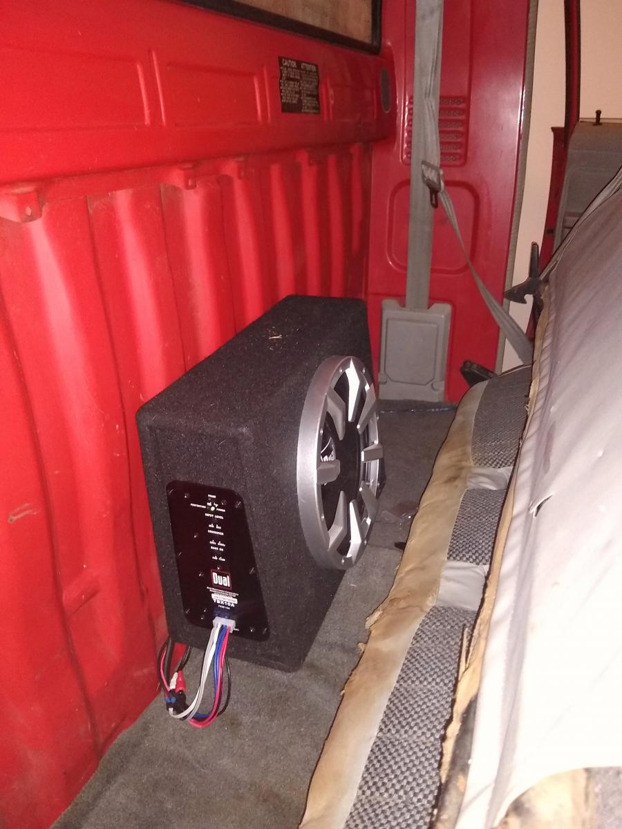

    And I did commit a sin and put the cheapest, lowest quality sub behind the bench... Because I had to have a bigger sub than my wife's car. I'm going to run it until it dies, and just use the box for a decent sub later. I did turn it down to where it's just noticeable, I have no desire for any more bass than that.
    What are those 3 knob-looking things under the ashtray?
    Here's a better picture of the 3 port 12v outlet block in it's rightful place, looking very 80's truck. And that cupholder is there temporarily, because it doesn't really fit as well as I hoped it would.

    The fuses can be misleading. You really need to go over the fuse block with a multimeter to check for power going in and out. Even removing them and reinstalling might be enough to clean contact surfaces.
