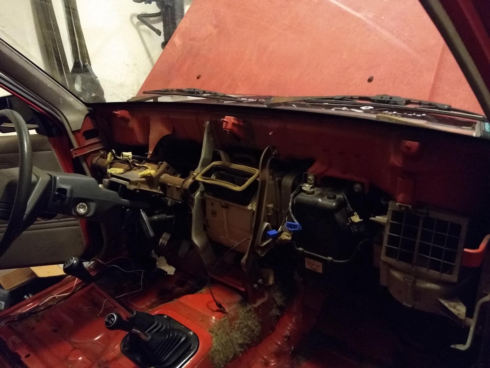

    I pulled the dash finally...
    And cleaned everything. Wired up the stereo, made a half-assed cover template for the lower half, and started cleaning the inside of the cab.
    Eventually I'll make an actual plate thick enough to mount switches or gauges, but this will be fine. I also picked up a set of 5x7s and a 10" sub... This truck might not be waterproof but it'll sound good. Lol

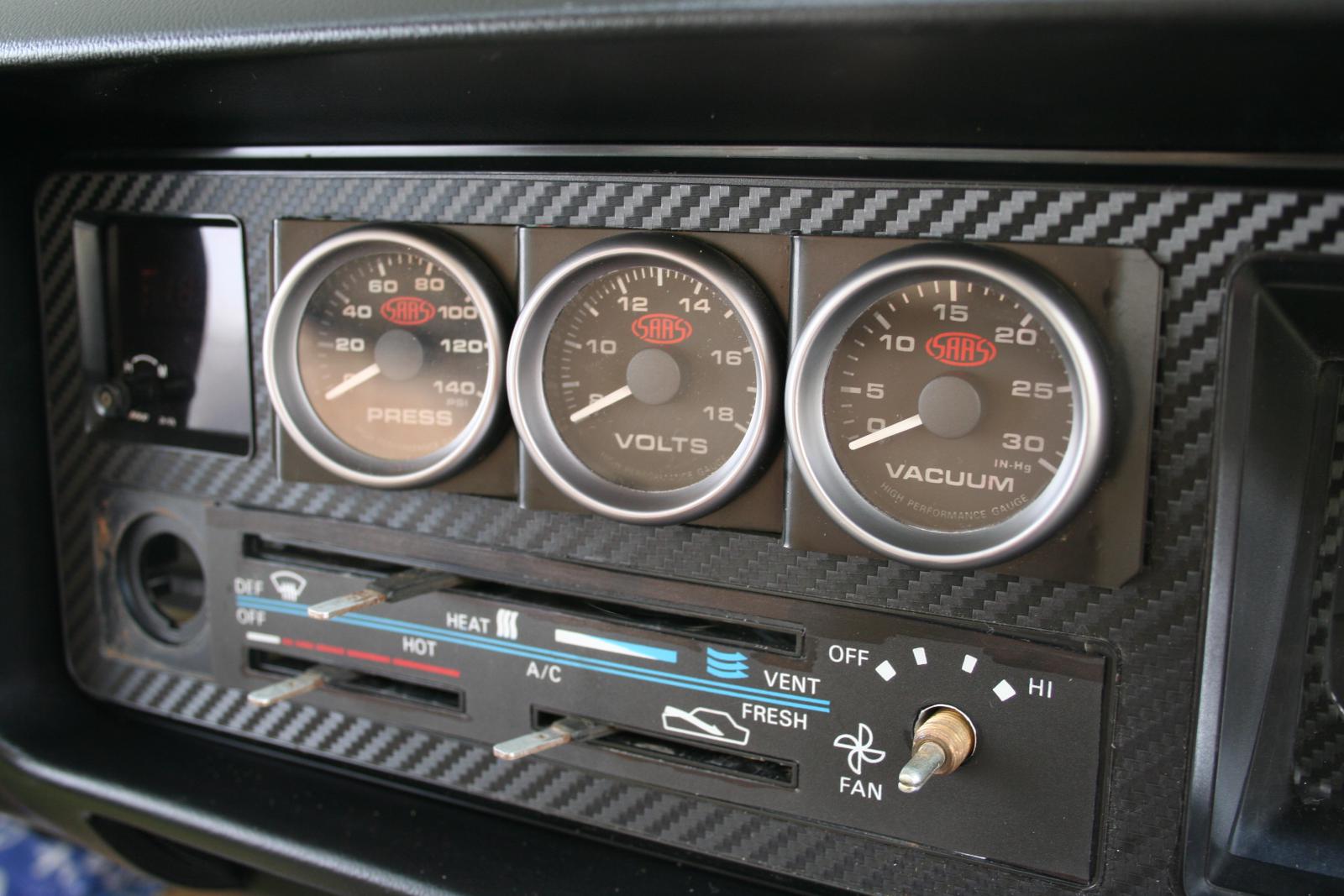

    "Done" I'm not trolling you but when does a resto ever get finished? The good thing about a dash pull out and heater box rebuild is you only need to do it once and ne'er touch it again for another 10 or 15 years (except if a core leaks or a heater valve decides to take a dump) Nice to get the country feel out of the air vents. A suggestion for your gauge cluster to fill your block off panel under your new stereo (I used something like this for my triple 2" gauge panel) -
    https://www.ebay.com/itm/2inch-TRIPL...4dbrArj:rk:12:
    How I set mine up in my Gen 1 -

    Speaking of heater box rebuild, what's the best starting point for disassembly? I'm trying to keep from disconnecting the A/C lines or pinching/bending anything that might be important...
    I'm debating on either doing gauges in that spot, or doing some form of pocket to hold random things. I'll concentrate on that after I get the rest of the interior situated. Like figuring out how I'm going to mount these two 5x7s...
  13. #63
    The A/C core in the Gen 2's appear to be in a separate housing to the heater box and blower fan so it should only be a case of undoing the clamps either side and leaving the A/C core untouched. The Gen 1's sort of had A/C as an afterthought and weren't as integrated as the HVAC on Gen 2's. I haven't messed with Gen 2's so someone here will have insight on how to disassemble it without removing any gas lines.

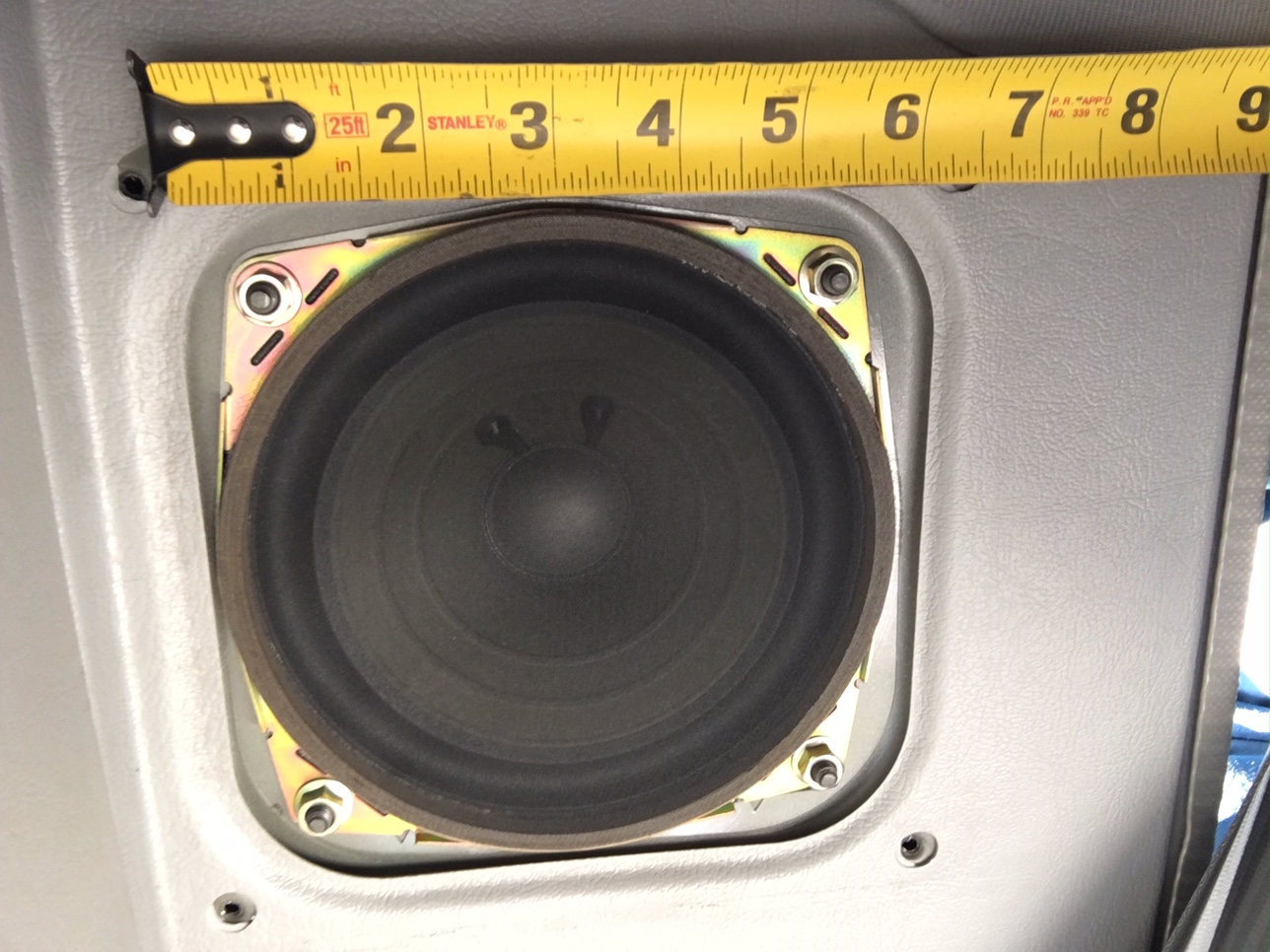

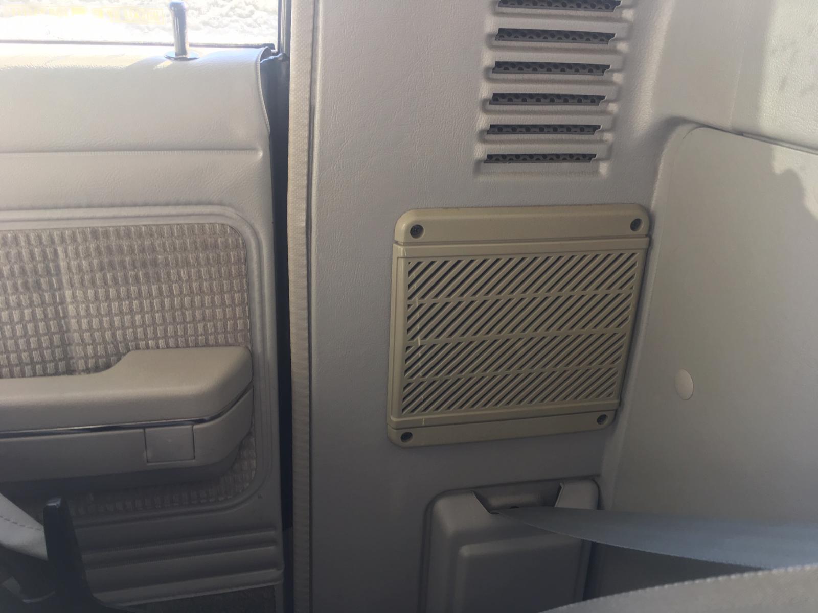

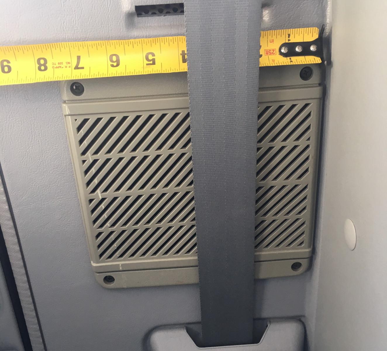

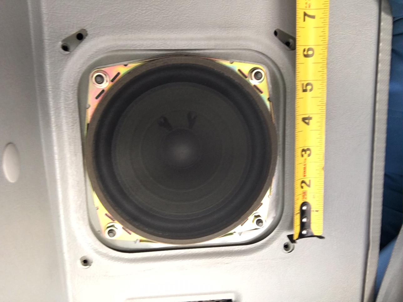

    Quote Originally Posted by WarStryker13 View Post
    Rear speakers: I've got some 5x7s that I'm planning on mounting behind the bench seat in the truck. Was there a factory option for rear speakers in any standard cab trucks? I'm only willing to cut holes in sheetmetal if I can find a stock or stock-looking speaker cover.
    I have an '87 standard cab with 4 speakers, 2 of them behind the bench seat. They are mounted on the sides, right next to the doors.
    EDIT- Here are some pictures The speakers are round, ~6" in diameter.
