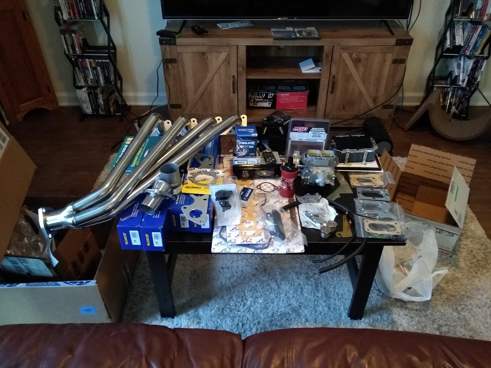

    Here's a pic of a pile of parts on a table. That is not all of the parts that I have ordered or will be buying/ordering, and I didn't add fluids to the pic.
    Soooo SHINY

    Plenty more shiny to come... lol

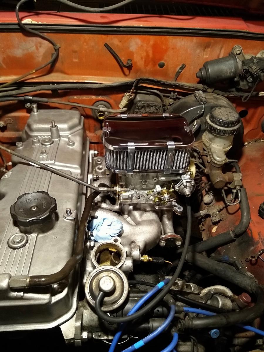

    I pulled off the valve cover and intake manifold, cleaned both, re-installed with new gaskets and blocked off the EGR port. I installed the Weber, got the throttle linkage and vacuum advance connected but I'm waiting to connect the fuel line because I'm planning on running new fuel line from the tank all the way up. I also pulled all the cables off the ground point directly under the battery, cleaned and re-installed, and found almost all of the hardware for the original battery hold down. Tomorrow I'll be picking up the heater hoses, and hopefully I can get the truck started tomorrow.
    Still have a lot more to do, but damn does that look good.

    Sweet! Love the look of the Weber air cleaner, much better than the frying pan that I have on mine...
    I'm curious about what you did with the EGR, what's involved in deleting or bypassing this function, etc. Did you have to use a kit?
    Excellent. Good luck with the first start up

    It's just a block off plate. They are available off the shelf and it's a straight forward way to delete the gas recirculation. I did something a little more radical to my G63B manifold and actually cut the the whole gas gallery from the manifold and had a threaded bung tapped into the gas gallery in the head to seal it. I need to make a small cover plate to complete the process or plug it with JB weld as this is part of my quirky Lancia carb swap I've got in the pipe line (you can't completely cut the EGR mount off as part of it breaches the plenum chamber which would leave a big hole in the manifold).

    I had extra parts left over from my previous car, and the PCV valve cover plate from it fit where the EGR solenoid used to be... It's not exactly perfect, but it fits well enough that I just put a thin layer of RTV on it and called it good.
    Speaking of blocking off stuff... I want to block off the fuel pump hole in the side of the head, but the plastic spacer was already broken and adding to the oil leaks all over the engine. Do most people just make their own block off plate?

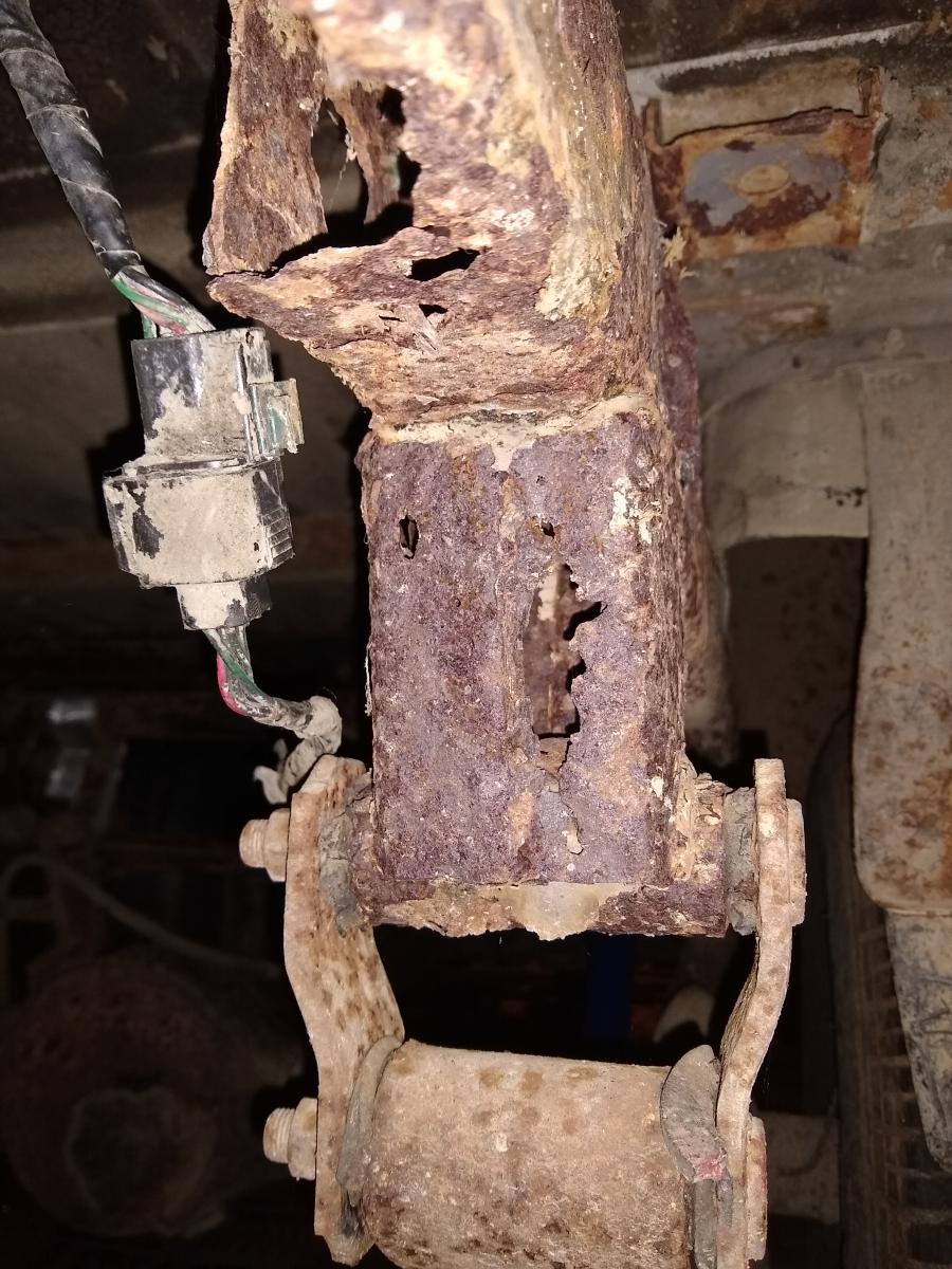

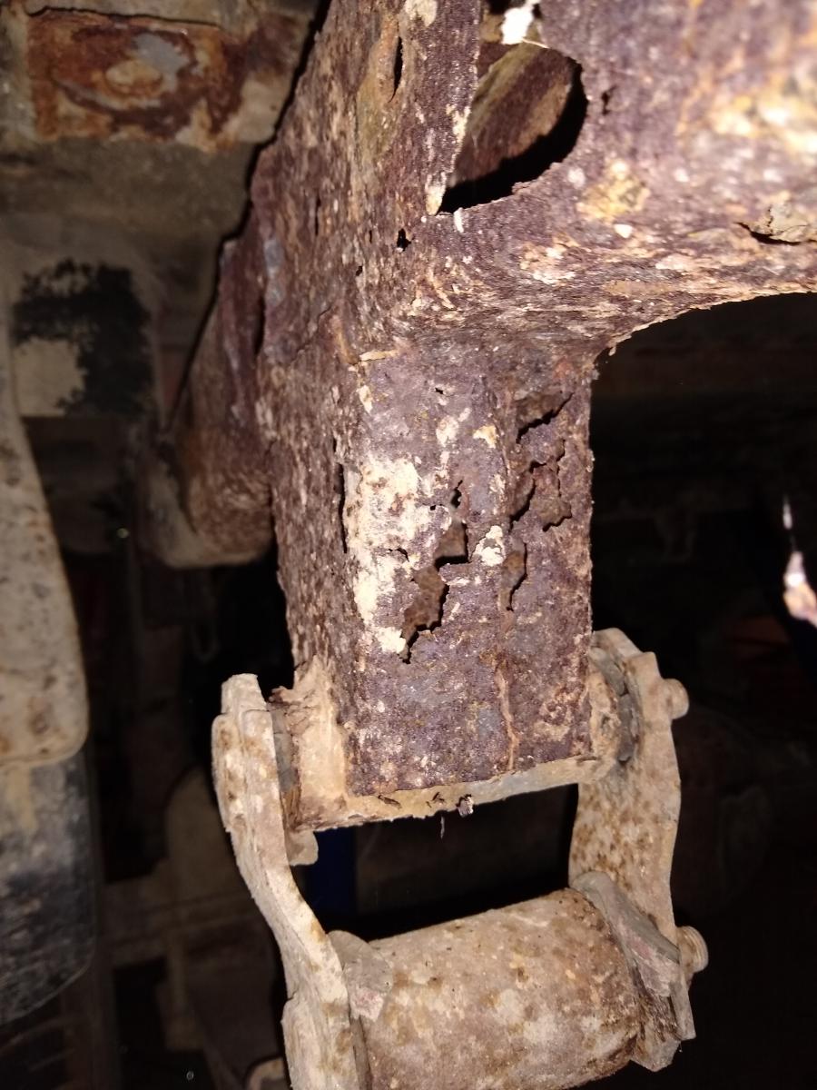

    I took yet another good look at the underside of the truck, with a decent light.
    The rust in front of the mud flaps is only really surface rust, but from there back is full on Titanic.
    It looks like that entire section is mostly straight though, and the rust isn't as widespread as I originally thought. I can just replace those sections with rectangular tube on both sides and build new spring perches.
    I'm feeling better about the rust situation, which is funny considering those two pictures... Lol

    Looks pretty nasty
    You could get a bit of extra lift when you remake those shackle mounts
