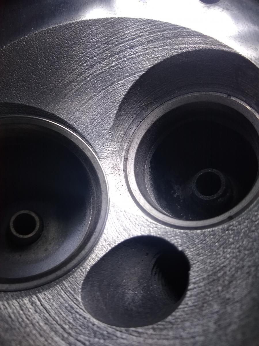

    In other news, I found a problem...
    It's not the greatest picture, but that's a crack between the valve seats, and all of the work I've done to this head is all for naught.
    I'm thinking I'll order a new one from Engine Machine Services, they have the best price I've found so far.
  7. #382
    Oh damn. Kind of a sore point but this is the reason why I get my heads pressure tested. Not worth putting through a shop to get welded up?
  8. #383
    01-08-2019
    291
    Frederick, MD
    With everything that I would want to have the shop fix, it's cheaper to just get a new head...

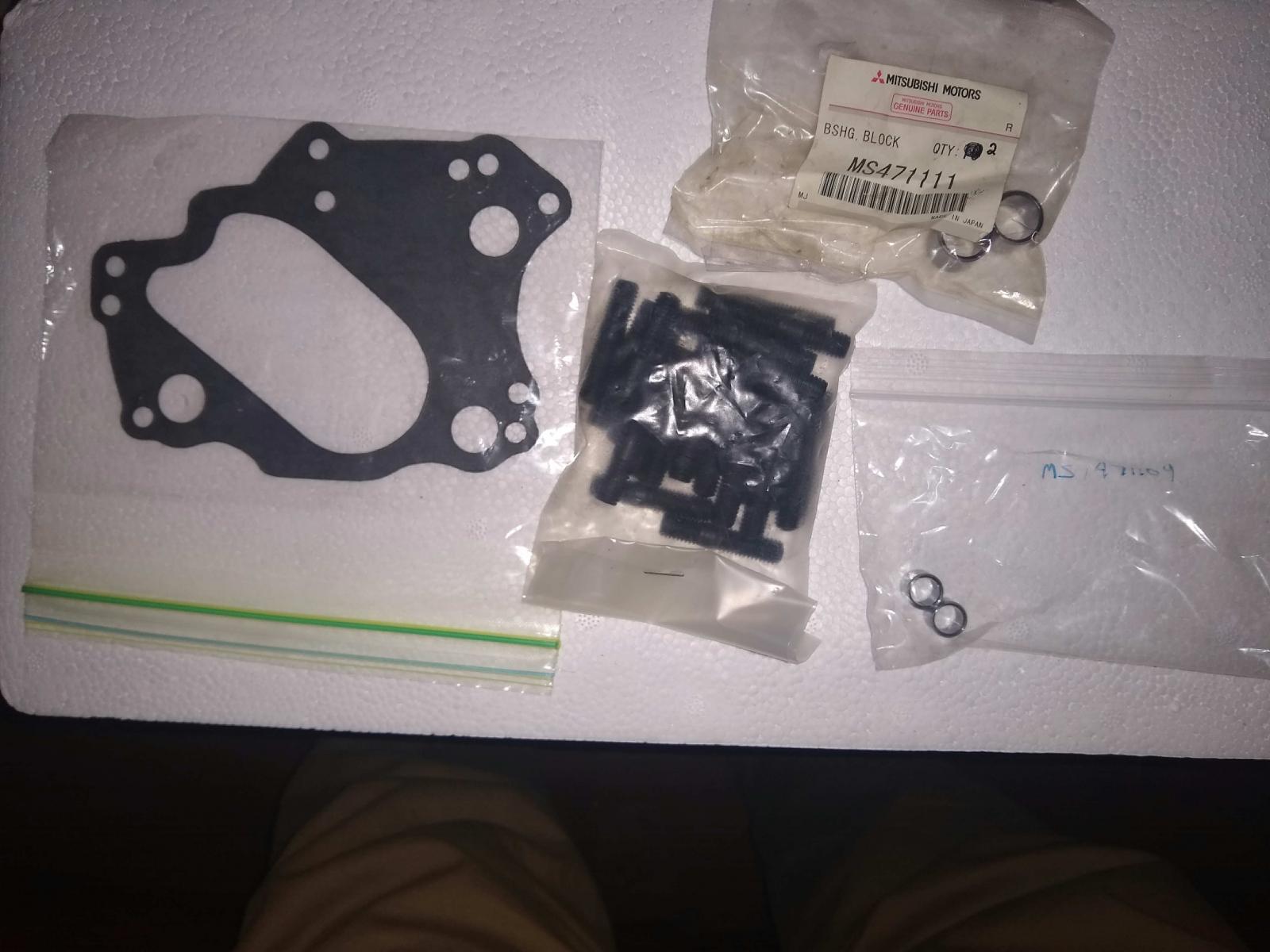

    Slow still, dealing with a lot of stuff lately and haven't had much time to do anything with the truck, but I did get the new head.
    I'm legitimately excited about this.
    I took it out of the plastic just long enough to get a good look at everything, and then it went right back into the plastic bag.
    And the extra goodies I got:
    A new "free" oil pump gasket, because he has a pile of extras that he's never going to use... And I had to pull the oil pump back off so I needed a new gasket
    A set of dowel pins for the gear cover and a set for the head, because I was missing one of each and they were cheap.
    And finally all new studs for the head, which is nice because I totally destroyed a few studs removing them from the old head.
    I was kinda hoping for a bit of swag, maybe some stickers/decals or a can coozie or something... But I'm still completely satisfied with everything.
    I'm kinda wishing I had added the nuts and washers for the intake and exhaust to my order, but I can get suitable replacements at any local hardware store.

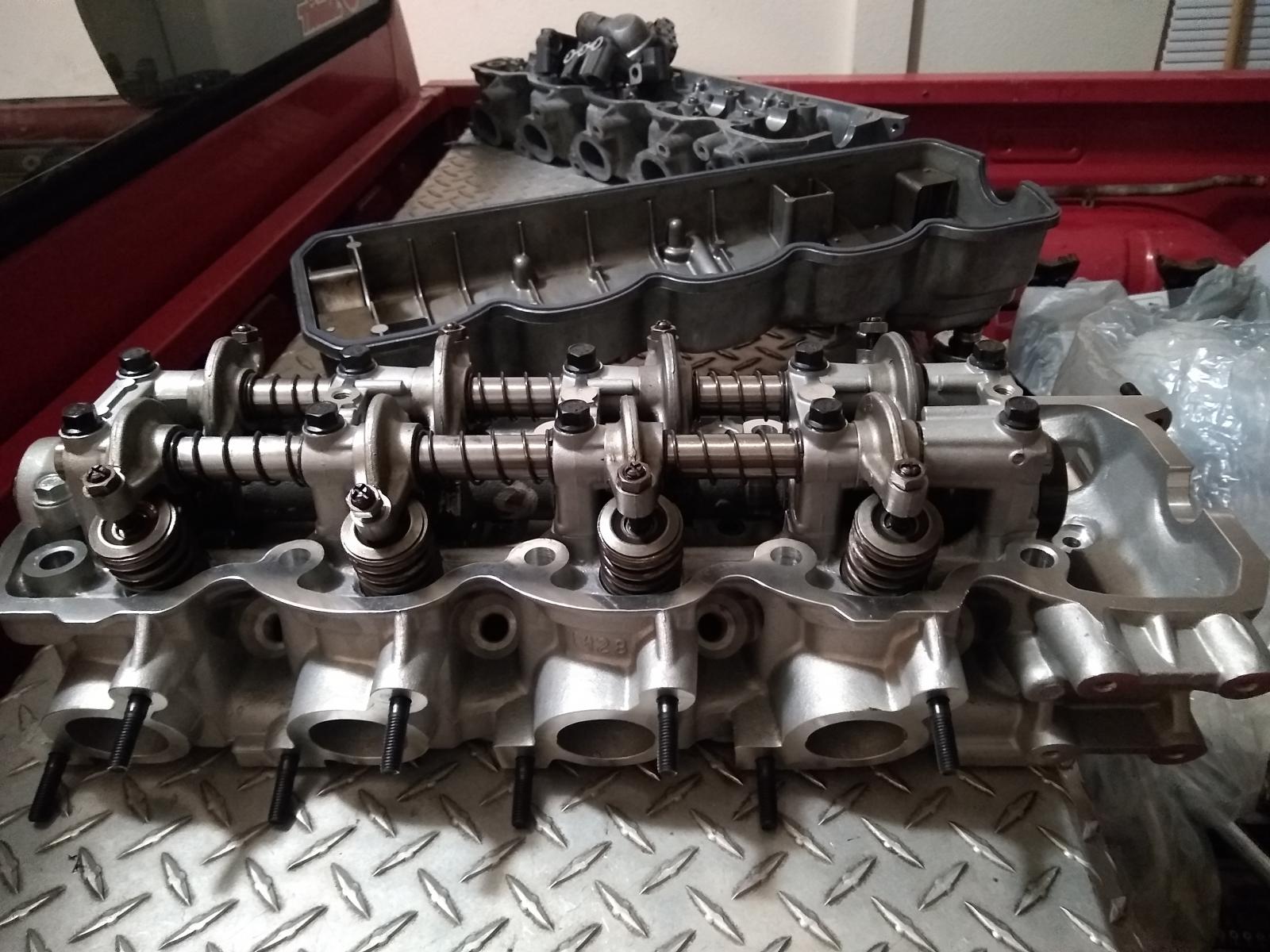

    Got the head assembled
    Tomorrow I'm going to work on installing the timing stuff, hopefully I'll have the engine fully assembled by the end of the day.
