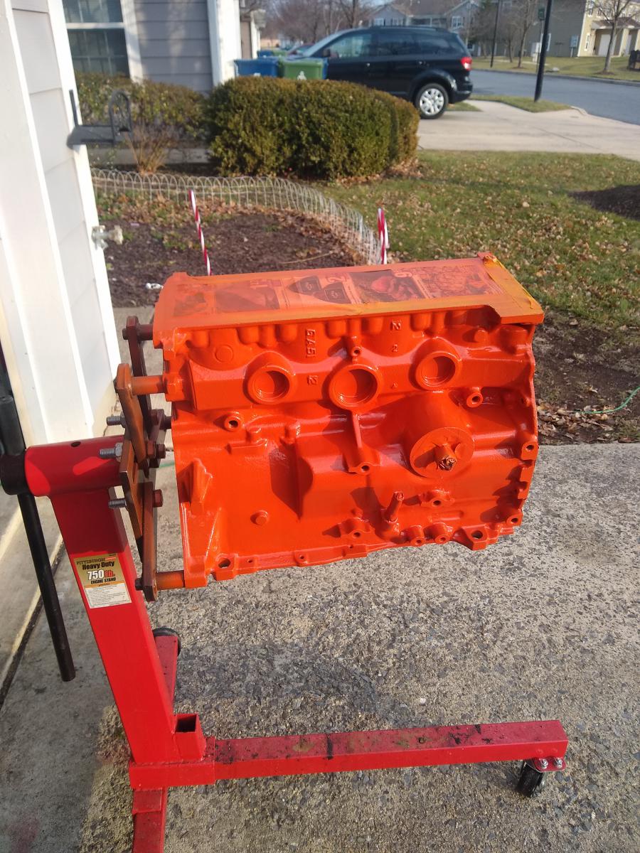

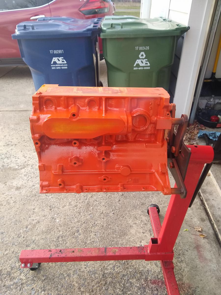

    Quick update:
    Block is painted Chrysler Hemi Orange.
    Almost ready to assemble the short block, still have quite a bit left to clean before I can get the entire engine back together.
    Progress is painfully slow, but it is still progress.
  8. #333
    The hemi orange is out of control! There is nothing like a freshly painted block to raise an engine bay a level or 2. Nice

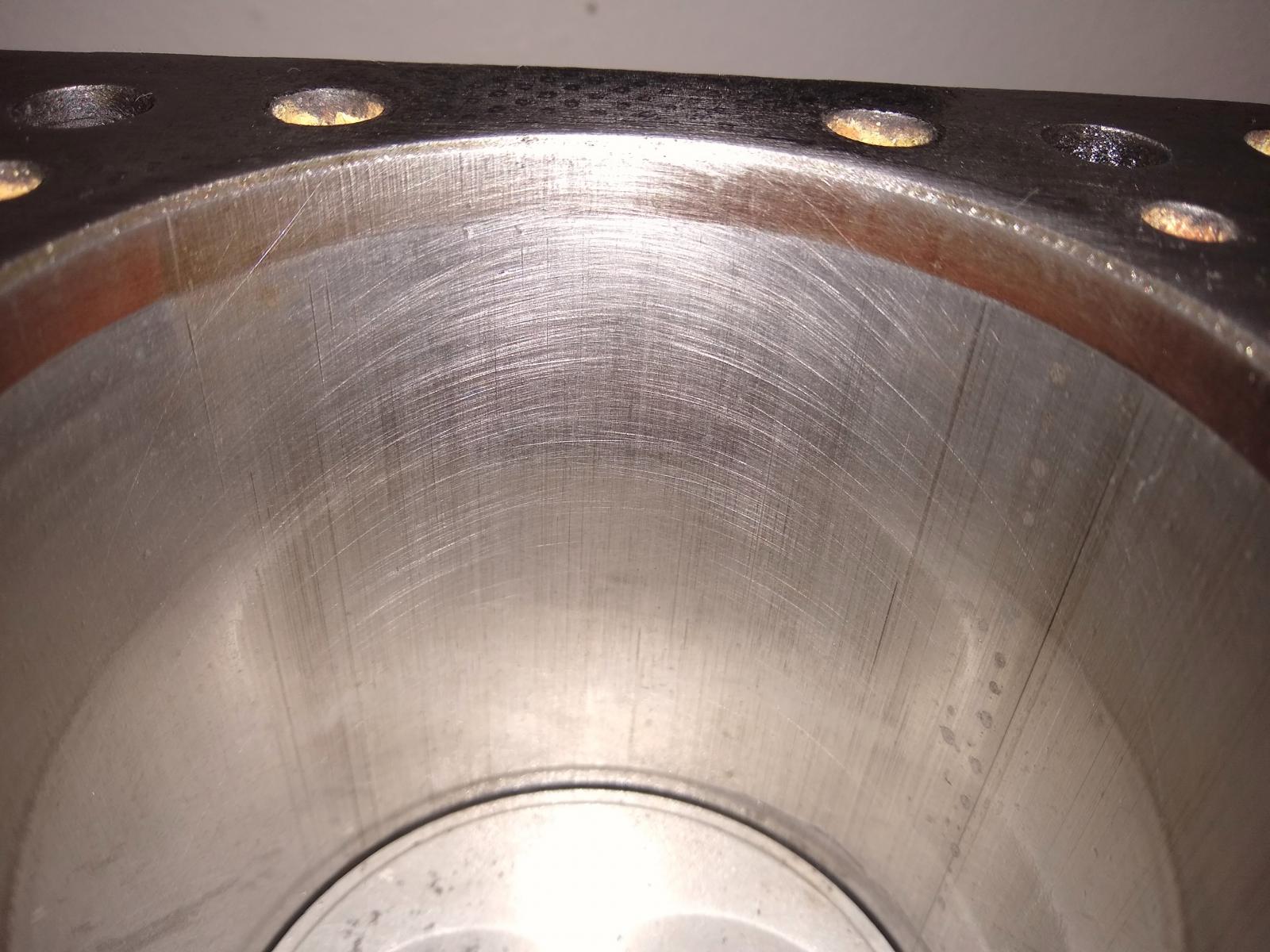

    Made some decent progress...
    I de-glazed the cylinder walls with a homemade tool, basically a stack of ScotchBrite pads, a few washers, and some all-thread.
    I measured all of the clearances, they're all either within spec or close enough. I would list all of the individual measurements, but I don't remember them exactly. I did at least write down the min/max of the measurements that I took, which are as follows:
    Main bearing oil clearances are all between 0.001" and 0.002", rod bearing oil clearances are all between 0.0015" and 0.0025". Service limit is 0.004" oil clearance for the main and rod bearings.
    Piston ring end gaps are between 0.016" and 0.019" for the top compression rings, 0.012" and 0.016" for the second rings, and 0.014" and 0.016" for the oil rings.
    Service limit is 0.031" end gap for the top and second ring, 0.039" for the oil ring.
    I slammed the pistons back in last night for the final assembly, after letting them soak in some SAE 40 oil for a few hours, and I officially have a (mostly) assembled short block.

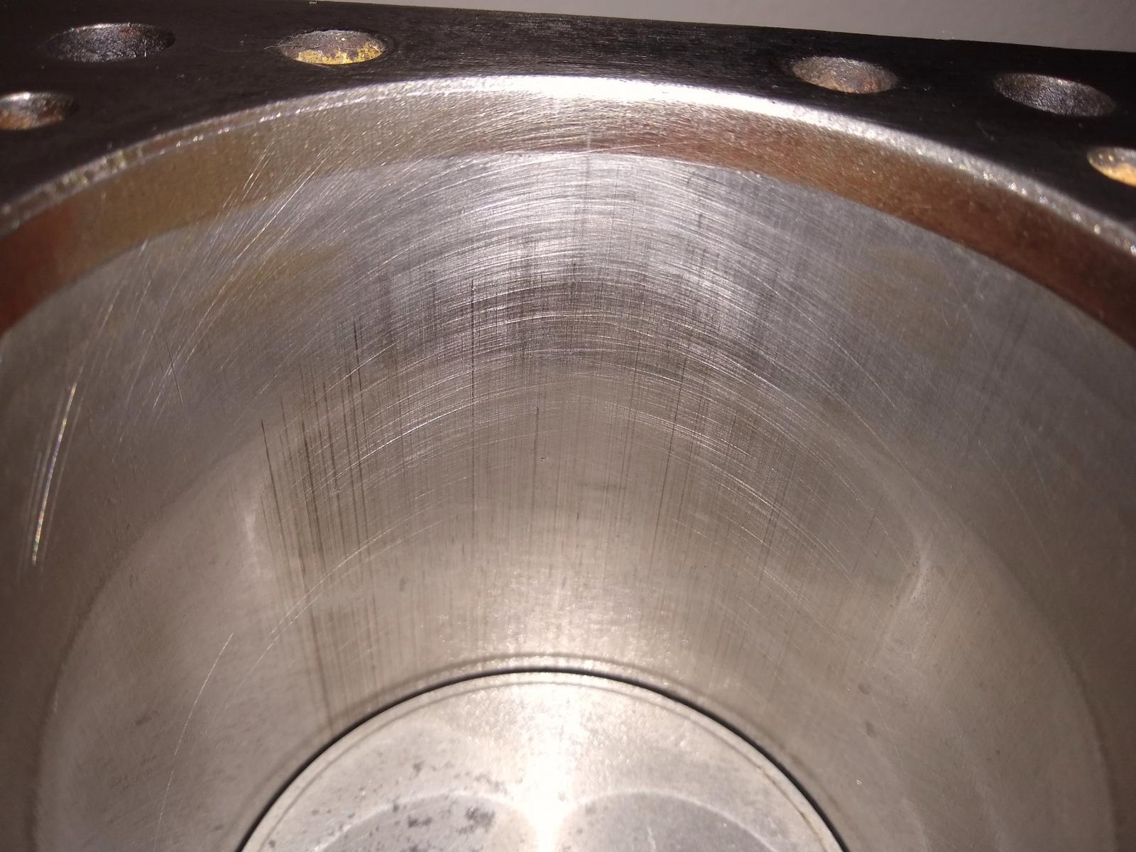

    I've had nothing to do but think about it while at work these past few days, and I'm not happy with the cylinder walls.
    I just want to get rid of the wear marks and get a proper crosshatch pattern.
    The ScotchBrite barely touched the buildup at the top of the cylinder... I'm gonna need an actual cylinder hone.

    How many passes did you make? I used the same technique with a little fresh engine oil just to prevent it from ripping into the cylinder walls and, although my bores weren't vertically scored like yours are, I managed to completely de-glaze the surface (might need to use a coarser finished pad... I tried with the spring loaded stone tool and I was scared that it was too aggressive so I gave this method a shot) If you are going to hone it you may be going beyond the tolerancing for 'stock' pistons and rings. I think the rule is that if your thumb nail can catch on the score marks, it's time to rebore the cylinders.
  13. #338
    01-08-2019
    291
    Frederick, MD
    I went at the cylinders for a solid 30 seconds each, but I'm gonna say it's because the "tool" I made just doesn't have enough material to put enough pressure against the cylinder walls. I could probably buy more ScotchBrite pads and make it thick enough to do the job, but it would end up costing more than just getting one of those spring loaded cylinder hones.
    According to the factory specs, the piston-to-bore clearance in a brand new G54B should be 0.0009", and the limit is 0.0008" to 0.0016". Right now I've got a piston-to-bore clearance of 0.0008" to 0.001".
    So as long as I'm particularly careful with the hone, I should be able to get a good crosshatch pattern and get rid of all of the score marks without going too far past the clearance limit. Considering the nature of this rebuild, I would still feel comfortable if I ended up at 0.002" piston-to-bore clearance. It might not be optimal, but it will run and right now that's all I'm going for.
