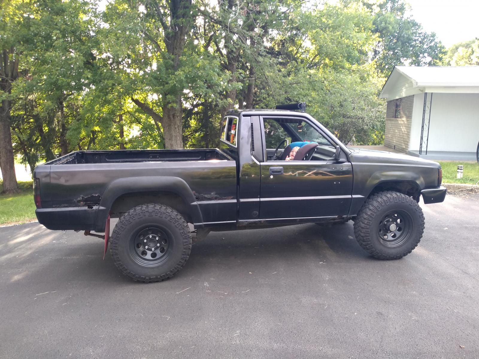

    I have 31 inch tires on my mighty. I had to put wheel spacers on for the rubbing. It rides like a boat
    Could you tell me what backspacing you are running to get those 31s to fit please.
