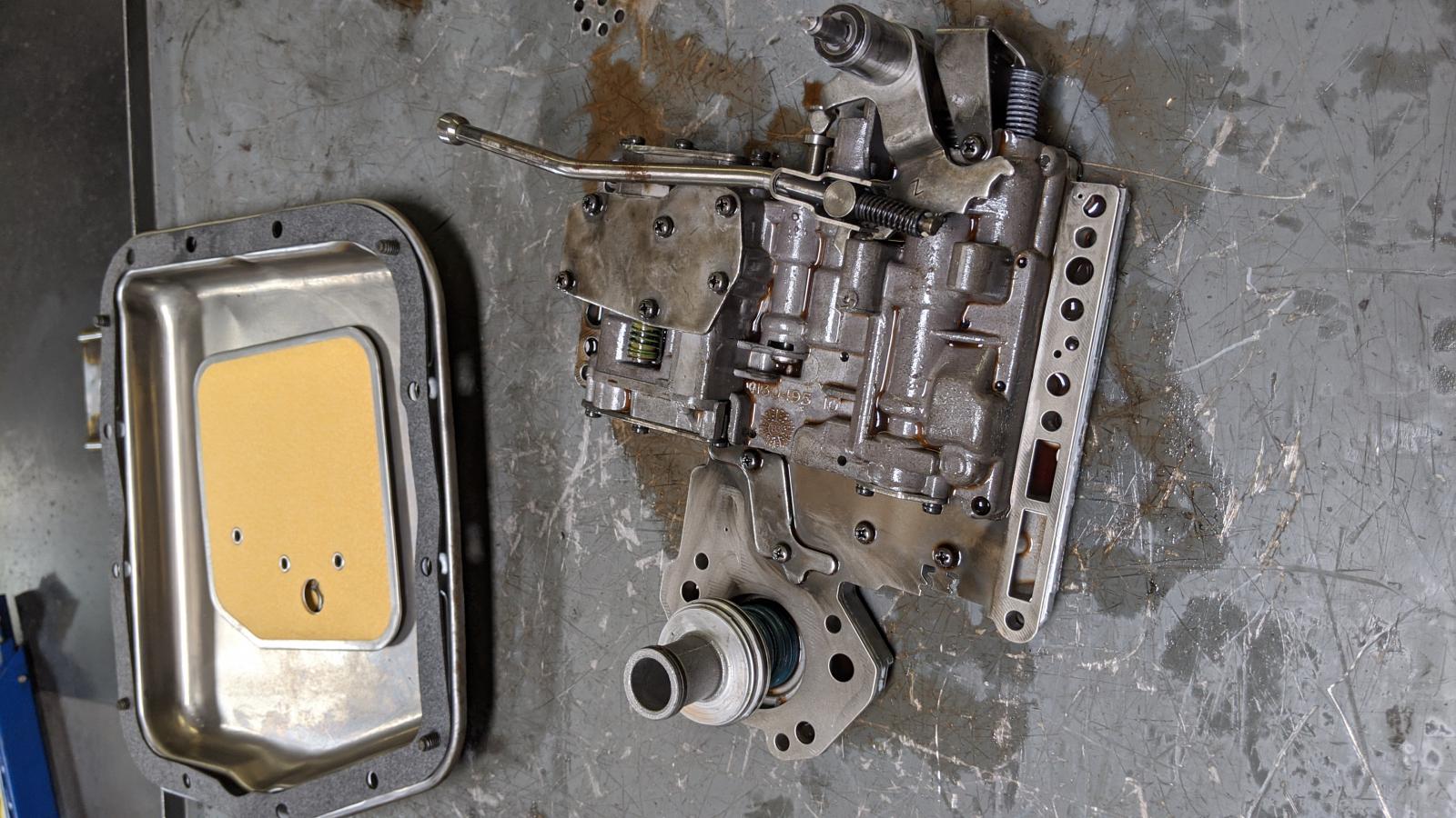

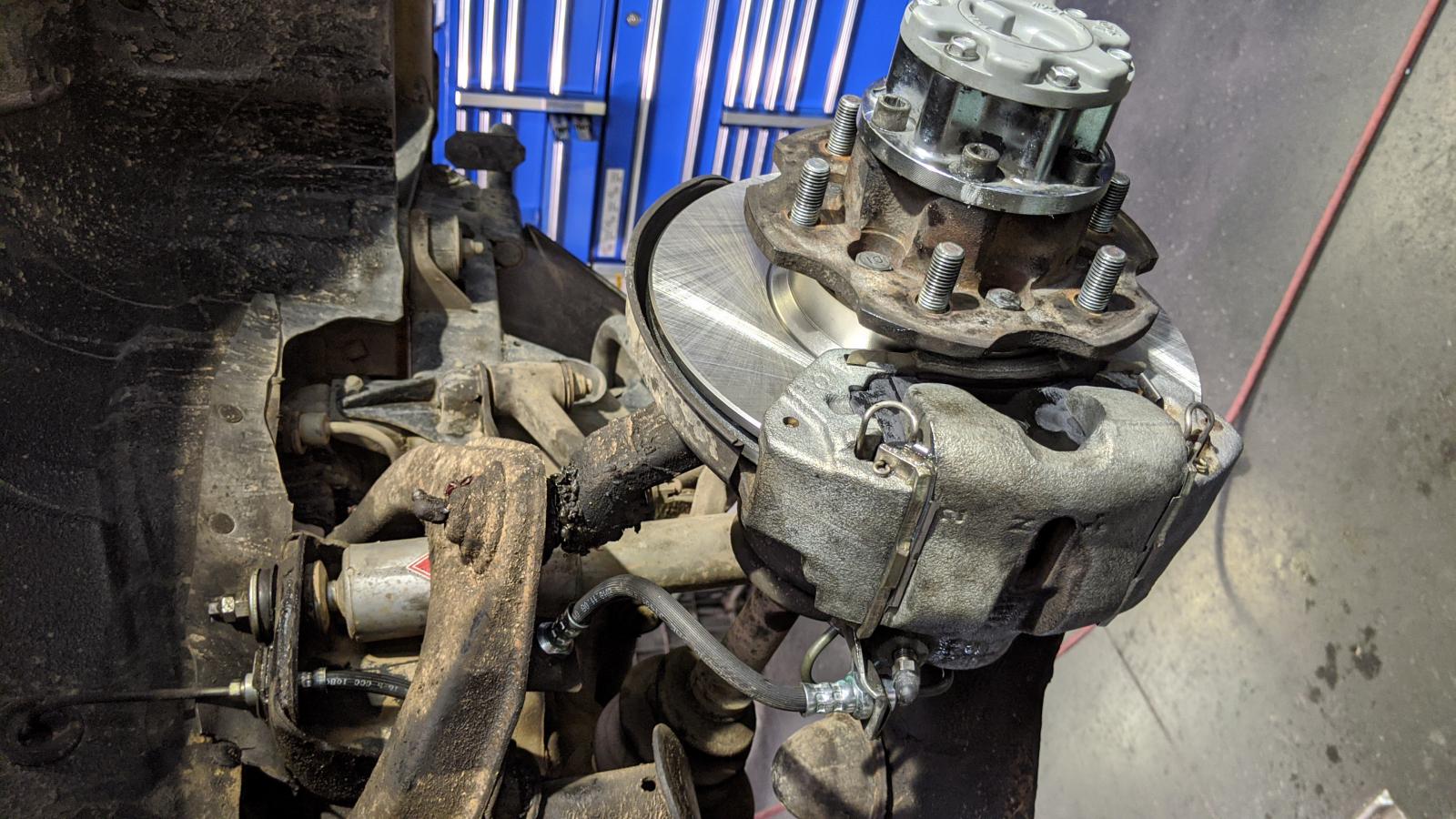

With all the extra time I've had on my hands I have taken the time to go through a few more things on the Montero. Front brakes and transmission leaks.
monterotrans3.jpgShifter Shaft seal, Accumulator seals, Pan gasket, Filter, and fluid changed
monterobrakes2.jpgmonterobrakes.jpgCalipers cleaned and reseals, new brake hoses, rotors, pads, and brake fluid.
