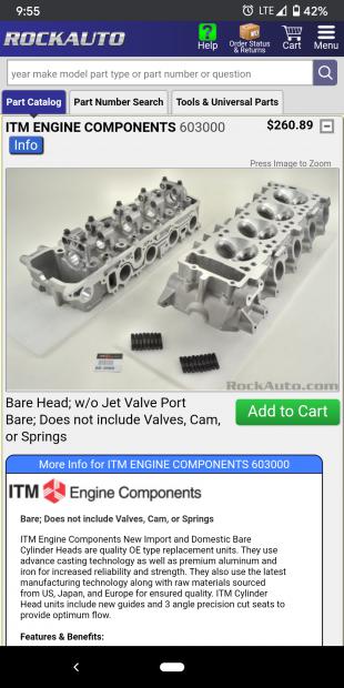

    Would you go with this? newhead.jpg Will my hydraulic lifter work on with this head?

    That head will work and the cost is reasonable although be sure to factor in shipping costs. Since it’s a bare head you will need to use the cam and valve train (rockers, lifters, rails, valves, etc.) from your old head, but don’t use the old cam towers. Use the new ones that come with the bare head. Also not a bad idea to get at least new exhaust valves. If you don’t have the tools to set up the new head, check with a machine shop. It’s a very straight forward procedure to move the valve train to the new head.
    Another option is to get a new head that includes a cam and valve train. May cost 100-150 more, but that extra might be what you pay a machine shop to set up the bare head.
    Whichever way you go, be sure to get a good quality head gasket and new head bolts. Do not use the old bolts. If you can afford the extra cost, get ARP head studs. They’re bullet proof and reusable.

    Awesome thanks for the input. I've already got a head gasket set and head bolts. I also have all the tools to setup the new head. Shipped and tax I'm looking at $282 which like you said isn't bad. I like your idea of new exhaust valves. May main concern was that all the non jet heads I found had manual lash adjusters and I wasn't sure if that would work with my hydraulic lifters.

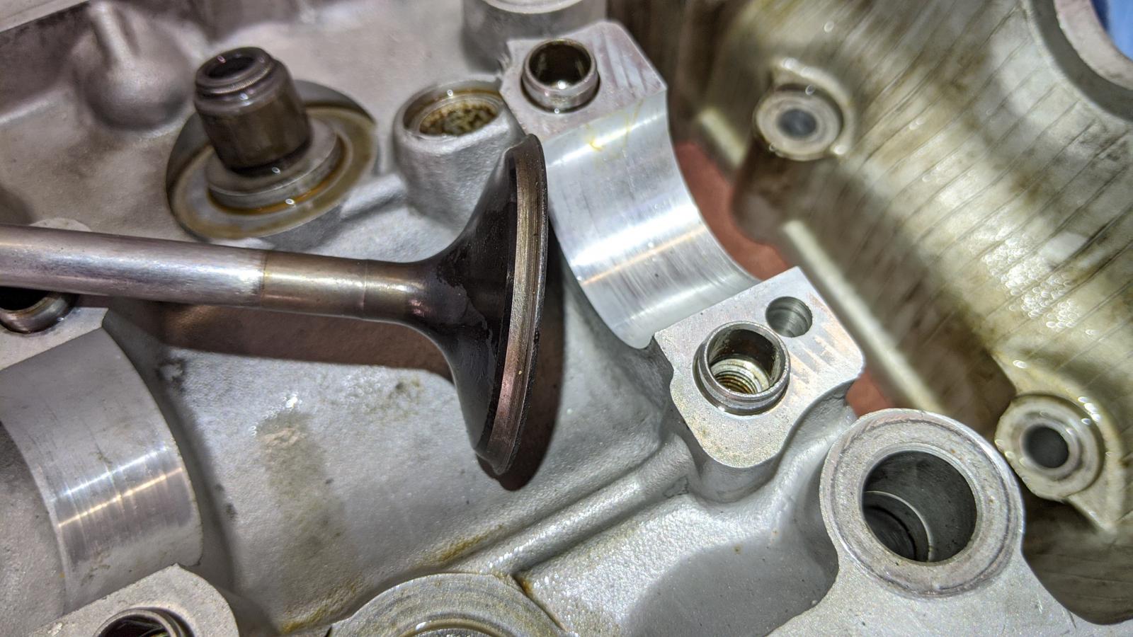

    The valve stem lengths differ for the two head types so that’s why the two rocker assemblies aren’t interchangeable. Also, if you’re contemplating reusing the intake valves, carefully inspect the seating surface, the stem and rocker head for wear. If you have any doubt, replace them too. Otherwise it looks like you’re set. Have fun.
    Complete set of valves ordered. Of course I was hoping to reuse them but the intakes have a significant amount of wear on the seating surface.

    Yikes! That valve is incredibly worn. The main seating surface is so dished, I'm not sure there's enough there for a machine shop to re-cut the seating surfaces if you tried to go that route. The stem is showing its age, too. Replacement was definitely the smart move.

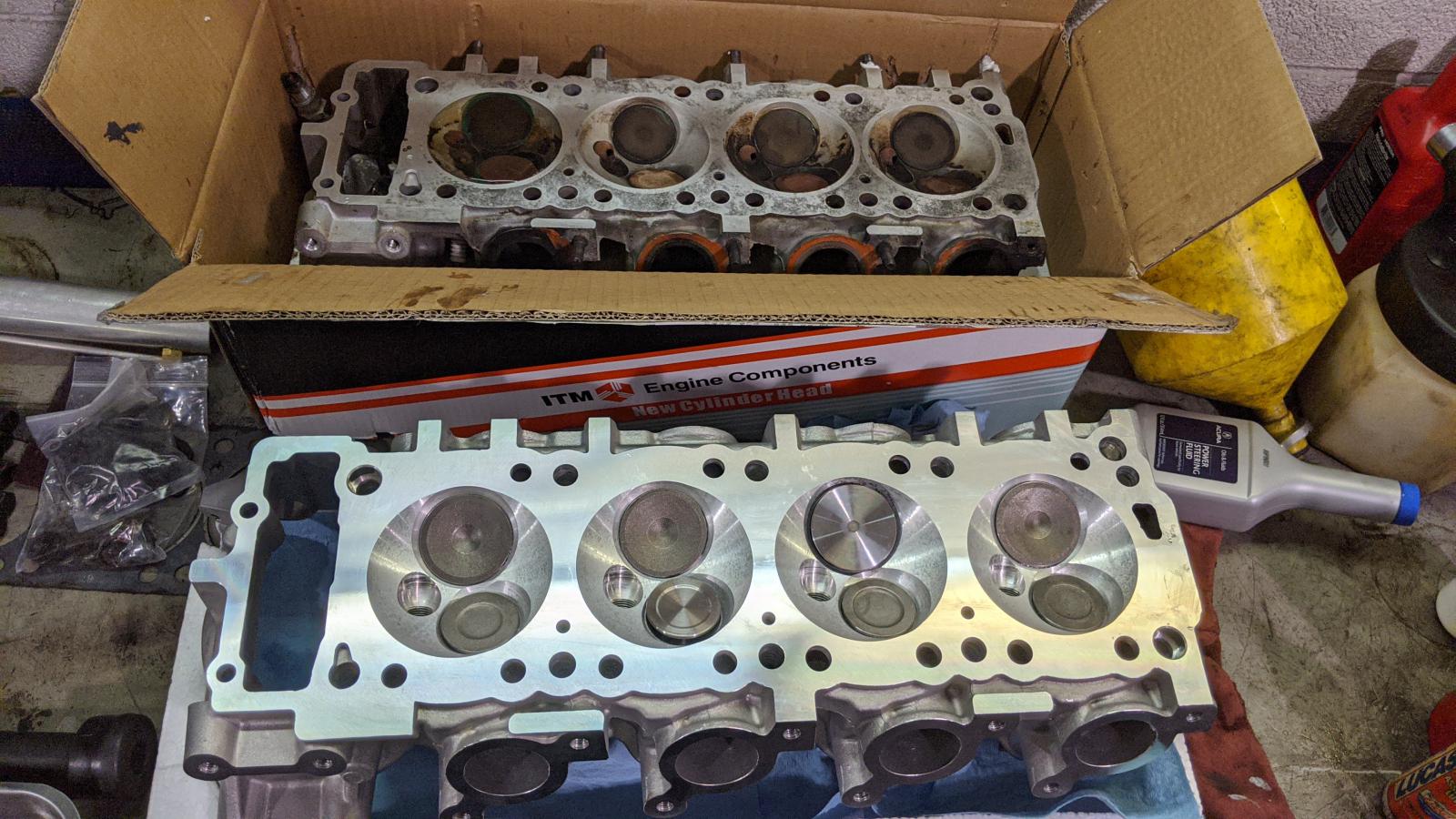

    Head and valves came in so I took some time between jobs to lap in the valves and assemble the head. I did do a non-scientific measuring of the combustion chamber and my conclusion is that the old head has slightly more volume. So maybe I'll get the slightest bump up in compression ratio. IMG_20200114_173849.jpgIMG_20200114_174001.jpg
    I'm shooting to have it back together by Friday.
