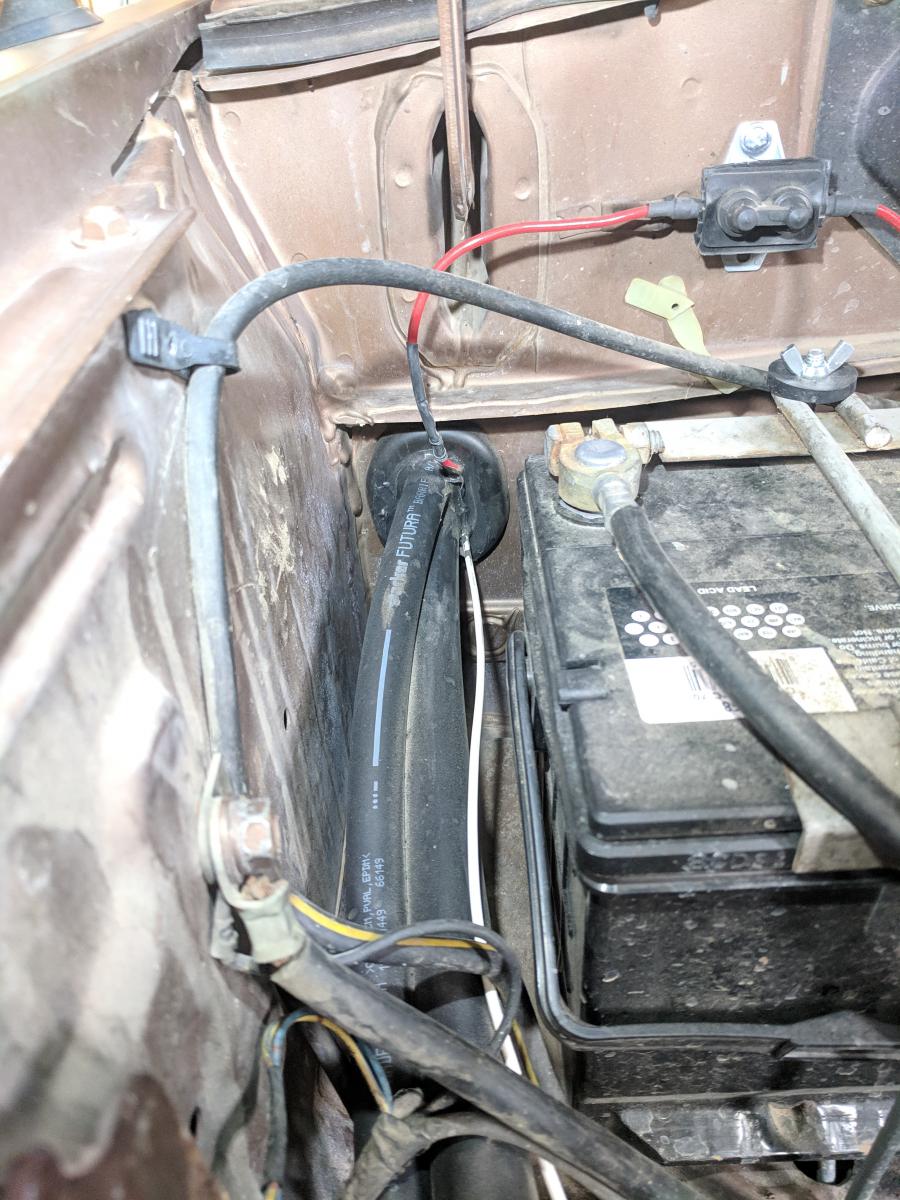

ac dryer.jpgac firewall.jpgac lines.jpgPushed the lines through the old grommet where the wiring for the computer once was. It was perfect because I didn't want to drill holes. Blocked off Fresh air opening since there isn't an easy way to utilize it with this unit. plus I still have the outer vents for fresh air.
