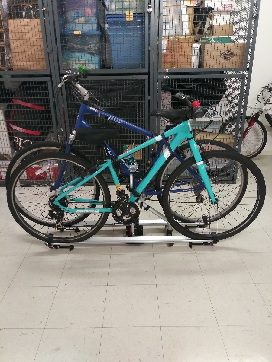

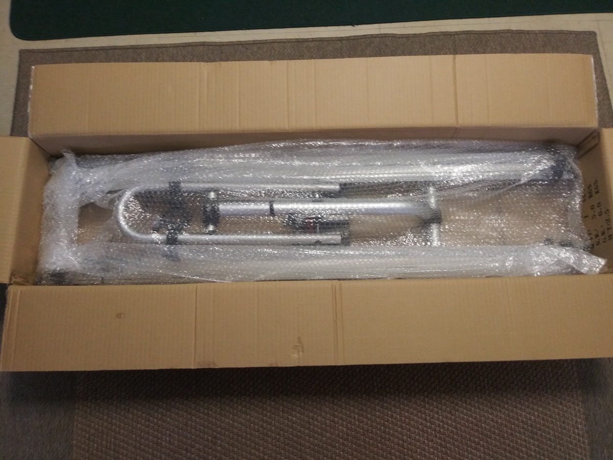

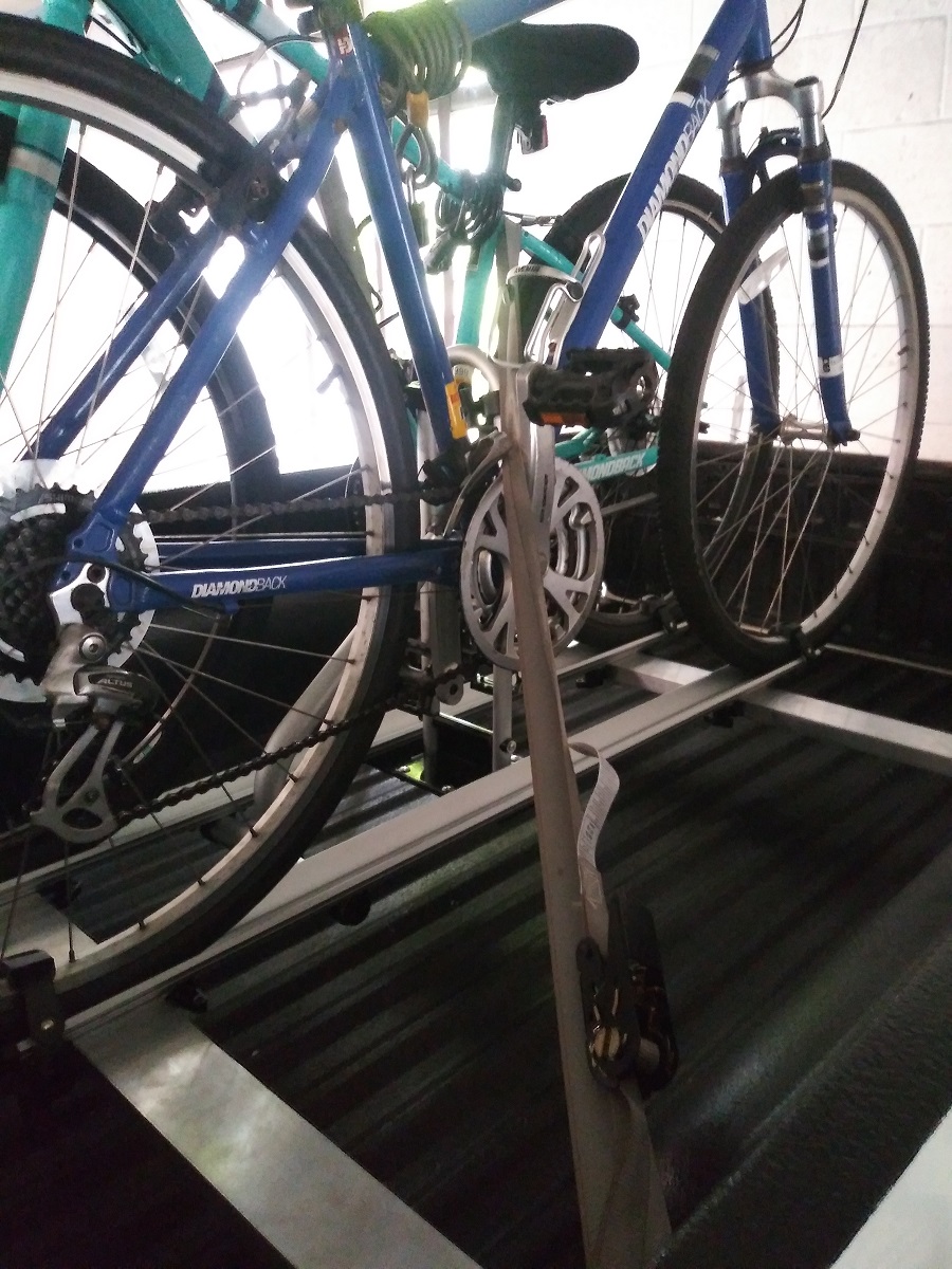

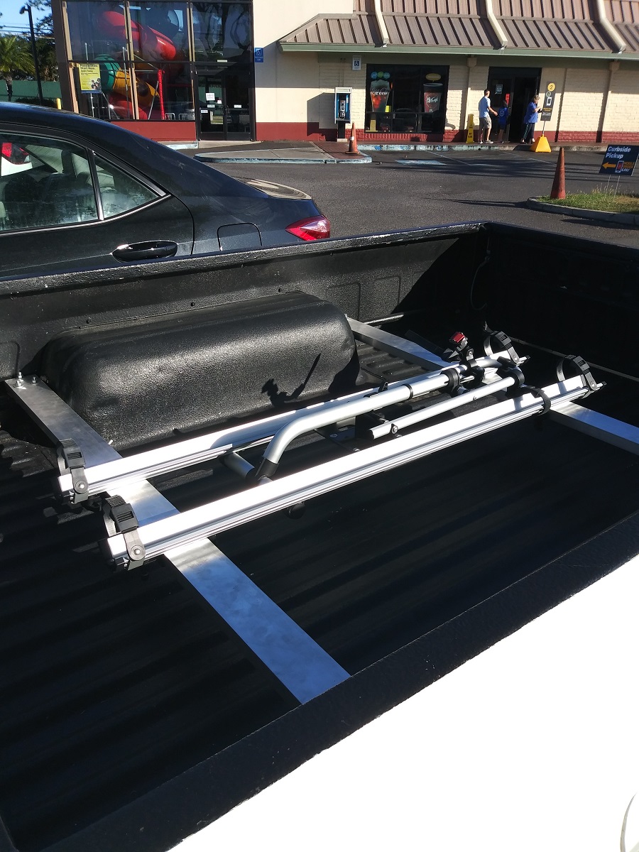

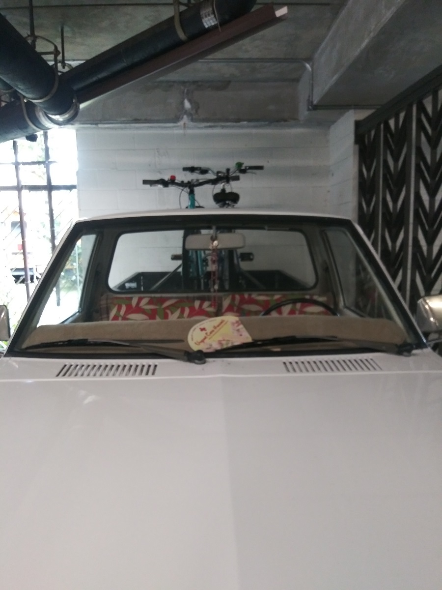

    20190119_165057.jpgGood Bike Rack: Well, after much research & tinkering, my truck is now a toy hauler... The dark blue bike is a 29er, it's tire has an inch or more clearance from the bed front... The two tie down straps are insurance and stop all movement of the bikes... The bikes clear the low overhead garage limits with three inches to spare... A link to the rack I bought from Amazon & photos follow...

    20190119_165057.jpgGood Bike Rack: Well, after much research & tinkering, my truck is now a toy hauler... The dark blue bike is a 29er, it's tire has an inch or more clearance.....etc

    Slick! Do they come out easy if you want to haul something large?
    1,557
    Good question Giovanni89; Yes & No..!
    The bike rack itself has quick release plastic knob wing nuts; easy enough to remove it quick from the truck...
    The ends of the two DIY (cross pieces) 1" x 3" x 59 3/4" x 1/8" thick rectangle aluminum mounts are secured with three 5/16"-18 x 1 3/4" long bolts... Two of these bolts could be made quick release with a plastic knob wing nut but the third (outboard bolt) might not, it is close to the bed sheet metal... I put the outboard nut on the bottom to make assembly easier; the other two bolts have the nut on top... Perhaps the four outboard fastener assemblies could be made quick release by using a metal wing nut (if small enough..?) The only tools needed to remove the two cross mounts (twelve fastener assemblies) is a 3/8" drive ratchet with 1/2" deep well socket & one 1/2" combination wrench... I should upload some pics...
