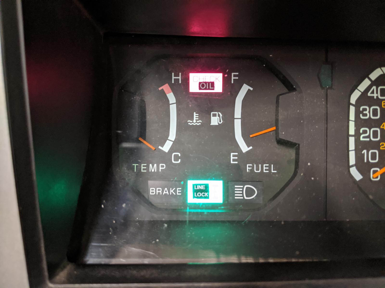

Original brake lines, only thing I added was one short section of steel line to the line lock and everything is uncut and oem.

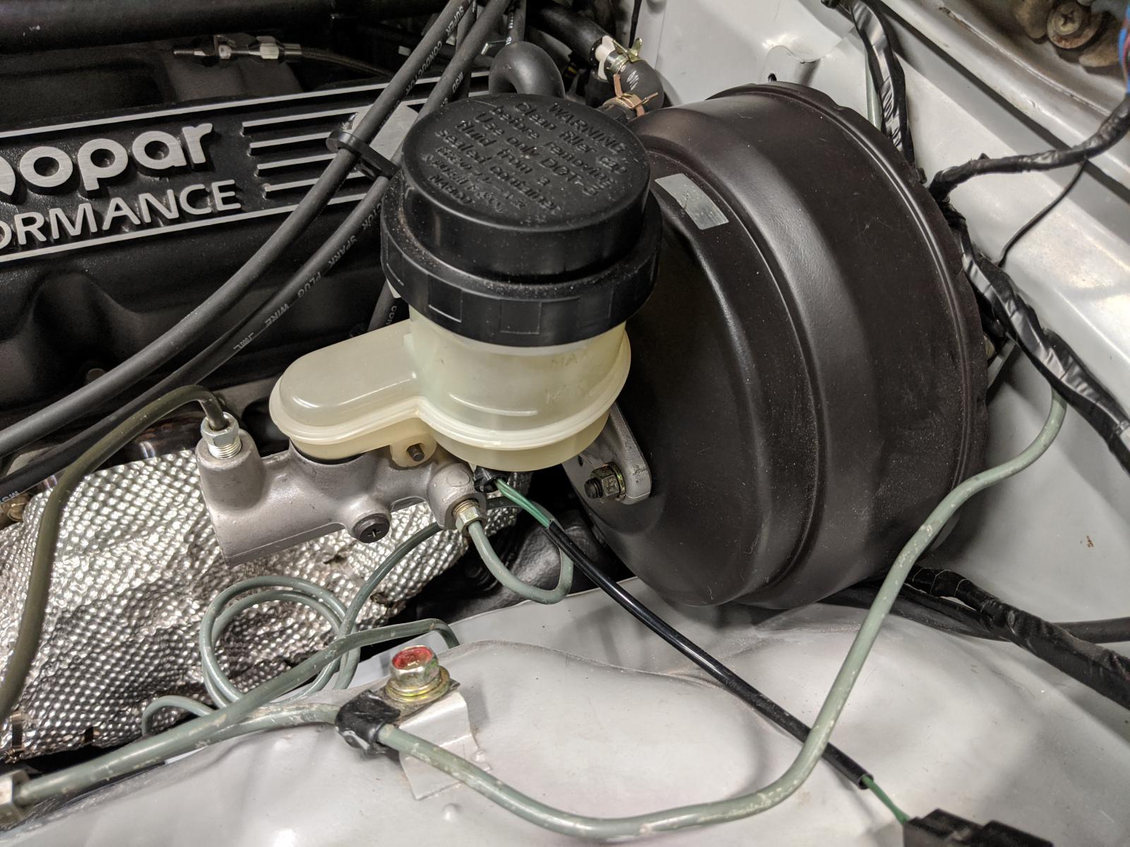

To mount the Stealth's brake booster I had to drill two holes in the firewall for the lower studs. Used the Stealth's aluminum spacer between the booster and firewall and the brake pedal line up perfectly.
