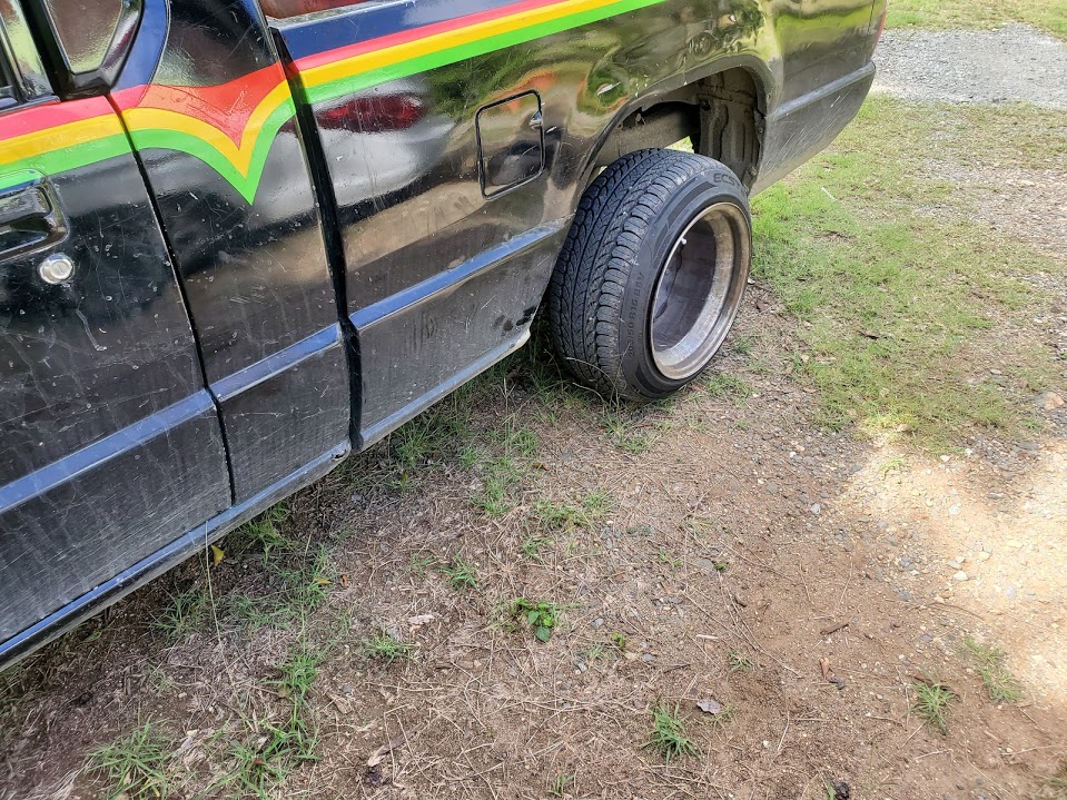

    Haven't done my engine swap yet but I've been working on engine wiring which is about done so far and gonna start messing trans stuff soon. So far I've done my flatbed swap, bamboo headliner, and made my customs wheels I've been wanting to do for awhile.

    Oh damn, I just checked out your location. It doesn't get much more remote than that. I'd imagine if anything major went wrong or you were desperate for a part it would be a nightmare. What has it been like getting aftermarket parts like the headlights for it?
    12-31-2018
    13
    Christiansted, Virgin Islands
    Getting small stuff, like the headlights, isn't a problem as long as the person I'm buying from ships using the post office. Fedex and UPS charge us as if we're international. Big items I have to ship to a freight forwarder in Florida. Post office doesn't take long at all. Just ordered my throttle bodies for my V6 and got them in 3 days.
