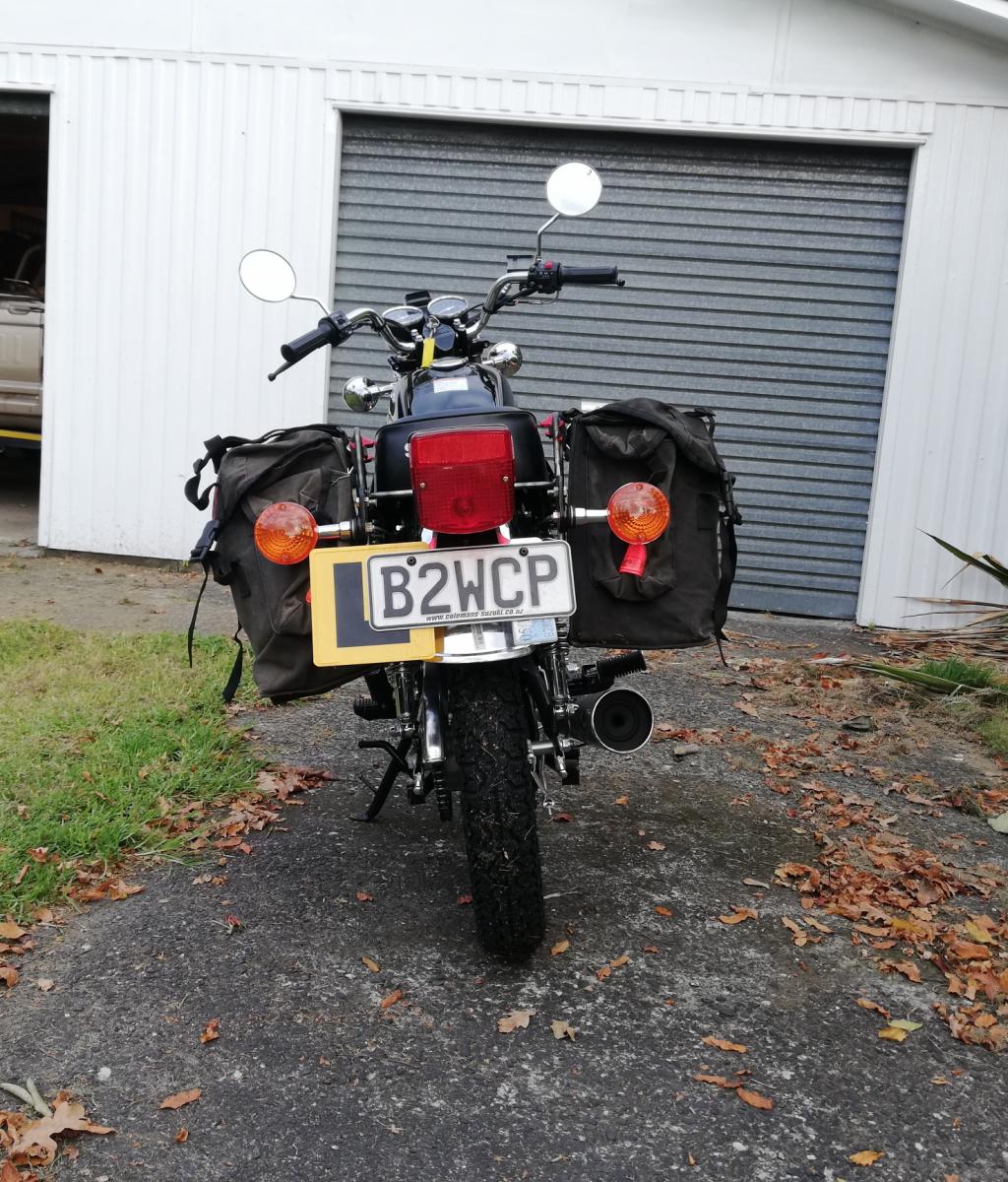

    A few mods make it that little bit better, I built a pannier rack for some canvas bicycle bags and put on some fork gaiters and a headlamp guard to save premature wear from road grit, and will look the part on some camping adventures (I want to embarrass the boys on their 1200 BMW adventure bikes) also have an led light bar to go on and a screen. Rack cost me $8 in steel and all the bits I bought came in under $40 so it's cheap fun. Currently costs $0.05 per km to run, can't take the train for that!

    So some final finishing mods
    A sheepskin pram liner with the head piece removed fits quite well.
    A 12v socket this side and I will fit a dual USB with volt meter on the other. Ign switched relay circuit from the battery with an on off switch mounted behind the battery cover as well.
    I think that's all I will do to this bike, other than some fiddling to set up the suspension just right. I think I can fit two 1.5L fuel bottles in the rear pocket of my panniers, and that would be an additional 100km/60miles I could go, I already have a ultra small tent that will go well on this (my wife and I can juuusssst squeeze in together, but have been thinking of a tarp to sling over the bike as additional cover.
    I don't think I will need a bash plate (maybe as the bike gets older I will abuse it further...) The exhaust could be adjusted a little.
    Maybe a bolt on plate to increase the foot of the side stand would be useful.
