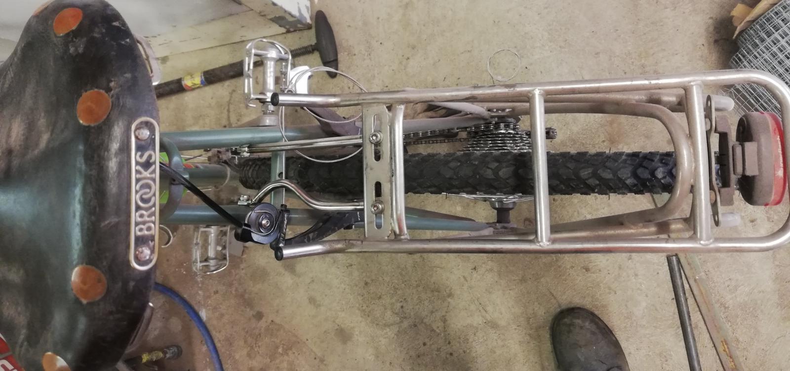

My touring bike is all hand brazed. It's done a lot of hard miles. I did some work on it the last few days
I have some pretty nice stainless steel racks on it, 30 year guarantee outta Germany. But the stays are aluminium and I snapped one of the eyelets, it hot bent around a bit in my travels. I don't like the one size fits all set up, so I made my own
Stainless steel capillary tube and flat stock. Part of making new ones was that I switched my brake set up to V brakes and I now use two sets of brake levers on the bars, so I have to use a ratio corrector at the brake end.
The kink is to clear that
Came out very nice. I used sil flow 55% silver brazing rod
