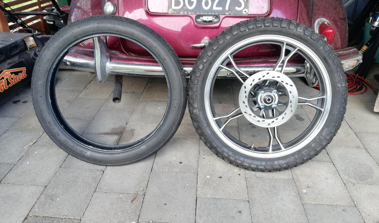

I hear they are not so great on the highway. But considering its a 50/50 tyre and the front tyre that came with the bike is cheaper than the ones on my bicycle, I think it should still be a massive improvement.
