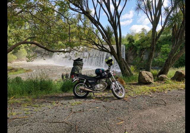

    1,222

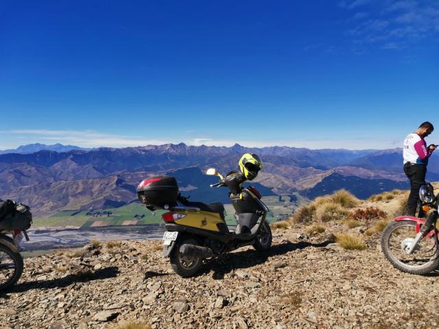

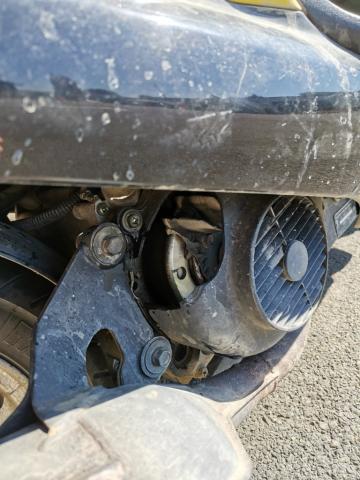

    125cc suzuki twist and go i bought a while ago with no compression and no oil in it. piston, rings and a dingleball hone and i took it on a 10 day trip down to the top of the south island, and all over the 4wd tracks that adventure bikers tell me are so hard. Twist and go just twist and went, totally stock apart from a more knobbly front tyre (nothing would fit on the rear so thats just a road tyre), a 12v usb port, and a front rack for extra fuel
    went really well, amazed, it only has 12cm of ground clearance and it was never an issue
    had a couple of issues

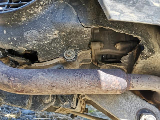

    the fan exploded for some reason. i was only just cruising along when it happend, so must have been damaged, or just old i guess. made some roadisde repairs and continued on with a vibrating bike.
    eventually the seal on that side started leaking, probably the bearings are fine. But i bought another parts bike incase it makes bad sounds now. the baffles in the exhaust all came loose, and both the petcock and the press in float needle valve started leaking, so i swapped the carb and got a new petcock
    now to sell - one lady owner, never thrashed

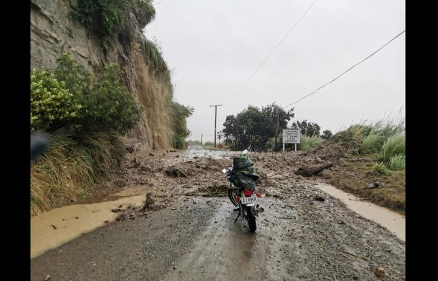

    Went on a small bike ride during a weather event

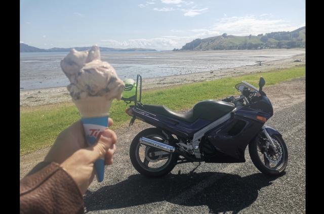

    Purple bike is a 1992 kawasaki zzr250, cheap because the guy couldn't get it running right. Turns out he replaced the carb manifold rubbers. Which is good, but it turns out the reproduction ones are a slightly different diameter and if you use the original clamps they bottom out just before getting tight enough to seal. So it always had a vacuum leak issue. I then had to reject as he had put bigger jets in to compensate. Goes great now. I actually bought a second one, also for cheap cos not running, that one was a pinched wire under the handlebar causing the main fuse to blow. Going to paint that one bright green as a kawasaki should be.

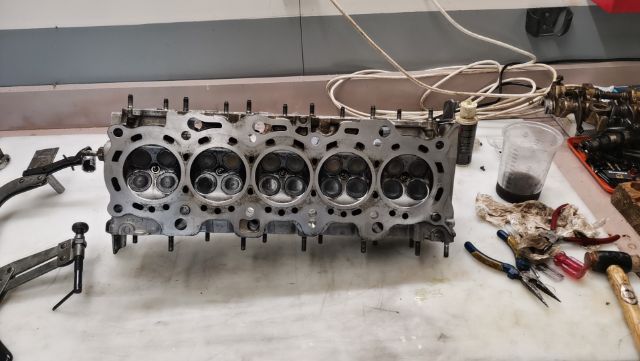

    This turned into a bit of a - well, while I'm in there
    Top points if you can guess what it's from
    I actually had an oops changing a $2 oring on the distributor. It has an offset drive so it can only go in one way........ Except it can go in the wrong way and then flexes the rear of the head and camshaft in an impressive way. Juuusssst bent the last exhaust valve enough that it would stick when warmed up. Oh well, got everything on clearance so that's cool, timing belt is due and got that for $12

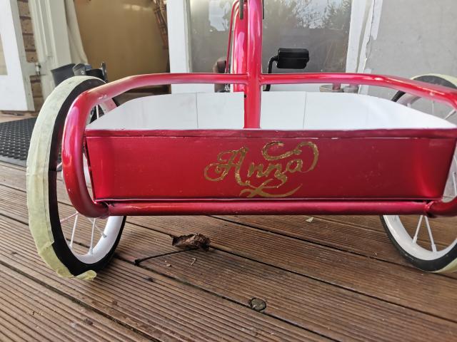

    Who painted the trike bike ~ it's pretty now !!
  14. #189
    1,222
    Nope, not audi either.
    I painted it. Candy apple red over silver flake and the white is snowflake pearl. The lettering is gold leaf too

    hmm, doesn't look diesel or volvo,
    Ahhhhh... Acura vigor 2.5 tl.
  17. #192
    1,222
    Awesome painting Dude !
    The cylinder head is from a Scotch Yoke Engine ?
    You have the same youtube recommended as me
    Very close. It's a Honda ascot, with the 2L instead
    I just noticed that the last cambelt 100,000km ago was installed wrong. They obviously set it up as a clockwise engine, but despite being a north south setup, this engine still rotates counter clockwise.
    100,000km with the cambelt set at the 10degree btdc mark, impressive it only has 1 bent valve
    Japanese market car only, but there's a few here, not so many now as the engine and gearbox layout was pretty unpopular with mechanics. So a lot more than should have got told nah can't fix mate

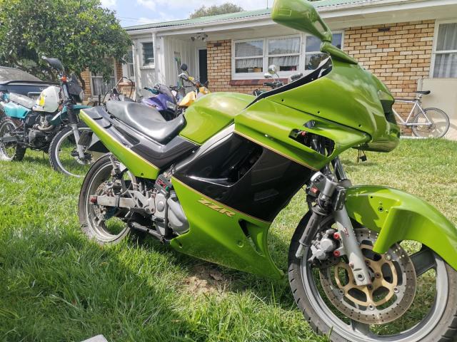

    done a few things since, some bikes, small projects, finished the little house
    heres a bike i have just done, will probably 2 tone the tank to match before putting decals on
    green with gold pearl, gold pinstripes and decals, and metallic pearl with yes ticked on how much pearl i wanted (its actually some leftover paint from a nissan dualis i painted a while ago, its horrible paint, frys up if you even look at it funny)
    bike had a rough life, so i put about 80 hours into repairing, prepping, and painting till clear coat. over about 2 months when the baby is sleeping. which sounds a lot, but maybe 20 was just plastic welding and making new tabs, had to get a new tank as it was rusted out on every surface, i have never seen that before. many layers of primer filler, a couple coats of white 2k to seal it and give a nice base for the green to pop on. 3 coats of green, 3 coats of clear, resand and tape up, 3 coats black, pinstripes and decals on, 4 coats of clear.
    its ok for a shed paint job i reckon (yes thats a second purple one in the background, its a great bike for a 250, i want to sell both of them and get a bigger brother to it)
