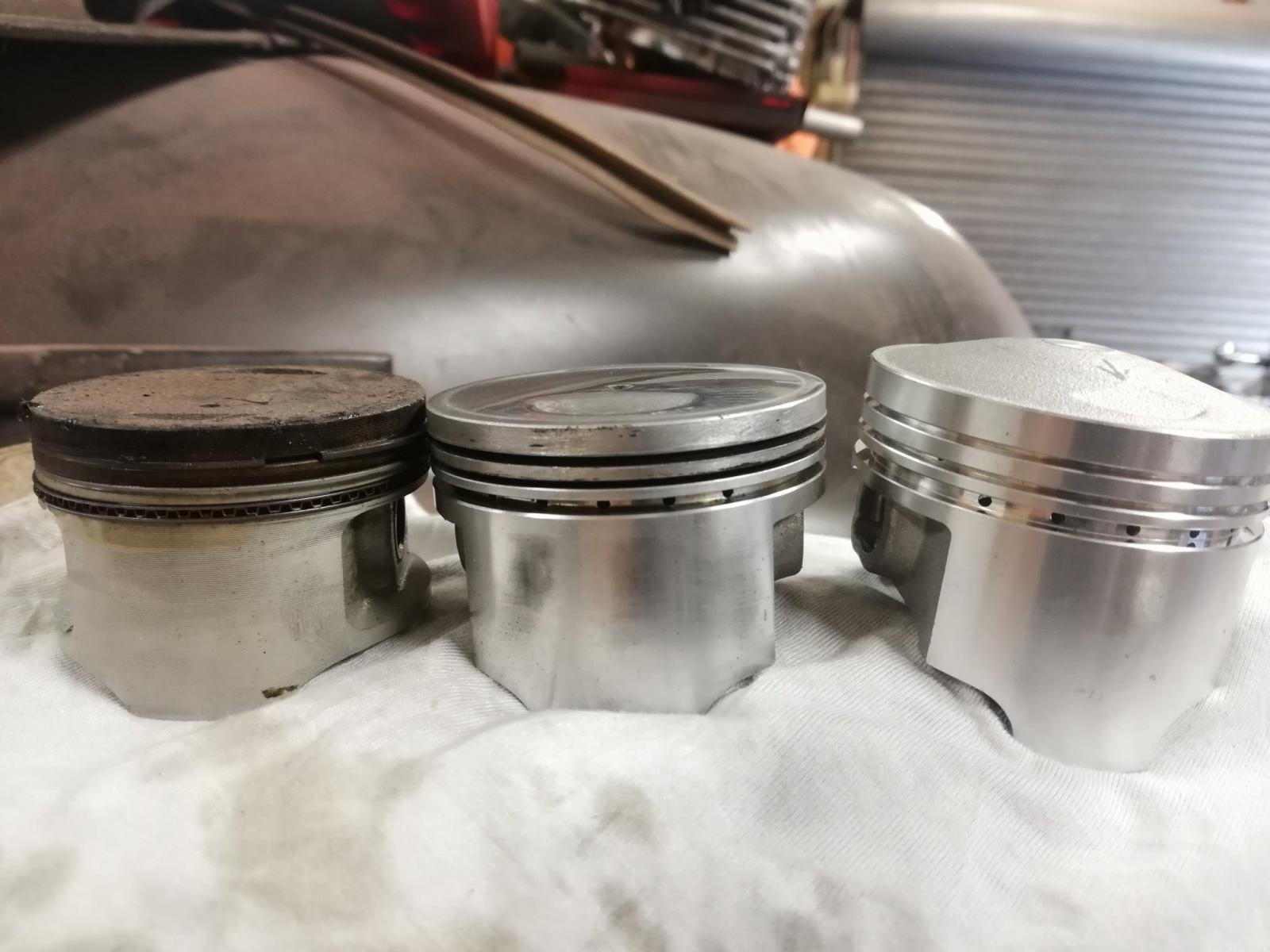

    left to right. totally flat 125 piston, slightly domed big bore kit piston (which i have taken the sharp edges off the valve recesses and mirror polished), much more domed gs150 piston.
    GN has squish areas like the head on the left. GS and i believe DR have a more open combustion chamber, and the DR200 and LT230 have a totally open combustion chamber and i beleve use a domed piston for the squish area. Early GNs have a piston with a big knuckle on top, so lets ignore those.

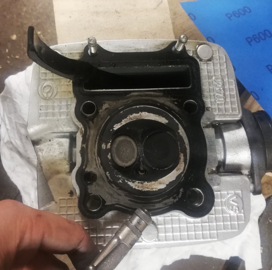

    heres my head with a 125 head gasket (silver) and a 150 kit head gasket (black and 1/3rd the thickness)
    heres a close up of the sharp edge of the squish area
    and im talking cut yourself on it sharp.

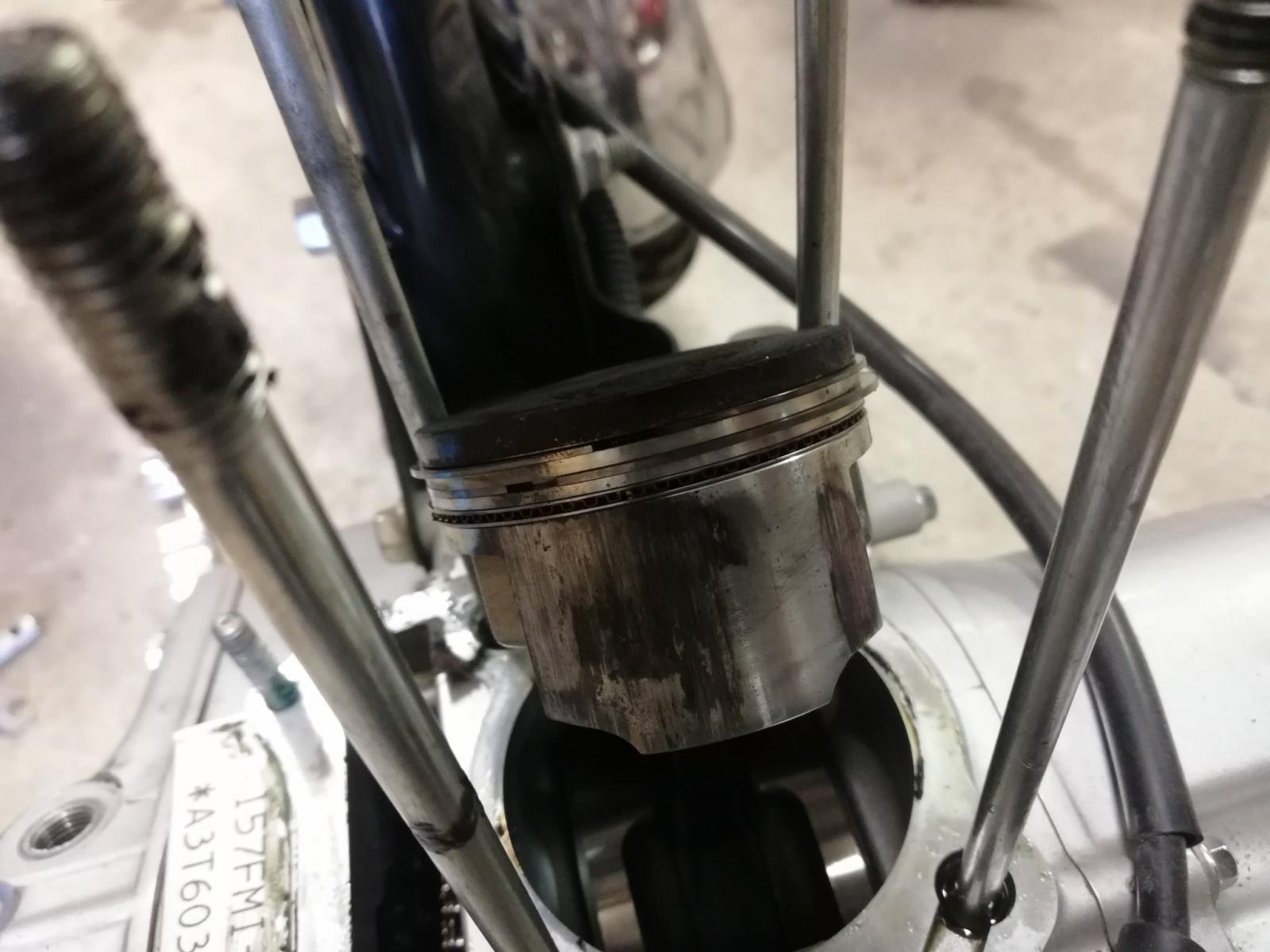

    Now, heres my piston thats in there now
    Ive been getting blowby into the crankcase, and theres scuffing on the intake side only. I believe this has been caused by preignition.
    I may have mentioned i have had to use premium 98 octane since i put the big bore kit in.
    a short bit on squish areas
    these act to prevent unwanted detonation by forcing the air fuel mix back towards the combustion chamber. You want a tight clearance to limit spots that can cause ignition, typically modern cars have a large squish area, and messing with them is generally discouraged
    What i think is happening is that instead of the squish areas squishing the mix back towards the combustion chamber at TDC, that the clearance between the domed piston and the edge of that squish area is causing some of the mix to become trapped at the outer edge of the piston and causing preignition expecially when at high rpm or under load.
    The flat edge on the piston is too narrow. Piston options are limited in this size with a 14mm pin size. Best performance option is to get a bigger head and a domed piston to match, next best is to get a flat top piston. next up is modify what i have and hope it works.
    An extra base gasket is my back up plan.
    I figured i could break that sharp edge to help the mix to flow past the dome edge better
    i broke the edge, and cleaned everything up to 1500 grit and then a polishing mop. At a guess i took maybe 1mm from the sharp point and rounded it over. The consensus is that you want that edge sharp, maybe a quick sand so you dont cut yourself, but dont round it. Well most people arent having knocking issues and are using bigger domed pistons in a higher compression chamber designed for a flat top, so i think im good, but im yet to test it.

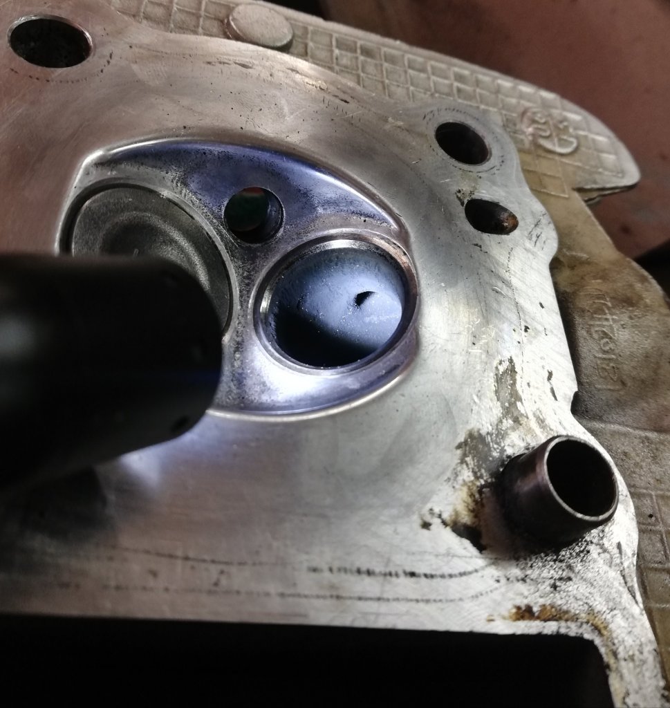

    took a little off the leading edge of the valve guide
    and similar with the exhaust, but i went through the grits and polished this
    only tools used were an electric drill and a 6mm diameter aluminium rod with a slot in it to hold some sandpaper (and a polishing mop)

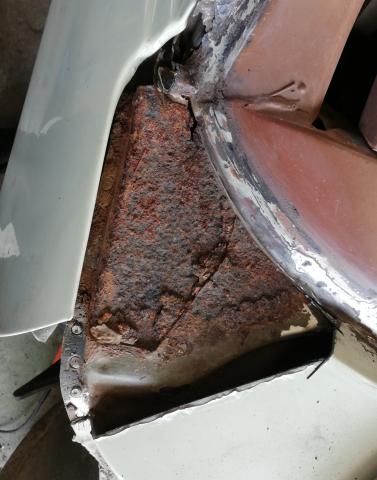

    welcome to tortrons house of rust
    Just doing some typical 70s holden rust
  14. #89
    1,222

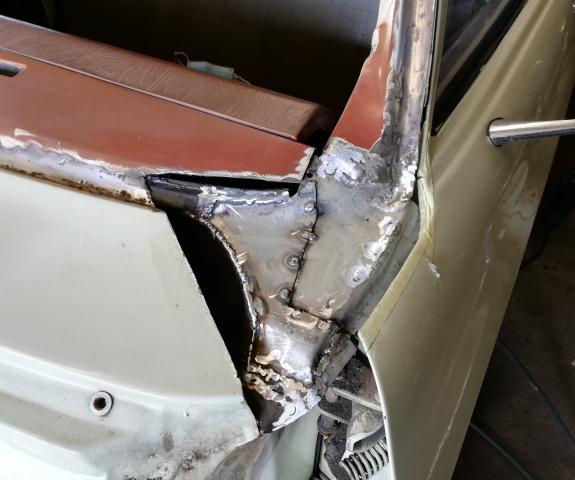

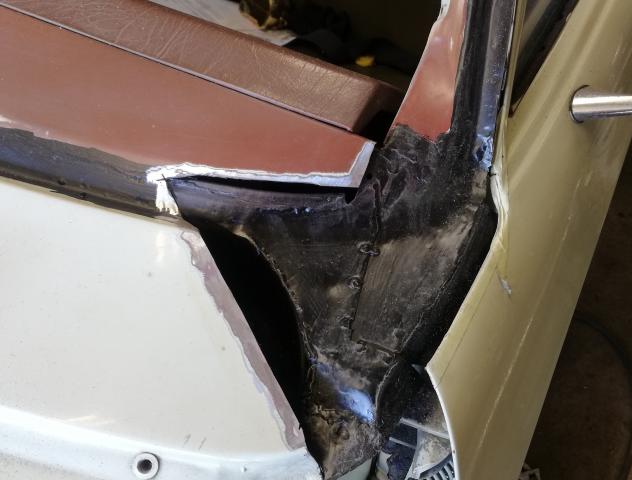

    And then I made a new one
    Waiting on some paint to dry and then I have a reproduction panel to weld back on top (after spending the morning making it actually fit)
    Then the other side

  16. #91

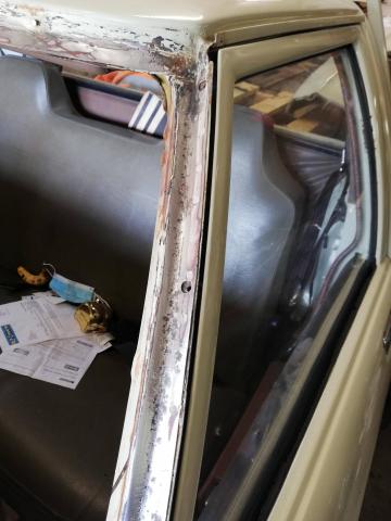

    What a nightmare fix. I guess the window was leaking for a long time.
  17. #92
    Oh sheee-it. Are you sure this truck wasn't dredged from the bottom of the ocean? That kind of rust is normally a deal breaker. My hat off to you for even being mad enough to tackle it dude
  18. #93
    1,222
    It had some small patches put in the cowl corners back in the late 80s or early 90s, plus the screen looks like its been in and out a few times, so rust started forming under the mastic and here we are today. They all rust out here
    These old holdens are worth fixing now days, can get a complete upper and lower cowl panel if you are keen, but they are for all the H series holdens and need quite a bit of work for the price. normally just the corners rust out.
  19. #94
    Ah that's what threw me. I'm looking at the first pics and thought "wait a minute... since when was a Gen 1 built like that?" I should've realised by the corner of the dash pad it was a HQ/HZ Holden. Bet the frame has been patched in that place behind the cab a few times too.
  20. #95
    1,222
    Not even gona look tbh, squizz some acrylic lacquer on it and send it out the door
  21. #96
    I pity the fool that has to deal with that. Notorious for completely rotting out. I saw a HQ folded into a 'V' in North Adelaide due to frame rot
  22. #97
    1,222
    And it's fixed
    Was a bigger to blend the roof in, the brake shop managed to spray fluid on the roof???? And it lifted the lacquer. Had to use some 2k to seal the edges to stop it lifting when I sprayed fresh stuff on top. Came up pretty good, will look original with a cut and polish.
