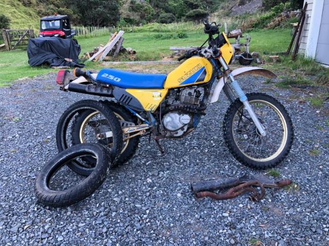

    2 owner 1986 DR250S. That's right, a Gn250 engine in a dual sport frame. This is the S model which means steel swing arm, fuel efficient CV carb and much less suspension than the other models that were surprisingly raced to some effect until anything decent came out.
    First owned by what is now MPI where it was used to pop down from the office to the yards to inspect the wild caught deer before processing. That's where it got the dent in the tank.
    Then on to the guy I got it from, who had it for 25 odd years, until recently when his two sons got a hold of it (one was the one who got it road registered to get to work, then lost the job 6 months later) who left it outside, and dropped it, so now it's mine.
    Bike failed to run when I picked it up, despite the sharn of always starting 2nd try and it having never done that before, oh and the fuel line was pissing fuel out very effectively. He also showed me the rust holed old exhaust and told me how to weld it all up cos the new one it's got was $600
    So I paid the guy and loaded it up, its an old suzuki you can't really expect any better than that
    Rolled it off the trailer and thought I'd better start a list of stuff it needs. Starting with the no start. Plug was very wet and had a black ring around the ceramic, so it's proba ly pretty old and stuffed, gn125 plug is too small, DR200 fits just right (although I later found some new ones in the parts box) with known good plug it started right up, runs very nicely, which given my experience with gn250 engines is pretty surprising. He was changing the oil every 3 hours so the top end and chain is probably as good as can be, the engine has a legitimate 7000km on it.
    With the engine running I did a loop of the house and it all feels happy. The brakes are fantastic, no suspension noises, the fork seals are not that old, seat must have been recovered.
    Gave a walk around and have a few issues.
    Rego is on hold and now in my name, but he lost the plate, so will have to go get a new one.
    Tail light is smashed and the parts are lost, same as old dr125/ts250s and is fitted with the cheapest of the 3 options, so I ordered a new lens.
    One front and one rear indicator is broken. I think I can fix the rear one back onto the flex stalk, but the front is smashed to bits and missing half. On close inspection the indicator body is the same as a gn250. So I ordered a full set of black ones and may just swap the whole lot. They won't be flexy, but they never actually flex do they.
    Missing it's tool box lid
    Came with a probably dead battery new in box, will see if it comes back to life, needs a strap and is apparently missing some plastic box thing, I think just a tray but I will check the parts diagram. I don't think it's important. This one is 6v and runs with no battery
    Tank has that big dent, I think I can push it out fine. There's a couple of little stone dents/chips and surface rust forming. It's also rusty inside. Not bad yet(just) but I'm gonna drain it and put vinegar inside probably when I do the dent.
    Master cylinder sight glass is about 19seconds away from springing a leak. Needed one for the DR200 anyway so I ordered a few and will change it.
    Fuel line is split, should order a couple meters for all the others I need to replace too.
    Fork gaiters, one is split in half and both are faded. Seems an odd size but I think I can force the lower part onto the fork from a standard size.
    Headlight bulb is blown.
    Frame
    It's been near the ocean and its just on the verge of being rusty but not too rusty to come up nice with a respray. So I'm gonna repaint it blue, and redo the black and silver parts.
    The yellow parts are not too bad, I think the tank would come up OK, but the fenders are bleached white so I might cive the a thick coat of something to give some structure back, and then paint yellow.

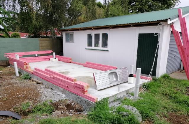

    Did I mention I'm building a house?
    Well more a tiny home/grannyflat/self contained unit. Knocked down my carport, lucky I like small cars because they all go in the garage now. About 7.5m x 3m. With its own shower/toilet/laundry, then an open plan bedroom and kitchen. Cooking and hot water off gas bottles. Had hoped to be moved in right now but last year had me sitting on the plans till I could get stuff delivered (and now there's a major building supply shortage here, at least I don't need much, but I'm still trying to get ceiling battens, there's no fence pailings left in the country).
    I'm basically doi g everything I can legally do myself (won't let me do the plumbing at all if you can believe that bs, I will run the power but have to get a sparky to join it in) so this week I'm precut ting all the framing. Goes up in 7 sections for the walls and then one for the roof, so pretty manageable. Basically I save a year's wages doing it myself so it was hard to drop that on a prebuilt or having a builder do it (if you can get one, took months to get someone just to pour the concrete)

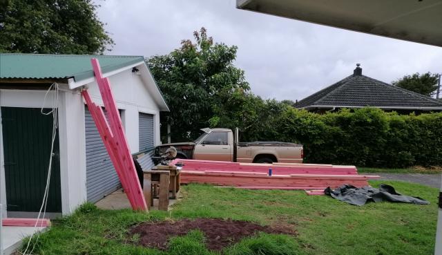

    Too humid to be lifting these around by myself
    but thats one side of the framework bolted down and hung plumb
    We put those horizontal bits in cos of tradition, i think is proven not to increase the strength of the frame at all, pretty sure its because the old houses were very hard native wood and it would be a prime place to leave your beer bottle when trying to nail the posts in.
    Called Nogs in the north island, Dwangs in the south island
    should put them in staggard tbh but its not like that in my plans or any other house i have seen, so again some weird cultural carry over
    Will start on nailing the right hand side framing tomorrow
    3 month wait to get cladding, theres none left in the country

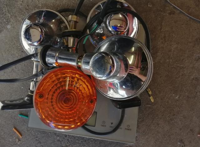

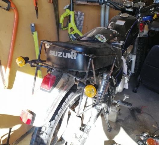

    had some indicators arrive for my DR250, i was going to use black GN125 indicators which look close enough to the flexy originals. But when they arrived they were less than 1/3rd the size they should be! haha
    914g of original indicators! thats almost 1% of the bikes weight
    new ones are 220g total
    and they came out alright actually. The bike will now go quicker, get better fuel economy, and handle better as the centre of gravity is more central now! amazing. Well maybe not quite, but i was aiming for around 10kg weightloss on this bike to get it to 100kg (i think that it was 110kg wet total weight but im not sure now) and i think im just about there now
