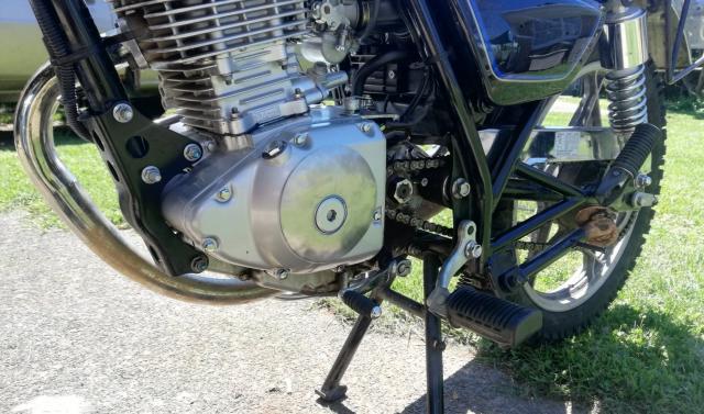

    took all the badges off, remade some brackets in titanium, drilled the inside of some bolts out. saved about 200g. I want to get this to 99kg (stock wet weight is 110kg) so 10% off. Most of the way there already
    made up a stainless steel case guard for the stator side. looks the business for an adventure bike

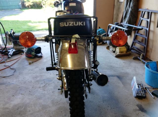

  24. #124
    1,222

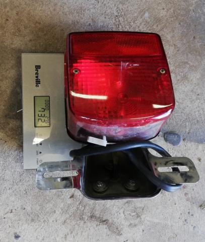

    I asked if anyone knew where I could find an enduronxr style tail light in stock. The next day a guy delivered this for me
    Standard one for reference
    I will angle the guard up to a more visually appealing position from stock. Looks a bit goofy with the big indicators, I think they would look better in the stock position but suck is life, some smaller ones will be in the future.
    Still need a number plate light and mount. The plate fits perfectly across the back of the rack on the seat, so probably there with a couple of tabs to bolt it to as it's easy.

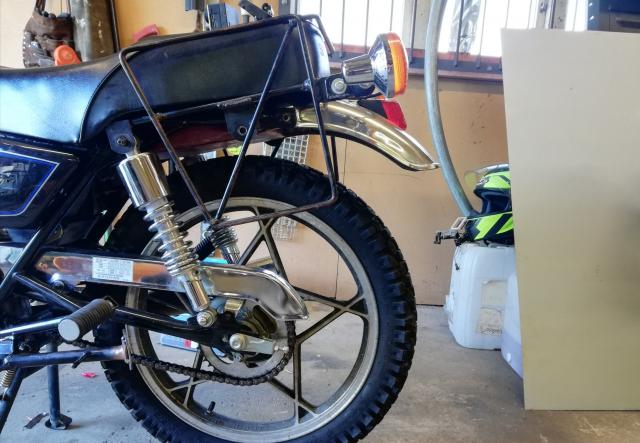

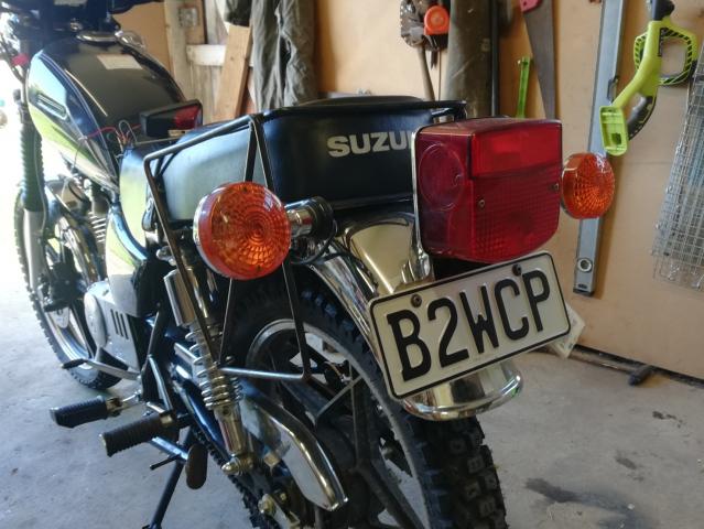

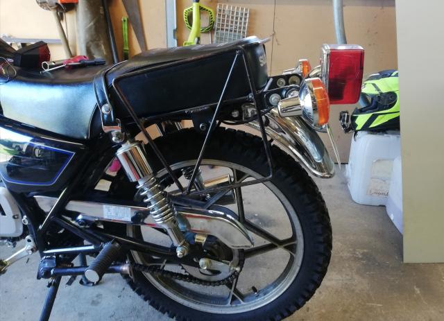

  25. #125
    1,222
    Attachment 25961
    Attachment 25962
    Trying to figure out the least offensive way to have a brake light, number plate, number plate light and a reflector
    Might end up getting a different guard so I'm not fully set on making this one look perfect
    Plate on the rack is quick, easy, functional, and not likely to get caught on anything so maybe that. Looks funny though
