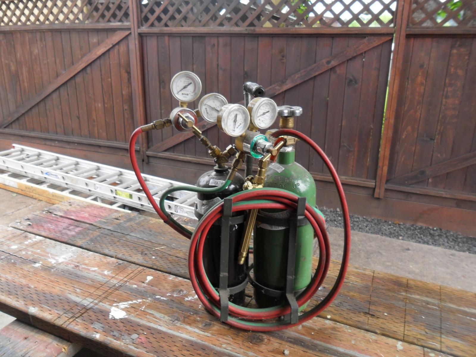

    Here is a picture of the oxy set up I have. Got the carrier with bottles at an estate sale and bought the hose and gauge kit at harbor freight. Normal sized fittings.The welder supply had to keep and test my bottles before they would sell me refills.
    That is a nice old school welding rig I get that gas suppliers have to make sure nobody does something sketchy with bottles and turn themselves into a crater but at least they don't hold you for ransom like they used to here.

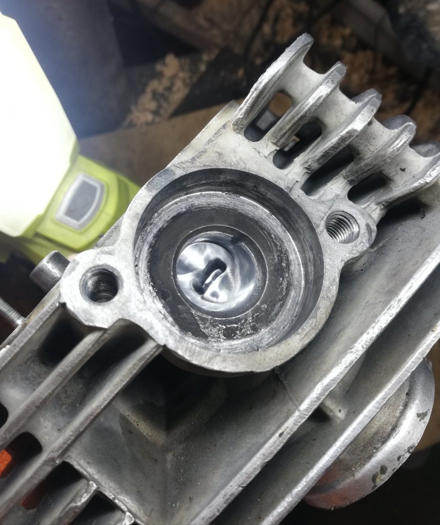

    I figured i could break that sharp edge to help the mix to flow past the dome edge better
    i broke the edge, and cleaned everything up to 1500 grit and then a polishing mop. At a guess i took maybe 1mm from the sharp point and rounded it over. The consensus is that you want that edge sharp, maybe a quick sand so you dont cut yourself, but dont round it. Well most people arent having knocking issues and are using bigger domed pistons in a higher compression chamber designed for a flat top, so i think im good, but im yet to test it.
    and then while the head was apart i cleaned it up. nothing major as its about as good as its going to get already. (better to get a larger head that already has bigger ports and valves)
    Head is set up for EGR for some markets
    little bit of a step on this machined section
    casting is pretty good, just a little to clean up on the sides
    80 grit finish on the intake
    took a little off the leading edge of the valve guide
    and similar with the exhaust, but i went through the grits and polished this
    only tools used were an electric drill and a 6mm diameter aluminium rod with a slot in it to hold some sandpaper (and a polishing mop)
    I have also polished the valve faces and backs (i left the back of the intake a bit rougher incase it helps the fuel tumble in) but mainly just to clean them up.
    Sound about right Geezer?

    Sounds spot on dude I haven't read up on your GN %100 - you derestricted the carb spacer and picked up a bigger main jet? I might round the back edge off the intake valve a little to improve fuel charge fill - and maybe index the spark plug so the open gap is facing into the roof of the combustion chamber just to be OCD.
    1,219
    Carb spacer seems fine from factory, (bike isn't restricted like some used to be) I ended up running the standard jetting, I tried bigger and smaller and all combinations of needle height with my wideband and standard was as good as it got (I think needle mods would improve it but I haven't been bothered to get into that drama too much yet)
    You are probably correct on the intake valve, it was something I was thinking of today.
    Same with the plug, I noticed it's facing away from the chamber when I took the head off, new one will be indexed

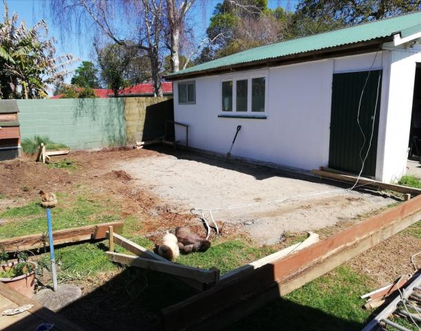

    Tiny home going in there. 3m x 7.4m

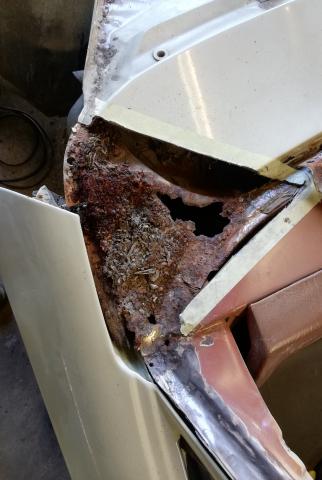

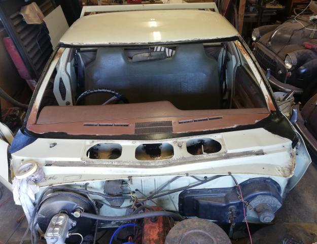

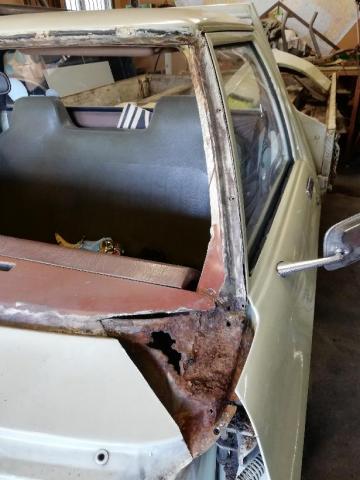

    Just doing some typical 70s holden rust
    1,219

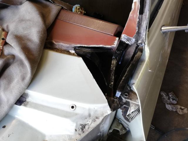

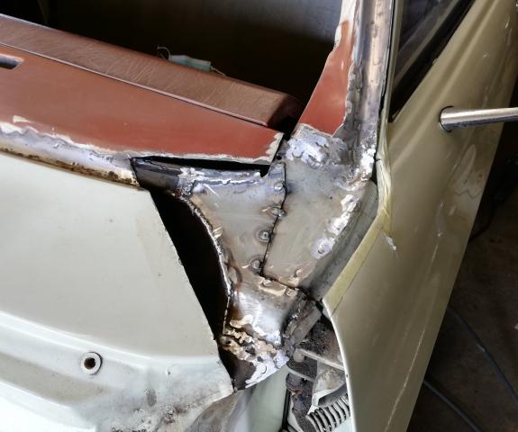

    And then I made a new one
    Waiting on some paint to dry and then I have a reproduction panel to weld back on top (after spending the morning making it actually fit)
    Then the other side

    Nice work.
    3,846
    What a nightmare fix. I guess the window was leaking for a long time.
    Find me on FaceBook
    clicking HERE.
    Oh sheee-it. Are you sure this truck wasn't dredged from the bottom of the ocean? That kind of rust is normally a deal breaker. My hat off to you for even being mad enough to tackle it dude
    1,219
    It had some small patches put in the cowl corners back in the late 80s or early 90s, plus the screen looks like its been in and out a few times, so rust started forming under the mastic and here we are today. They all rust out here
    These old holdens are worth fixing now days, can get a complete upper and lower cowl panel if you are keen, but they are for all the H series holdens and need quite a bit of work for the price. normally just the corners rust out.
    Ah that's what threw me. I'm looking at the first pics and thought "wait a minute... since when was a Gen 1 built like that?" I should've realised by the corner of the dash pad it was a HQ/HZ Holden. Bet the frame has been patched in that place behind the cab a few times too.
    1,219
    Not even gona look tbh, squizz some acrylic lacquer on it and send it out the door
    I pity the fool that has to deal with that. Notorious for completely rotting out. I saw a HQ folded into a 'V' in North Adelaide due to frame rot

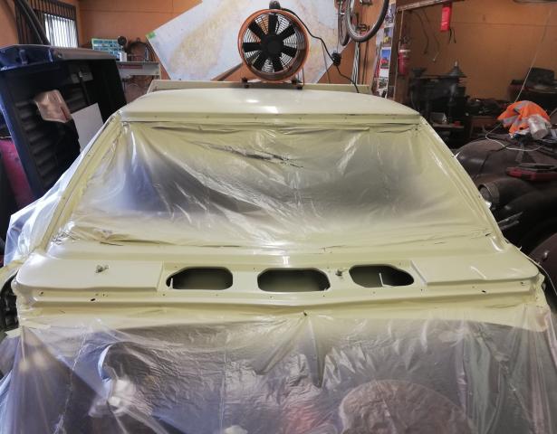

    And it's fixed
    Was a bigger to blend the roof in, the brake shop managed to spray fluid on the roof???? And it lifted the lacquer. Had to use some 2k to seal the edges to stop it lifting when I sprayed fresh stuff on top. Came up pretty good, will look original with a cut and polish.
