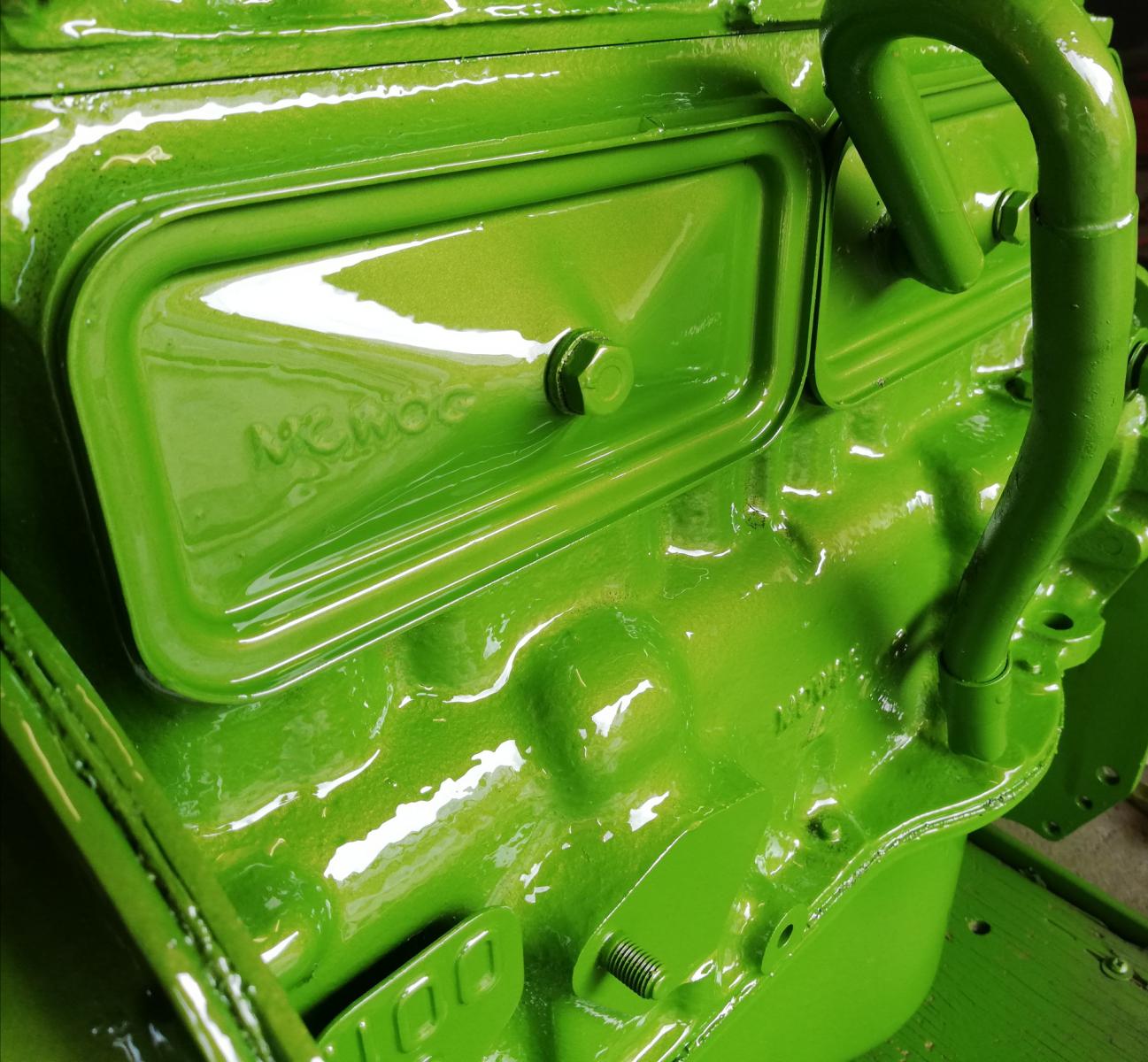

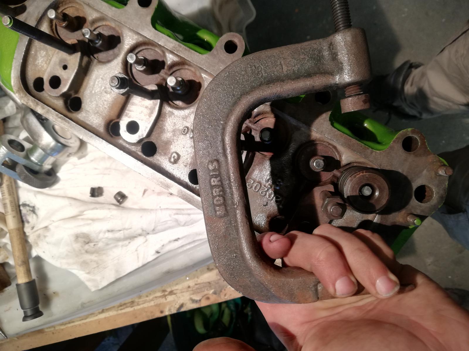

    Today I dug out some Morrie parts. Have a 1098cc engine bottom end that was once in my red minor. A few months ago I bought 3 heads, all of them had worn out rocker shafts. I ordered a new shaft and it arrived just before our lockdown. So I took a break from some mitsi welding and thought I'd dig through my pile and get enough bits to slap it back together so I can sell it off to fund the other engine, and free up some storage space.

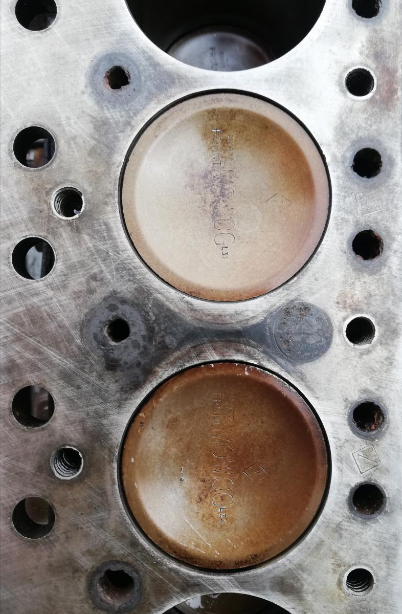

    Cleaned it all up. It's got the original pistons in it. I have a stack of records for work done to it, dunno if I would go back to that mechanic though, all the seals have clear silicone on them.
    Anyways. I looked it over and couldn't see any reason it wouldn't go back together and run. Would probably benefit from a rering. If it breathes to much I might do that before selling, top end gasket sets are dirt cheap.
    I cleaned everything up and thought hey I have an old tin of some kind of olive green. That's what it was sold to me as and the sploge of paint on the lid was kind of light but dull and green. Close enough to an old Morris engine.
    Huh, it didn't mix up right, it kept leaving streaks, must just be too old, oh well it's a junk old engine, spray it on
    Hahahaha
    It's way brighter than the sploge on the lid. And the wierd mixing? It's got gold metallic through it. Well at this point I figured I'd go all in and clear coat it
  4. #54
    Looks like a display engine. That metallic flipped green is out of control! It actually looks half decent. Metallic is a PITA to spray but it can only be worse if you didn't know it was metallic in the first place...

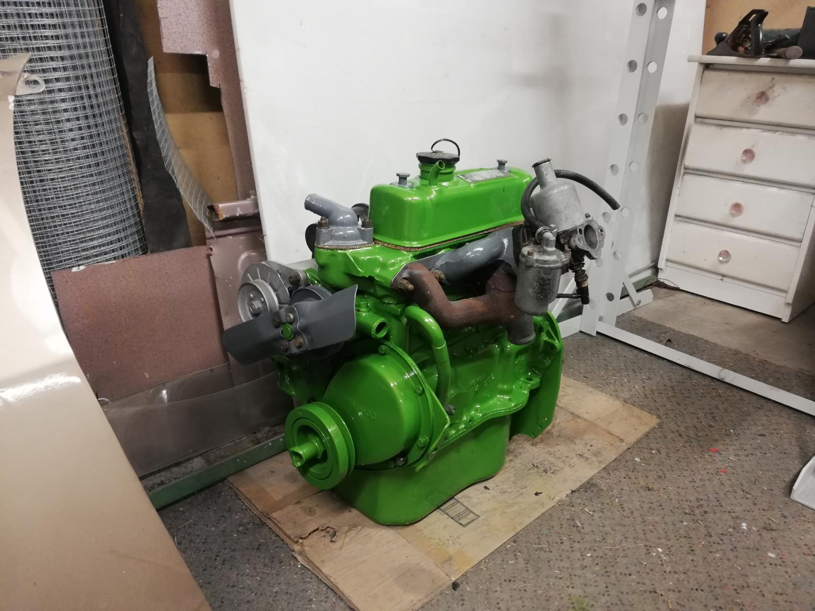

    Absolutely gutted. The rockershaft is for something else, possibly a b series. It's about 3 inches too long and also too large in diameter. This really put a damper on progress. I would have got it going today otherwise.
    Went though my parts bins and picked out all theissing nuts and bolts and nuts and pieces
    Fished up a spare starter that I put new brushes in years ago and never got working right. Will play with that in the morning and sort it out, a dodgy connection I think. Can Rob the generator from my 1300 as I'm putting an alternator on that. Then it's just missing a distributor cap, rotor, plugs and leads. Will retap the water pump bypass to the head in 3/8bsp as it's normally a unified special thread and not easy to get a tap and die in. Can buy a new fitting, but for a couple of dollars I can put a decent brass one on (or easily block it off as most people recommend).
    Missing a disc in the oil filter unit, I wonder if it was run like that for a while, plenty of sludge in the tappet gallery, without the disk the oil bypasses the filter.
    Then some seals for the rocker.cover bolts and the tappet cover bolts.
    I think I will have less than $100 in it so hopefully I can get a little bit back for parts for my 1300

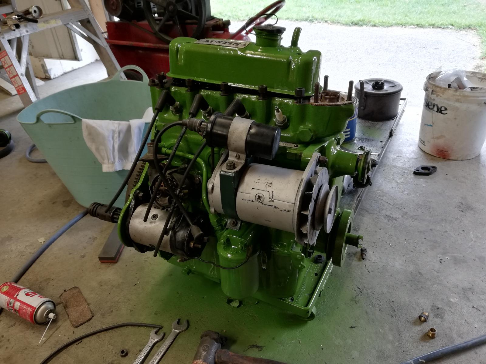

    Put the valves in and lapped them
    Dug out some parts from my stash and put them on, painted the remaining other bits gloss grey for some contrast. Starter and generator were already silver and black.
    Then cleared this side of the garage out and slid the engine away till I get the missing shaft.

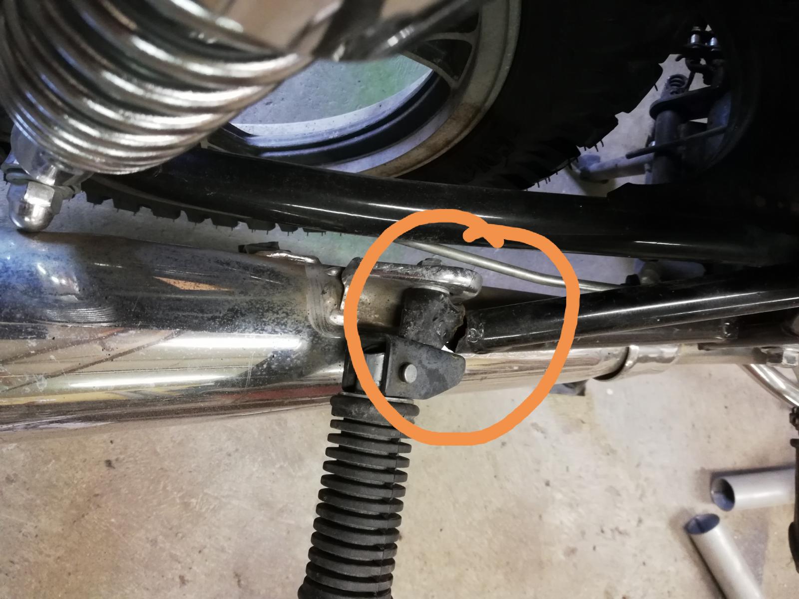

    Noticed my pillion peg/muffler has fallen off
    Could weld it on in about 5mins but I wanna see what Suzuki wants to do under warranty. It's not even a year old and the welds are falling off? Not good
  9. #59
    1,573
    Bummer, where is the broken part?
  10. #60
    1,222
    The boss that the pillion peg and muffler bolts through has broken away from the small frame triangle

    That's not good. I know that they break frame mounts for the engines on MX bikes but that peg and exhaust mount are hardly under any real stress. The fact that the pillion peg rubber has literally zero signs of wear on it would indicate this hasn't failed from abuse.

    Yeah. I used to do jumps on my Japanese built gn250 and had no issues with it. This is just trash quality. My wife has sat on it a couple times, she's pretty tiny. I don't even think the muffler would vibrate to fatigue it. It just... Fell off...
    Appalling for the cheapest new bike on the NZ market! Haha. Got in touch with the dealer tonight so hopefully hear back next week. warranty still has 2 months on it, but CGA would cover this regardless.
    Just curious if they will just weld it back on and ignore that the other welds are potentially like this, of if it means a new bike/frame
  14. #64
    Problem with welding bike frames is it makes them even more brittle. It would probably need to be TIG'd. I don't ever remember having a bike frame fail/warranty when I was assembling them for a dealership. It's rare. If it was a bad Chinese knock off I'd expect there to be all kinds of build quality issues, but there are obscure forums out there that help guys debug them and make them into half reliable machines...
  15. #65
    1,222
    GN isn't going to have heat treated steel, mig weld to your heart's content. I made note of the quality of welds on the day I bought it, pretty spattery. GNs are made in china now
  16. #66
    ^really? Suzuki needs a smack over the knuckles. I know the GN is a dinosaur but this is still a road registered bike (and a new one too) I'd weld the b@stard myself at that rate And China does know how to weld. Did Suzuki farm the frame assembly out to the guys that made K-Marts' kids bikes...

    Get them to fix it under warranty MIG 'n accept only an original joint design & weld... Later, you could add your own gusset use MIG

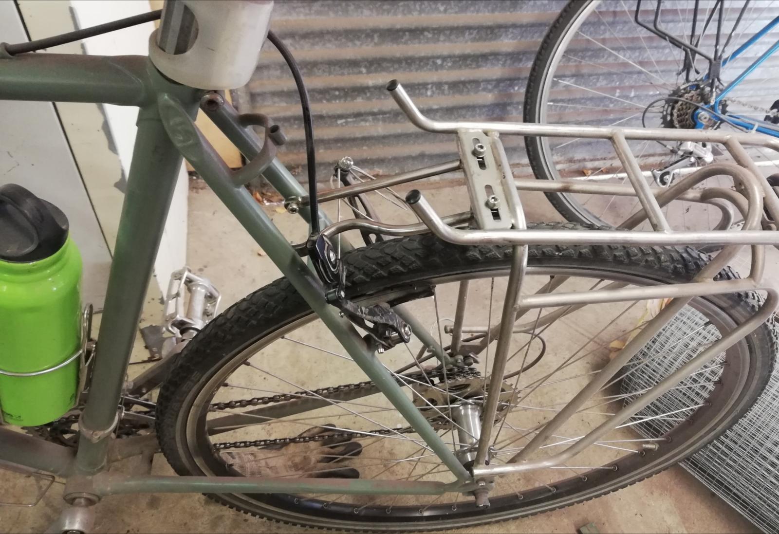

    My touring bike is all hand brazed. It's done a lot of hard miles. I did some work on it the last few days

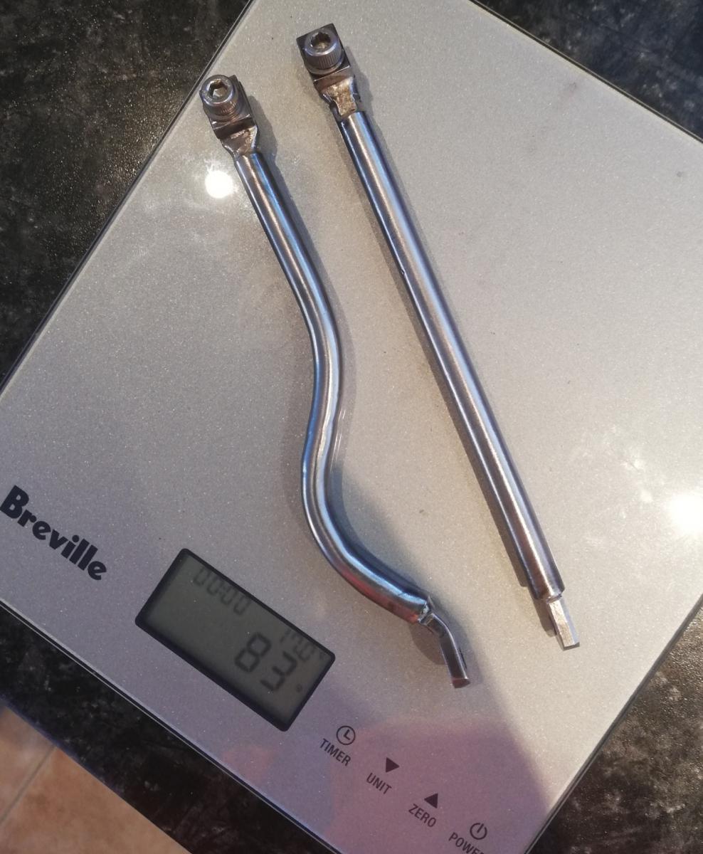

    I have some pretty nice stainless steel racks on it, 30 year guarantee outta Germany. But the stays are aluminium and I snapped one of the eyelets, it hot bent around a bit in my travels. I don't like the one size fits all set up, so I made my own
    Stainless steel capillary tube and flat stock. Part of making new ones was that I switched my brake set up to V brakes and I now use two sets of brake levers on the bars, so I have to use a ratio corrector at the brake end.
    The kink is to clear that
    Came out very nice. I used sil flow 55% silver brazing rod
    Got a few other small jobs on it, a few repairs on old parts. Replacing stripped out threads in the derailleur, I stripped them out in the Atacama desert and Rand a nut and bolt through it, which means it has to be set in the perfect position otherwise you don't get all the gears, and I stripped that bolt last week haha. New shift levers to some that have a built in tag to adjust the, current ones I have to stop and find a coil every 600km. Fixed my bell mount. It was peened over on a spacer, that got torn out on a plane and re peened and then return out on the flight home.... I remade that with some titanium tube and bolt.
    Did some more work to the wife's bike too. Lower granny gear on the crank, have a good sealed bearing bottom bracket to swap out the cartridge style one with and I have some cantilever brake posts to braze on. It was 27" now running 700c tyres and so I'm using some long reach rim brakes from the late 70s on it. They work, but don't look good. And my old canti set up will be much better
    My frame is a 79 shogun 500. It was built from factory as a touring bike. It had some ok bits on it, but I sold most of that off and fully rebuilt it. The frame, cranks and seat post are original. I build my own wheels for them. Mine has tens of thousands of kilometres on it now, u have rebuilt it a couple of times to
