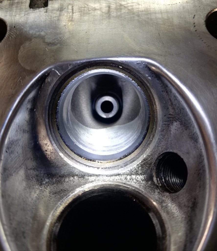

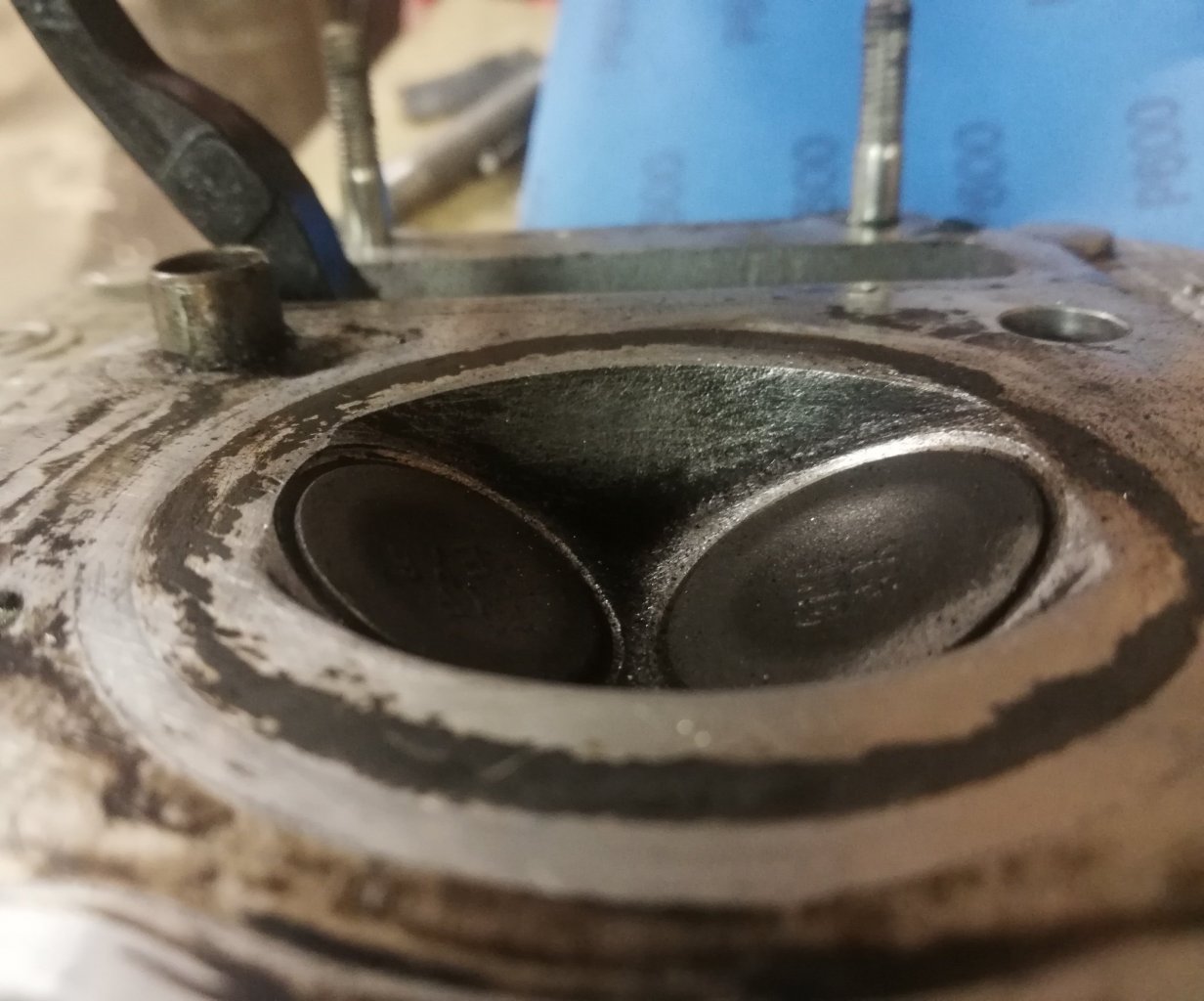

    Engine wise I have skimmed the head to up the compression, tracked down a rare optional water pump (not fitted unless special order) ported the intake and exhaust, lightened the flywheel, and most recently fitted a twin carb and tubular exhaust (I also have a small supercharger that I might put on). I also have an electric fan.

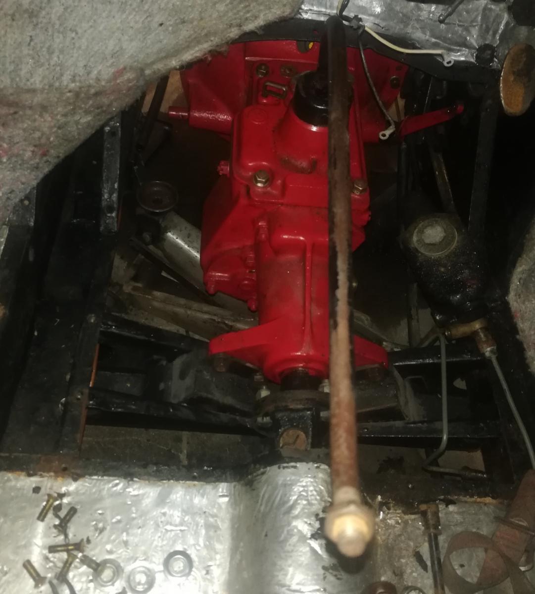

    Gearbox and cross member back in and attached to the driveshaft.
    Special ordered some 30mm copper washers for the engine and gearbox sump bolts. So they are in and filled with fresh oil.
    Now I need to put the master cylinder in and rebleed the whole system.
    And then finally, at last, I can staet on tuning the carbs
    It always amazes me with Brit gearboxes. They are so dinky to look at but are built to take a direct hit from a tank shell. I can't say I've ever heard of one 'blowing up' so to speak.

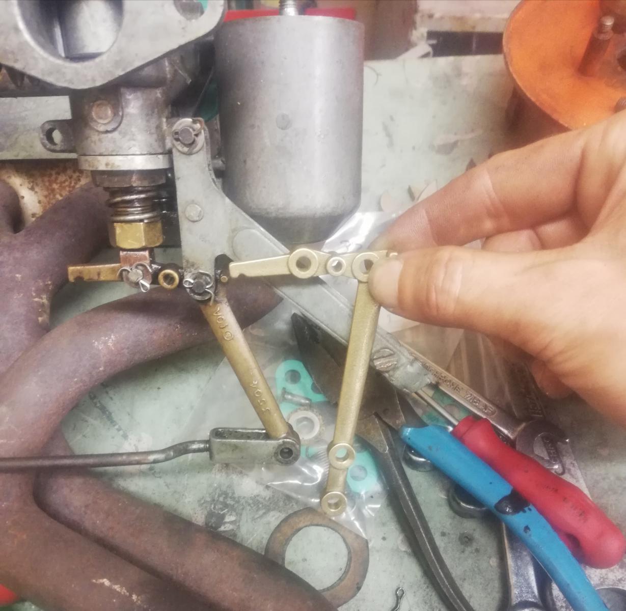

    So I captivated my crossmember nuts, put all the brake lines back in, hooked up the clutch linkage.
    Pulled the manifolds and tightened up everything and put in some new gaskets in the flanges.

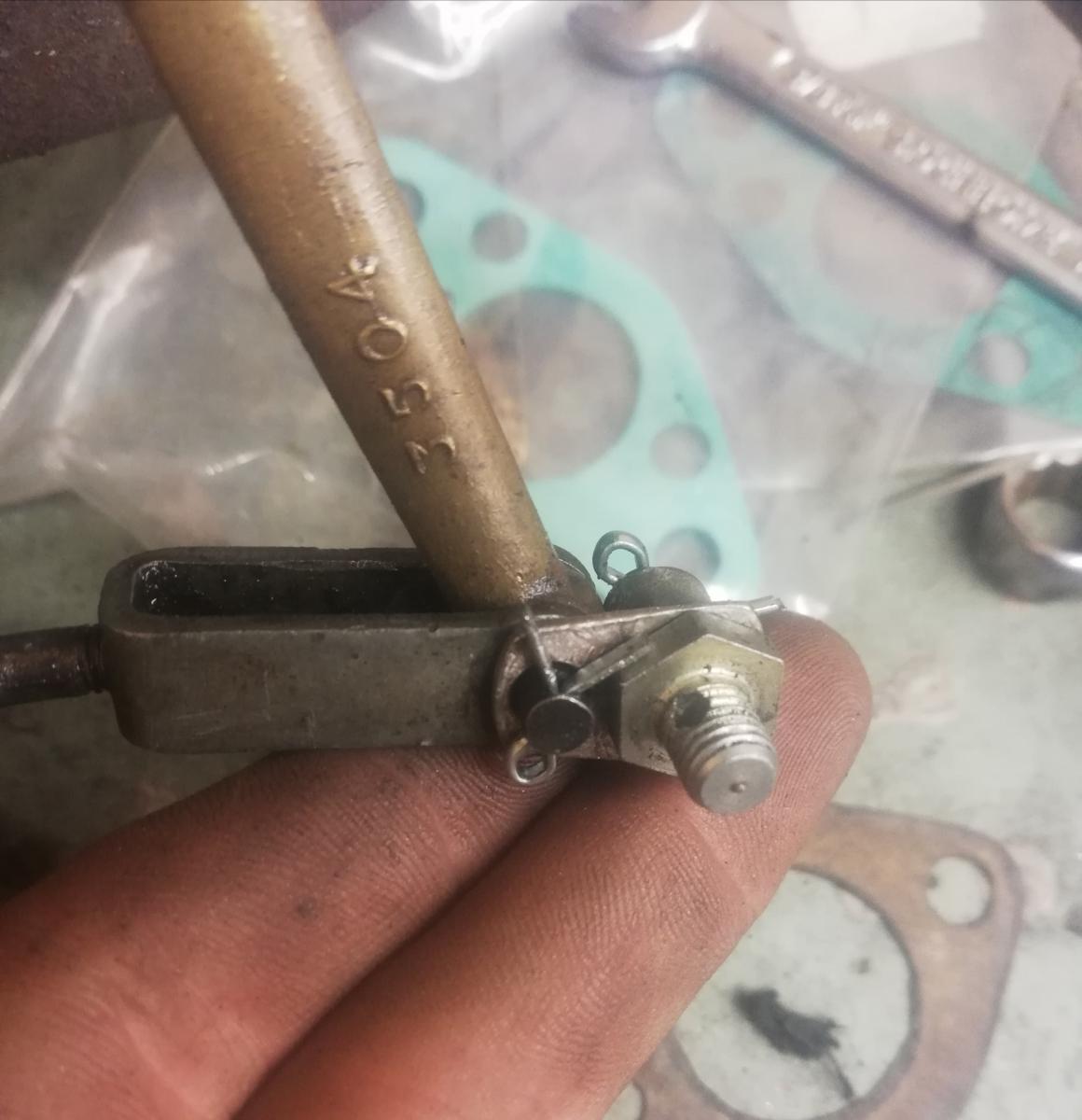

    Had ordered the wrong choke lever, which isn't too much of a problem but looks better having matching ones. Made a cheap fix IMG_20190104_155427.jpg

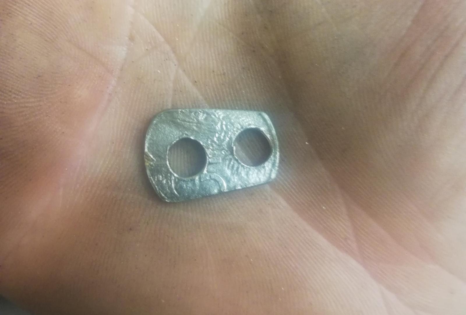

    Yup that's an old NZ 5 cent piece. I had some steel I was going to use
    But this will give someone a chuckle down the line I'm sure.
    Can attach the cable well enough now.

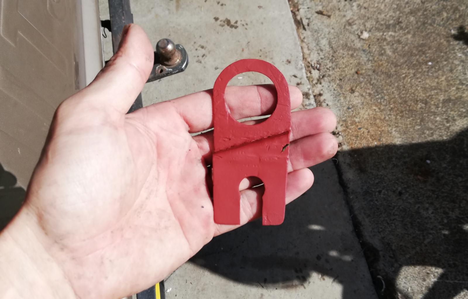

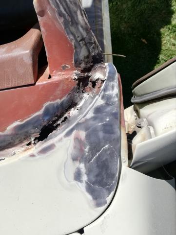

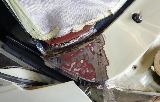

    Did I mention I have a lowlight grill? They originally switched to the high in guard lights because of American light laws, the minor was ment to be what the VW became.
    I got the grill 10 years ago. Turns out it wouldn't fit due to the headlights fouling on the inner guards, even without the headlights in the headlight area hits. Had hoped that mine being a really early high light it would fit sort of.
    So I got some lowlight inner guard panels, about 6 years ago, unobtainable basically

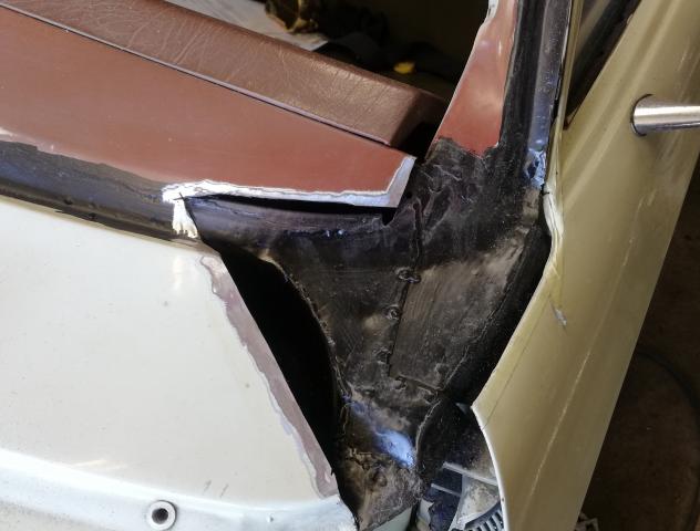

    They rust out up top where the wheel flicks muck up.
    First one not too bad. Good enough to copy
    Next one. Kinda thin
    Using a hammer and dolly on all these patches. Welding the flanges on. A shrinker stretcher would be great for the next rusty car.
    From all the fresh steel, this was pretty thin

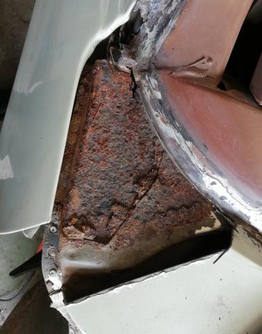

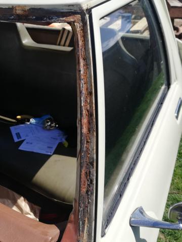

    1,219

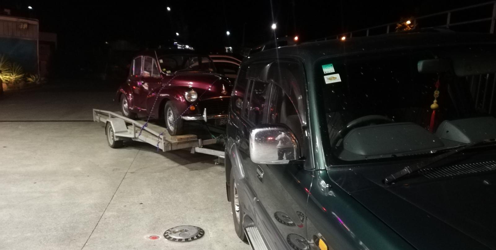

    Well it took about 12 hours round trip for what should have been 5 max thanks to me forgetting about Easter traffic.
    She's very nice. Also has the original plates and heaps of paperwork. So I should be able to keep those plates and get it re registered pretty easily. One engine in bits, appears to be a fully rebuilt one for some reason taken out and head off. Other is probably a 1275 and was bench run. Otherwise I dunno anything about it.
    A few bits are apart, but the bulk of its there. Only seems to be missing the driveshaft, but will unload and check it out in the AM.

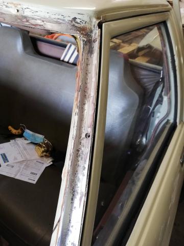

    Paints pretty decent, interior is brand new. Front chassis legs are no longer existant, and the patches last owner made are not to my standards (made from sections and looks wonky to me) IL probably cut it out and order premade ones to save me making them.
    The paper work is great. The second owner lived just down the road from me
    Yikes! That is some really ugly rust hiding under the glossy painted shell.
    1,219
    Yup. I was totally prepared to strip this one for parts.
    But reading the history and receipts it would seem that everywhere else has already been replaced before paint. There's no nasty bubbles in the body work so I'm thinking it is just those chassis legs needing replacing. Can get a pair from the usual minor parts suspects for around 300 delivered. So might just do that. By the time I measure twice and cut once (sections include the lower A arm mount etc) its probably smarter just to get them sent.
    In any case the guys patchwork repairs don't fly with me, so they definitely won't fly with a grumpy inspector

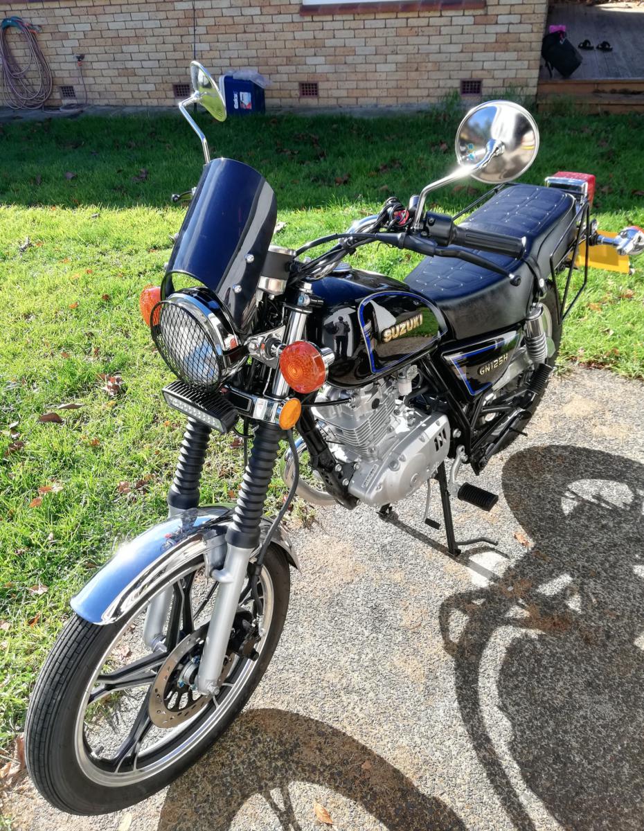

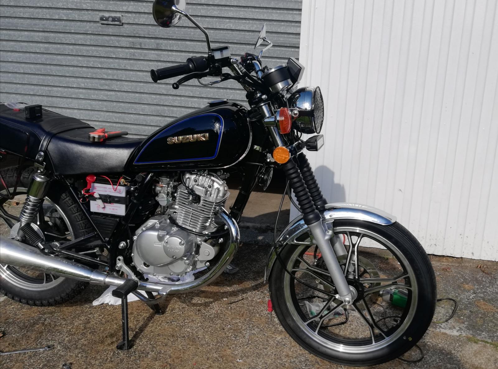

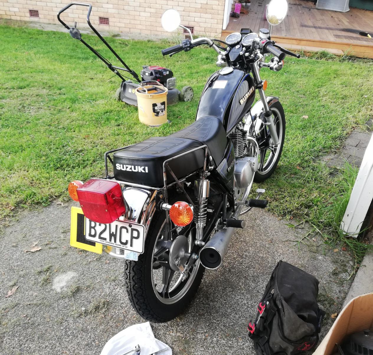

    Here's my current winter ride
    Brand new off the showroom floor 2019 Suzuki gn125.
    Amazingly it does over 100kph 2 up which is better than the gn250 I had 10 years ago. I wonder if they are using the 150cc cylinders that are printed 125...
    Anyway. Nice little economic bike for the city with no risk of being stolen or tears if I find it knocked on its side.

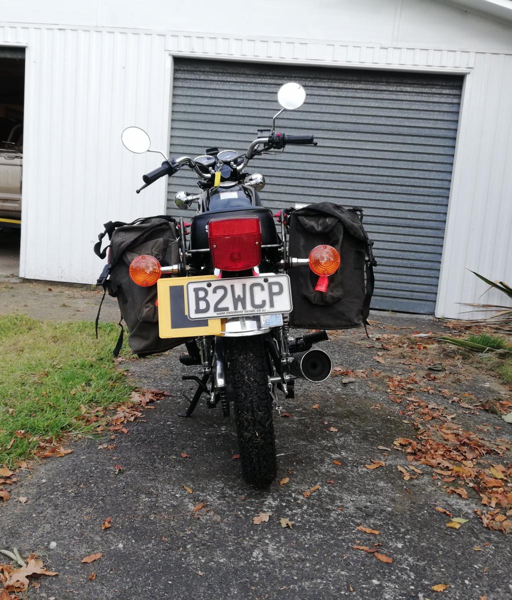

    A few mods make it that little bit better, I built a pannier rack for some canvas bicycle bags and put on some fork gaiters and a headlamp guard to save premature wear from road grit, and will look the part on some camping adventures (I want to embarrass the boys on their 1200 BMW adventure bikes) also have an led light bar to go on and a screen. Rack cost me $8 in steel and all the bits I bought came in under $40 so it's cheap fun. Currently costs $0.05 per km to run, can't take the train for that!

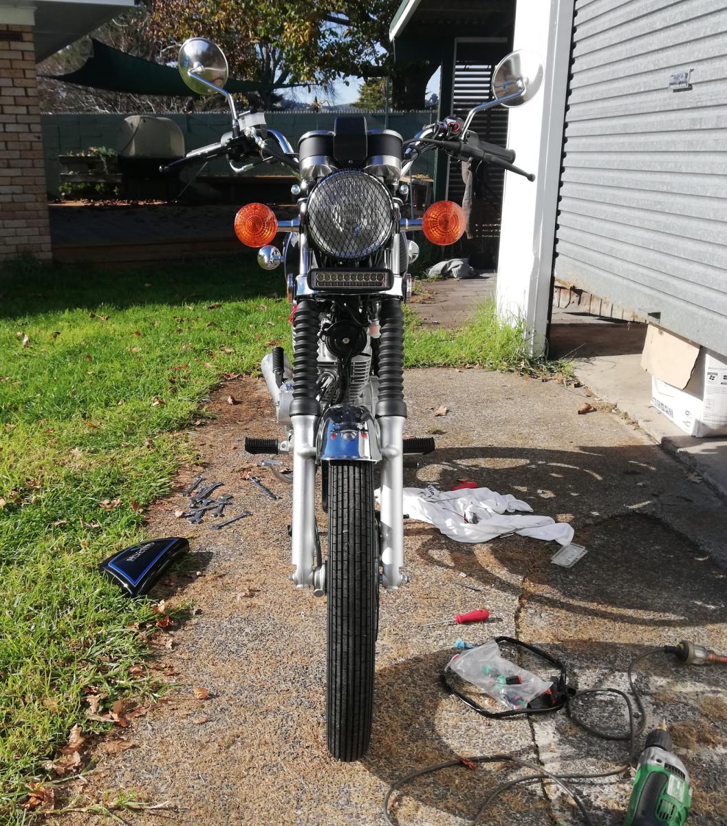

    Ordered the wrong switch, but I threw the rest on anyways and just have some toggles ziptied to the bars for now.
    Dual function LED light bar white flood and amber fog light was my idea.
    Run off a relay from the battery rather than off the ign, but I don't think il forget and drain the battery. The switch lights up too.

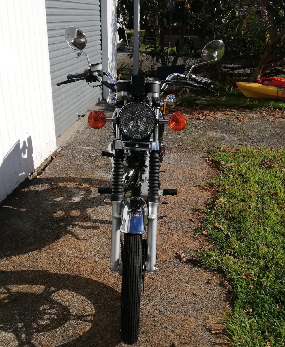

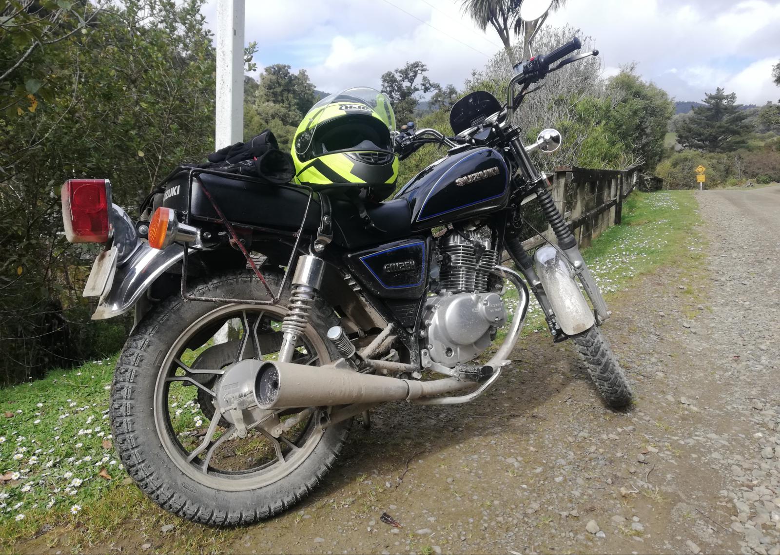

    Pretty much fully "built" now
    Only thing I would really change is the tyres, came with cheap city tyres that are ok for about 50kph in the dry. A set of spoked wheels at a size where I can get good tyres would be a welcome addition, but are worth more than the bike
    I have some plastic hand guards, not so much for brush protection but for the wind. But I sneak through a pedestrian gate and I barely get through as it is.
    Going to go on a few back road/gravel rides and see how it goes. Maybe just an a/t front tyre would be fine. Looking at the "farm modified" gn125s they sell here all they do is raise the front guard, add rubber mudflaps, lower the gearing, flat bar with brush guards, and canvas seat cover, and those things get given hell in all sorts of muck. So probably I would never need to raise the exhaust like a DR125 or need a sump guard.
    Dirty thoughts about riding around the world or something silly, but maybe around NZ first

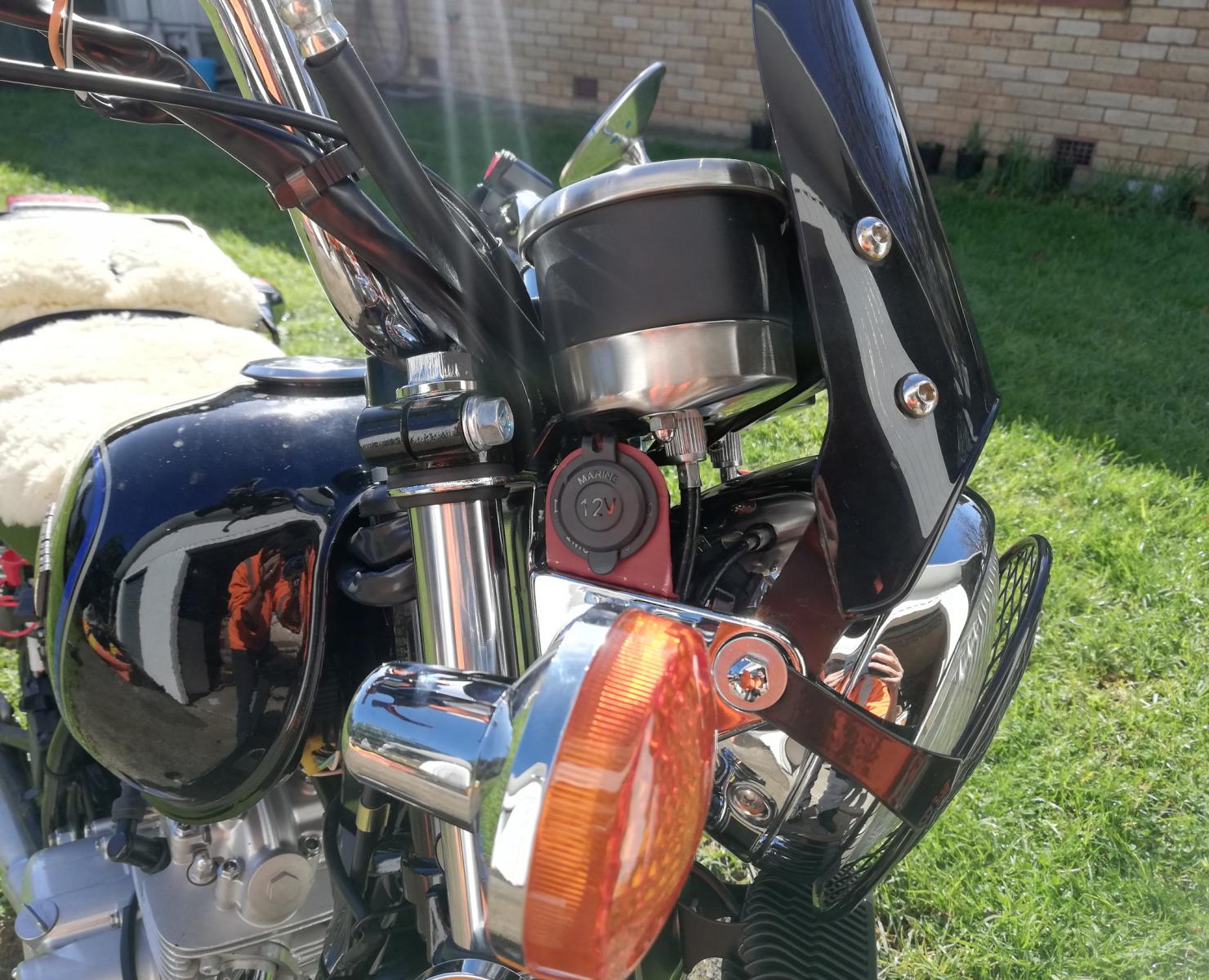

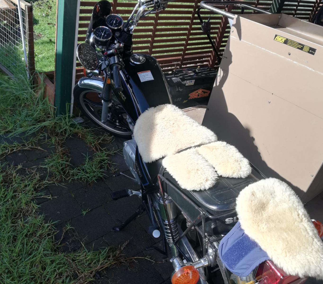

    So some final finishing mods
    A sheepskin pram liner with the head piece removed fits quite well.
    A 12v socket this side and I will fit a dual USB with volt meter on the other. Ign switched relay circuit from the battery with an on off switch mounted behind the battery cover as well.
    I think that's all I will do to this bike, other than some fiddling to set up the suspension just right. I think I can fit two 1.5L fuel bottles in the rear pocket of my panniers, and that would be an additional 100km/60miles I could go, I already have a ultra small tent that will go well on this (my wife and I can juuusssst squeeze in together, but have been thinking of a tarp to sling over the bike as additional cover.

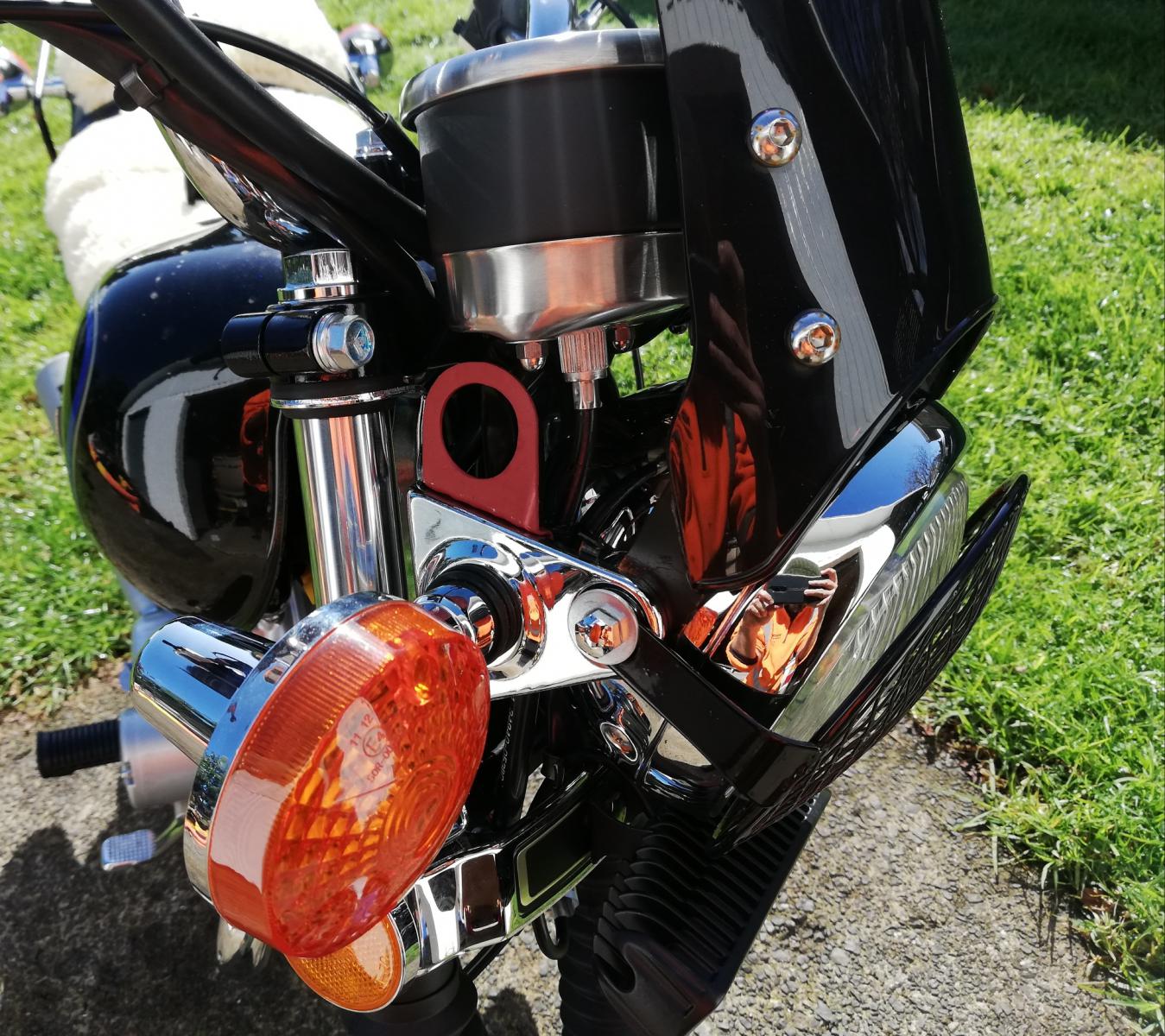

    Wired in the relay etc for the 12v sockets. Deutsch connectors so at least my wiring won't be the ones to fail.
    Turns out there is an unused socket under the tank, at least 3 of the wires are for a fuel gauge that NZ models don't have. One is an ign switched 12v so easy wiring.
    Don't have the usb one for the other side yet, but wires are ready to go
