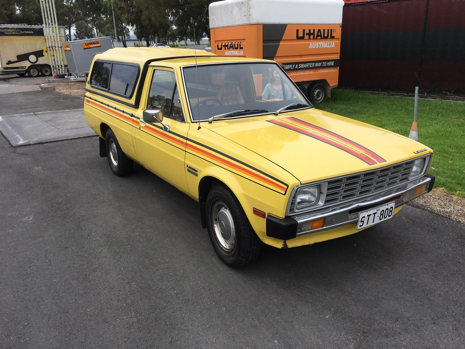

    Hi from Australia! I bought this 1979 Chrysler D50 Sport at the beginning of the year. Also known over here as the Mitsubishi L200 Ute. This little ute was originally the Promo vehicle for Chrysler Australia and was then re-badged for Mitsubishi Motors Australia and kept as the promo vehicle for the model run from 1979-1986. It was subsequently sold to one of the Chrysler/Mitsubishi mechanics and largely owned by that family all these years until recently. It hasn't done a lot of work over the years (140000kms) and has been garaged and kept original. It has a factory fitted 2.6 and 5 speed as well as factory fitted air con, so it's specked the same as an American Dodge D50- we only ever had 2lt 4G52 or 4G63 motors in them from factory over here. I believe the 2.6 & 5 speed came from the Scorpion/ Sigma production lines. Anyhow, it's very rare for an Aussie car and a great little survivor. I plan to restore it fairly faithfully- it has quite a few engine gremlins at present, the main one being a head problem, burning off a lot of coolant. So i'm weighing up rebuilding the 2.6 vs swapping in a DOHC 4G63 I previously converted into another L200 some years ago that I recently bought back as a wreck. I'll post something about that car separately.
    Hope it's of some interest to you good people!

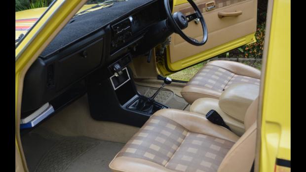

    Great looking truck - it looks just like the 1979 - 1980 Dodge D-50 sport models here in the USA. They came with the 2.6 and either a 5 speed or "baby" 904 Aisin-Warner 3 speed automatic. I also see the bucket seats that were in the sport model only. Any chance of some interior pictures? Welcome to the forum!

    Thanks! I've only seen 1 or 2 other genuine 79'-80' sport models over here. Yep, interior looks to be the same as your Dodge D-50 Sport, same stripes also, which I need to replace. Don't suppose anyone has re-created them over there?
    As a matter of fact, they have been recreated for your yellow truck by someone on this forum - pm 2nup350 for details. I wish the US version came with the center armrest. The center of the seats are the same as the bench seat material, and the dash is totally different than the regular truck one.

    Awesome!, I'll send a message re the stickers. The centre arm rest is actually a really cool folding middle seat! it is slightly different vinyl, so I think someone has added it somewhere along the way. It is a perfect fit in there, and it's made like a proper seat with spring mesh. It is super handy when i have both kids in the car with me, and a handy arm rest otherwise. The vinyl is a bit cracked so I'm going to have it re-trimmed to match the seats better, and actually mount it to the floor- it currently 'floats' in the middle there. The seats & door trims are still in great condition. To be honest, between the seats, armrest, spring rates, diff ratio and air con, by today's standards it is still a really comfortable car to drive. Not bad for pushing 40 years old eh!

    welcome to the forum MrL200 good looking little truck the only bad thing i see wrong is the steering wheel is on the wrong side but other wise nice
    Another member from Oz! Your truck has S.A. plates on it - what's the story? I would advise you not to butcher an all original truck with an engine swap. There are literally no L200's left that haven't been driven into the dirt. If it was a beater, the crime has already been committed and turning it into a project build would be less blasphemous. I looked for a year before I found one that had everything I wanted, and even then it was a mess. Got pics of your previous project?
    I agree with Geezer don't butcher it with an engine swap. I have a 1981 Dodge Ram 50 Big Horn truck that is very rare as well, and I am planning to restore it as close to factory as I can - afaik, there are only 5 left in existence, and one was 4g63t swapped. the interior is trashed, and the motor has a rod knock, but it is mostly all there and no rust holes anywhere, just surface rust in a few places.

    Very clean. A great starting point to chop up!
    Looks nearly factory fresh, would definitely stand out at a car show

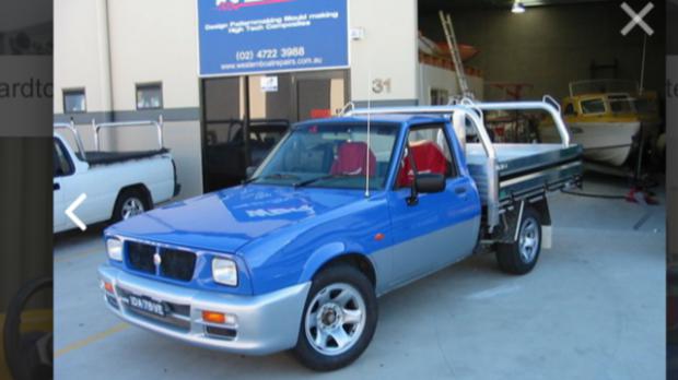

    This is what's left of my old blue 83' L200. This has a 4G63 N/A conversion in it. I sold it a few years ago and then found it for sale at a wrecker when i was looking for parts for my yellow one. It had a full custom fibreglass front end on it that i made. I bought it back earlier this year, still not sure what i'm doing with it yet...
    There is a photo of it on the Gallery page of my website when i put it on the road in 2007. I'll dig up some other photos soon.

    Ready to drive in 2007. Came off the road after the engine died in 2001.
    Your blue project build was a nice truck. Looks like it took a big hit Was that a Skyline front bar on it? If you want to go US style you can use Sigma doors. I remember seeing one on sigma-galant.com when I was an active member. You can get the 2.6 hauling well enough without messing with the truck too much. A decent duration cam and a Weber carb will be a good start (you've already got extractors with some thermal wrap so I wouldn't be surprised if it's had some port work). I've seen bike carbs on the 2.6 and it sounds mean and goes hard.

    Blue ute was a lot of work over several years starting in 2002 when i was a bit inspired by the Rodeo's at the time. I was trying to modernize and produce something that might have been a 'factory GSR' model. It was always intended to have a tub tray but couldn't find one. The front bar is a modified version of the mid 90's triton bar and the indicator/park lights to suit. The grille is custom made from a foam pattern to suit. I have a mould for each of those. Guards and bonnet were fibreglass also- i still have those moulds but I'm going to remake them- guards will be a straight copy, bonnet will be something along the lines of Pennyman's Geronimo but i will most likely copy a standard bonnet to start that process off.
    It wasn't until you said the front end was all fibreglass that I noticed the bonnet didn't have the centre ridge, then the added small side indicators. Wow. I mean that is some really nice body work. You have ticked all the right boxes on the 4G54 rebuild. I'd remodel the bonnet with a reverse air intake over the exhaust manifold side to vent instead of scoop. Heat is the enemy in these trucks, especially the G63B engine. The Gen 1's don't look right with a drop side tray on them, it ruins the lines of the truck. I'm in 2 minds of a custom grille. I'd like to do a full flush front end but I still like my chrome bumper (I picked up a wreck with a Volvo air dam grafted to the underside of it's bumper which is quirky, but works due to the Swedish brick being about the same width and similar body styling) A factory GSR would have twin headlights and a box section or honeycomb grille in black, a front air splitter lip with GSR on the lower right side and no chrome trim strips on the cab (they'd probably be black) The badges would be the same as Sigma GSR's - 2.6 GSR in red. GSR's come with bonnet vents or flutes. If you wanted to really up the ante on the 2.6 - hunt down Sigma GH turbo gear. It's neanderthal tech but is a completely different flavour of mental. My friends' GH in near stock form was silly fast...

    Cheers, i originally made the front grille to suit the standard bonnet and modified the plastic corners of the triton bar, painted the whole cab in acrylic, then decided i didn't like it. So i took a mould off the bar, bonnet and guards, made new guards, filled in the ridge and pointy front in the bonnet mould & made the bonnet and remodelled the grille to suit, took a mould off it and made a new one of them, this time with a flat return back to the top of the radiator support. Then painted the hole cab again in 2-pack. I've gone full circle now tho, i'm more into original with some added extras rather than full custom. I like your ideas on a GSR concept- I may end up doing something along those lines with the blue one. I do have loose plans to take moulds off the tub on the yellow one when i do the resto so i can make a new all fibreglass tub for the blue one. One day, when i have time...
