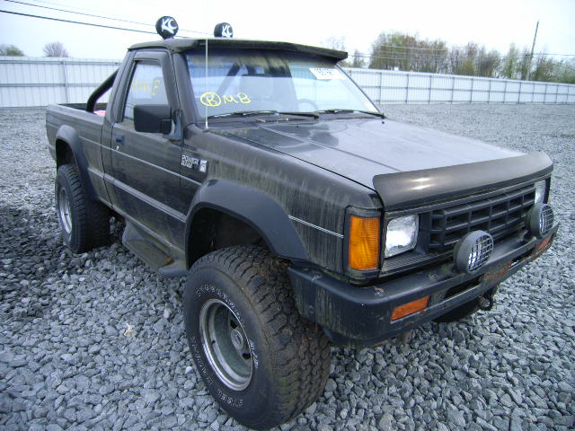

    Seen the OEM flares?

    No, I haven't. I need something I can thin at the top and widen at the bottom. To help my tires look more flush.

    https://www.ebay.com/itm/Fender-flar...0AAOSwR0JUS~L-
    These are similar to the OEM ones. But are made from rubber?
    They're hand laid fibreglass with black gel coating. Pricey but lets face it, this guy has the monopoly on them...

    You might have some luck getting them from a parts truck too. About half of them over here have the factory ones, but they have a bit that joins onto the side trim too so look a bit off by themselves

    the 1st two listings look like oem style.
    1st is $284 for a set of four. 2nd listing is $169 for the front pair only it seems

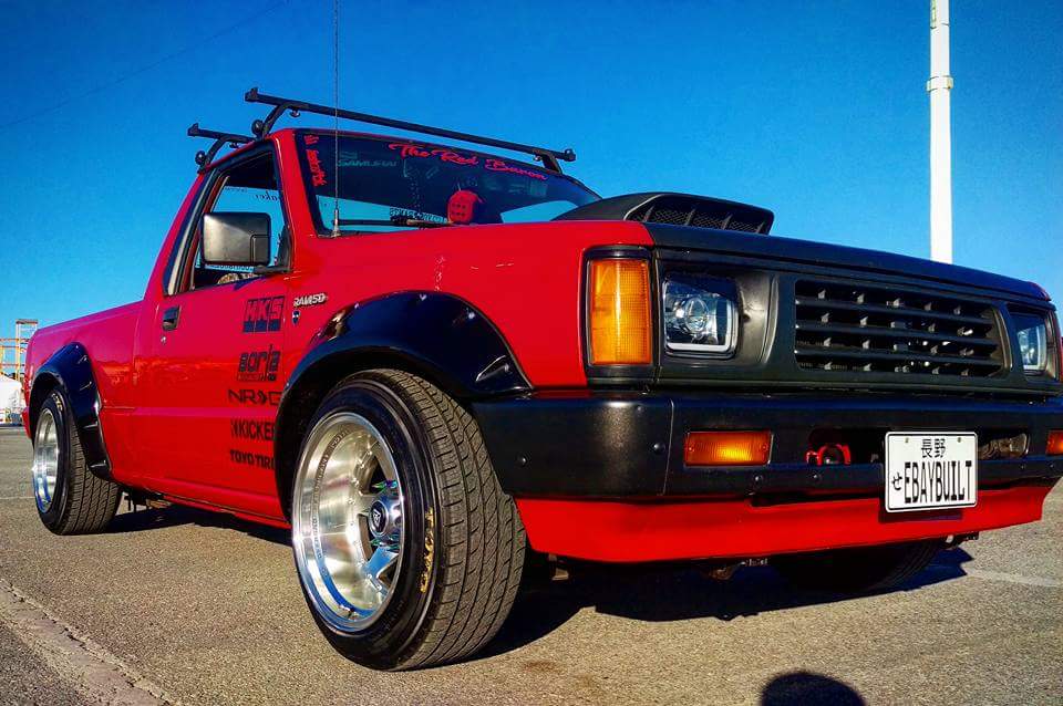

    I'm rocking a set of 16x10 with -44 offset with a set of 195/45r16. Lines up perfectly with a 2.5 drop in the front and 4inch drop I the rear.FB_IMG_1518138697106.jpg

    looks aggresive.... maybe that's what he is chasing as well
    just to let the guy know, one can get a flush look(stock body panels) without spacers or flares

    Niffty license plate LUKE

    Looking like "Back to the Future" COOL
    It reminds me of an R/C 4x4 I had as a kid - big and chunky looking. Very cool
