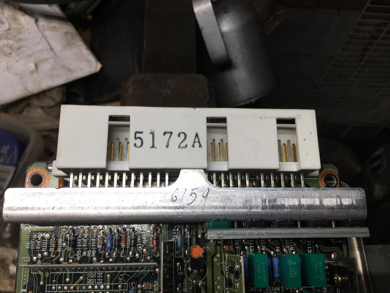

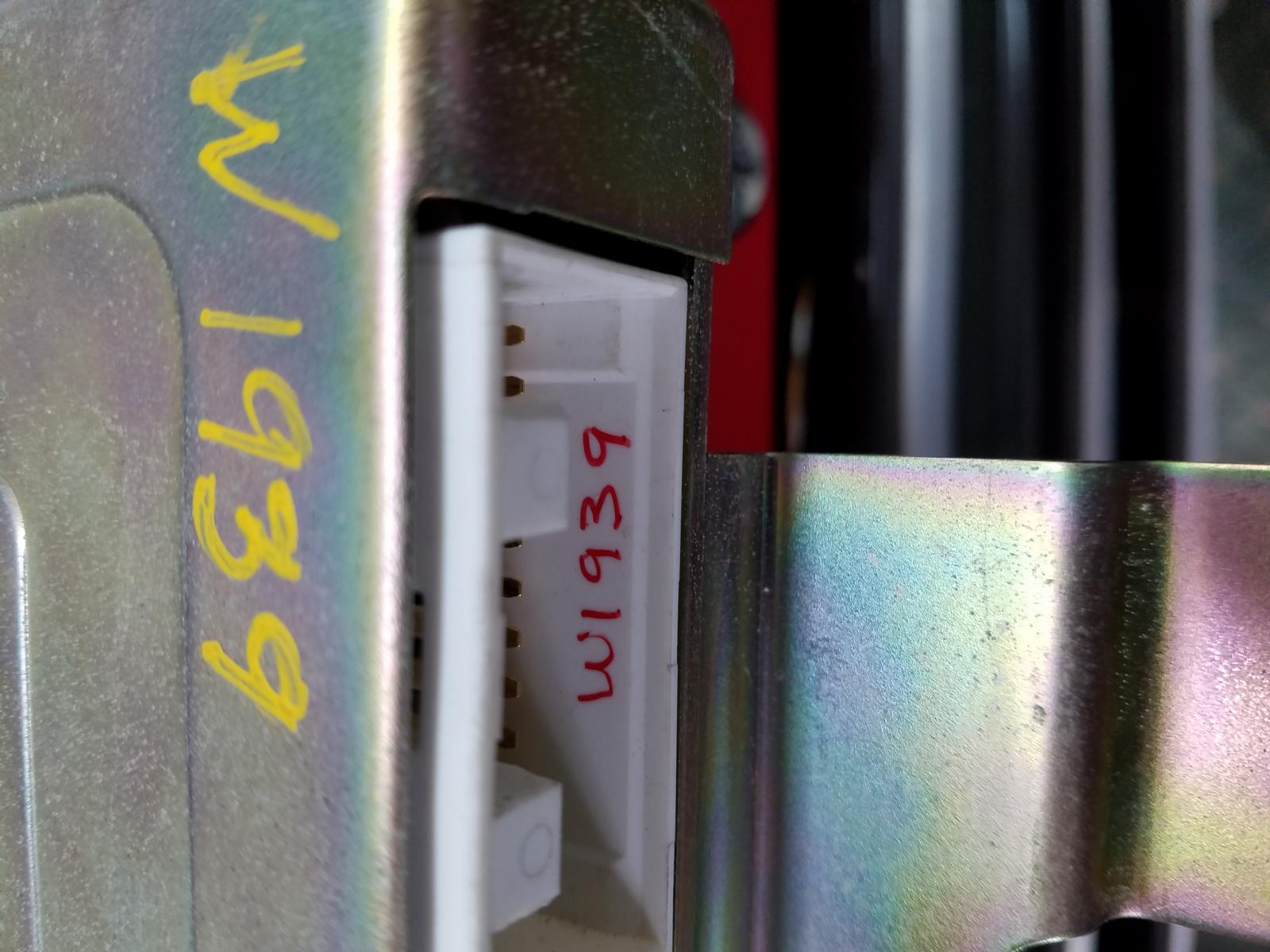

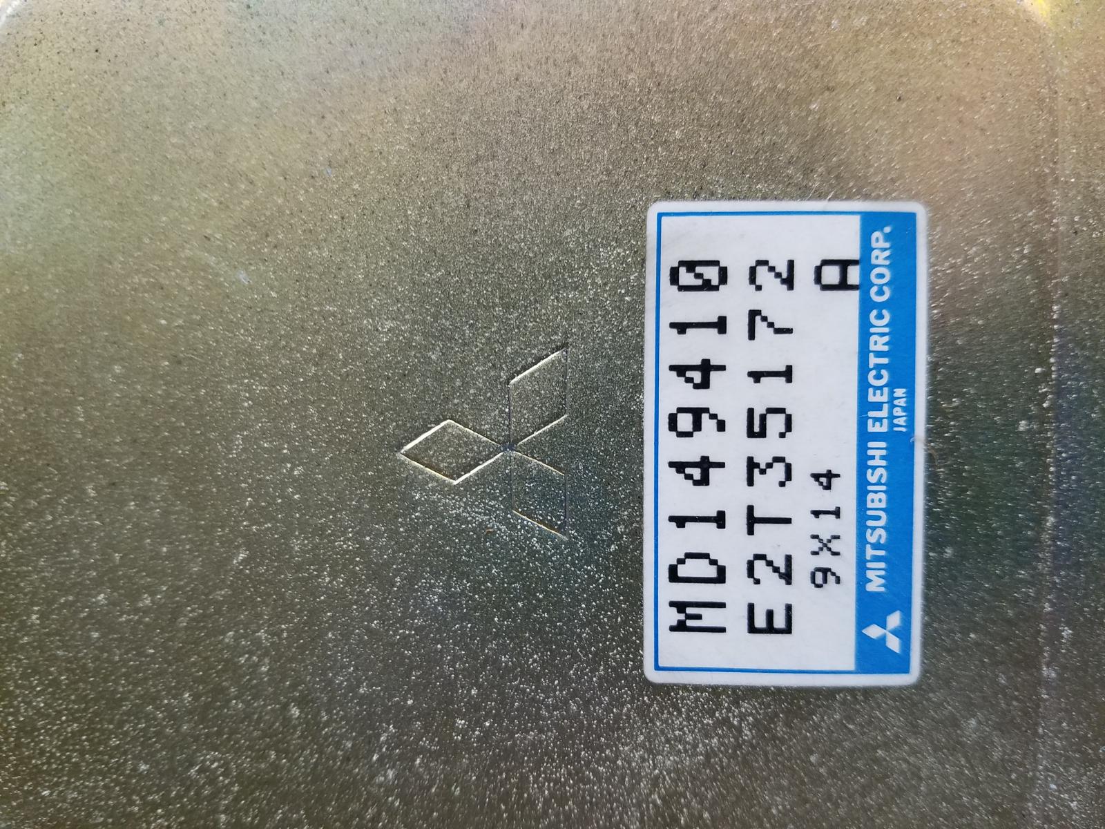

    I popped my '90 3.0L V6 5spd 4x4 ECU out and took some pics for you-including the repair job. I don't who did the repair though, it was done prior to my purchase. Hope it helps

    725208B7-04DD-417B-A5AC-213B2E0BA8D7.jpgI do see the same reference # in my pic
    5172A
