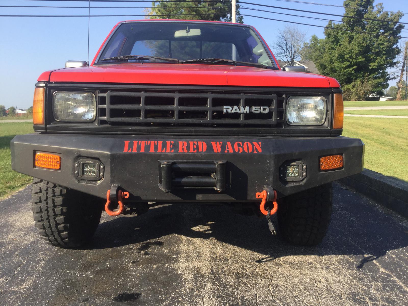

Here's what I did for my bumper. The tow hooks are on 1"x 2" pieces of bar stock that run all the way back and tie into the bumper mounts. We have a plate that bolts onto them to mount a winch. It fits in there quite nicely, if I can ever get around to buying a winch for it. That may be a little more involved than you want to do, but I hope it at least gives you some ideas!
