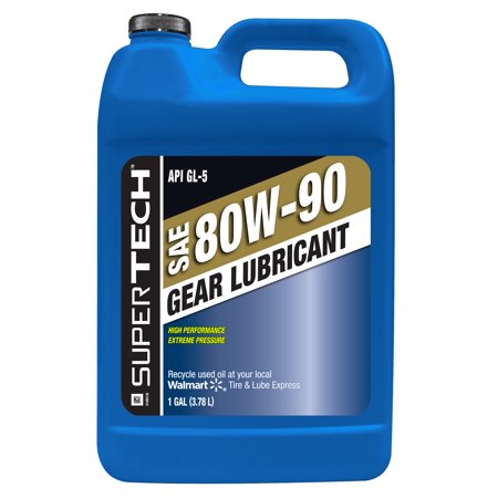

    Welcome! Here's what you need. It's GL5 rated and only $14 at walmart. After you are done filling your transmission, you can put the rest in your rear axle. Save yourself some money and pass on the Redline.

    neither - you want GL-4 manual transmission fluid. GL-5 has additives that eat the brass synchros in the tranny, and ATF is to light for these trannys. Redline makes an MT-90 that is perfect for these trannys, and amsoil has an equivalent oil as well.
    Borg Warner recommended ATF in their manual trans but it's vague about where else it could or should be used. General consensus is GL-5 has no place in these gearboxes due to potential synchro damage/wear.
