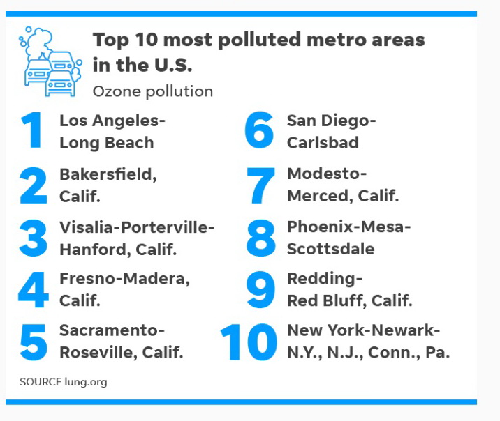

    Cali smog laws are not as much about pollution as it is about control - Cali politicians thinks only they are smart and know everything, so they will tell you what you can and can't do. Everyone else in the state is stupid and must be controlled. BTW, the pollution that causes smog is from more than cars, but cars are the easiest to punish because they don't have an organized front, and therefore don't have the money to grease the politicians palms to make this go away like the big polluters. The cash for clunkers deal was a cheap way for mass polluters to get off cheap by buying cars for carbon credits, while doing nothing to fix their polluting plants...
    ^it's got a lot more to do with trading carbon points. Companies that make a business ripping a hole in the sky buy carbon points off small manufacturers to get away with it. The gov stuffs it's pockets from both directions. Nuff said, the people in power are idiots...
    not idiots - they make out on this too by the money they get from the polluters they saved money for. Between their pockets and reelection coffers, they make out plenty...
