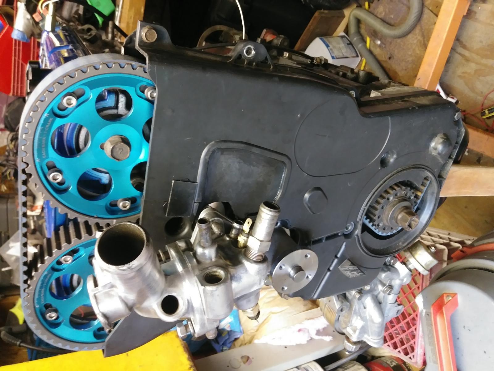

    Hi all,, just wanted to share with any who may be interested. bought this 86 for less then $500. 20180813_123511.jpg smoked like it was burning tires in all 4 cylinders, rebuilt the anemic g63b and it runs great with the weber carb but wanted more, looked for all the go fast goodies for it only to find that was not likely to happen. so,,, found me a fire breathing 4g63t 6bolt,, .20 over wisco,, 272 cams,, ported heads etc. have done a bit so far,, installed jays water relocate kit, 20180818_154145.jpg put the truck pump on,, made a new water tube 20180908_110244.jpg found that if you press off the 1g waterpump flange, drill out the holes to allow pass through bolts, and ream the center hole enough to slide on the truck shaft,, all lines up well. and cleaned up the front20180819_164427.jpg on to the intake,, drilled a hole in the front of it and welded on a true 2.5 id pipe and flange20180915_235909.jpg. needed exhaust so got a good set of headers, gt35 turbo, 40 mm external wastegate and made a full 3 inch stainless downpipe. was going to attempt the wiring, but decided to buy a standalone 1g harness. eprom and dsmlink v3 complete that. have a lsd diff to install. made a "tuff enuff" pan for the trans out of a 3/4 aluminum plate. had a pilot bearing pressed into the lightened flywheel20180915_235642.jpg am at the point where i will do all to the truck that i can to keep it a driver til i swap out motors,, install lsd, trans pan, run new fuelpump and lines, fit the intercooler ect. will post more pics as i remember to. wish me luck as my skill level is about at the minimum required to do this lol. should turn out pretty good, most of my toys do. Thanks,, Mike
    Ooooooh, very nice. Any reason why you used adjustable cam gears? And how did you go with valve clearances? I've heard it doesn't take much to get valves and pistons saying hi to each other in a bad way in the 4G63. If you can cobble together this swap then your skills are better than minimum. You have ticked all the boxes for the swap but you might wanna consider beefing the front brakes up with a Gen 2 hub and brake set up. A nut and bolt swap. If you're going to a JY look at the Gen 2 front stabiliser bar and compare it to your Gen 1. I found my stock Gen 1 was thinner on my particular model, but was the same thickness when comparing the Gen 2 bar and the one in my donor wreck. The solid rotors will turn to marshmallows if you drive this hard. $500 is outrageously cheap for a truck that looks that tidy too. Keep us up to date and whatnot

    Thank you Prescott. I used the serpentine belt pulley from the eclipse. when you try to put it on the truck waterpump, it sits too close to the block and the center hole is larger then the shaft size. i pressed off the flange from the 4g waterpump,, drilled out the threads of the 4 holes and used short bolts. had to ream out the center shaft hole, well, maybe didnt have to, but was easier to get it on the shaft without pressing on it. and tada, now the old flange acts as a spacer with the correct offset and center shaft hole size to keep the pulley centered on the shaft and belt path. as for the water tube,,, well,,, couldnt find one around here and didnt want to pull it off the running truck so i found an old jack handle that barely fit into the waterpump hole,, used a small round file and carved a groove in the end for an o-ring, drilled 3 3/8 holes where i felt they should be and brazed on the 3/8 water fittings that i cut off the 4g s giant water tube.. using a 90 bent rubber hose to turn the back corner and run to the heater core. as for jays kit,,, yup, would recommend it. dont try to drive the front freeze plug through to remove it. has a casting flash behind it that makes it not possible. cut through the middle of it and pull it out the front with a brake spoon like tool. when installed, felt like i could pull it out if i tried to do so, so a liberal amount of rtv sealant and time to cure is now rock solid. i do believe that i will drill and tap the rear blocking plate with a small fitting and run a tube from it to a fitting on the front so at least a little bit of flow leaves the back of the head to prevent stagnation.. will post more pics as i go.. Thanks,, Mike

    oh,, and you need to cut off the top part of the original now front mount of the 4g so the jays kit will clear it
    Hmm, looks like it works well. Most guys would try to swap all the pulleys and run the same V-belt arrangement. You don't have A/C or PS to worry about and it's made the belt system nice and compact. Just need a big thermofan tucked in behind the radiator now.

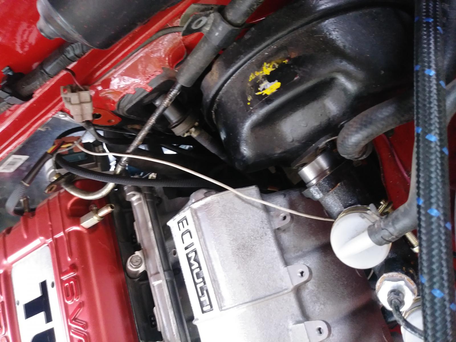

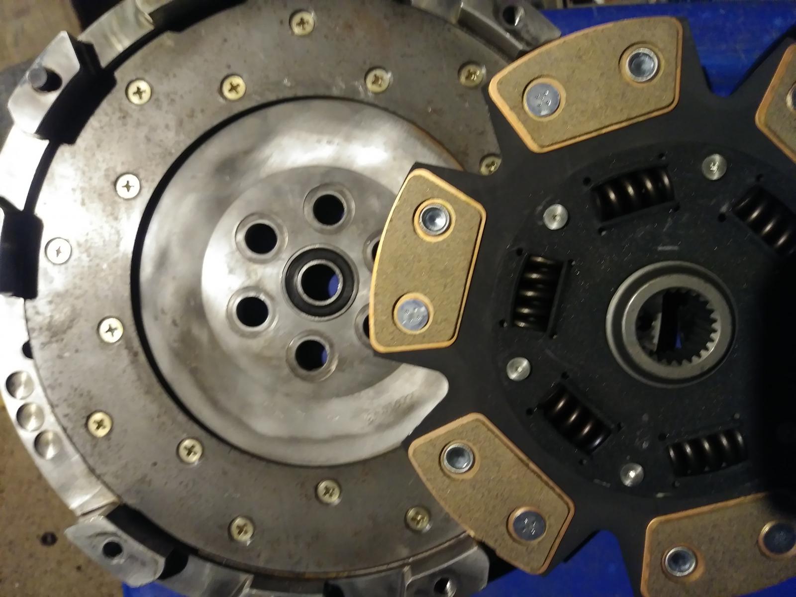

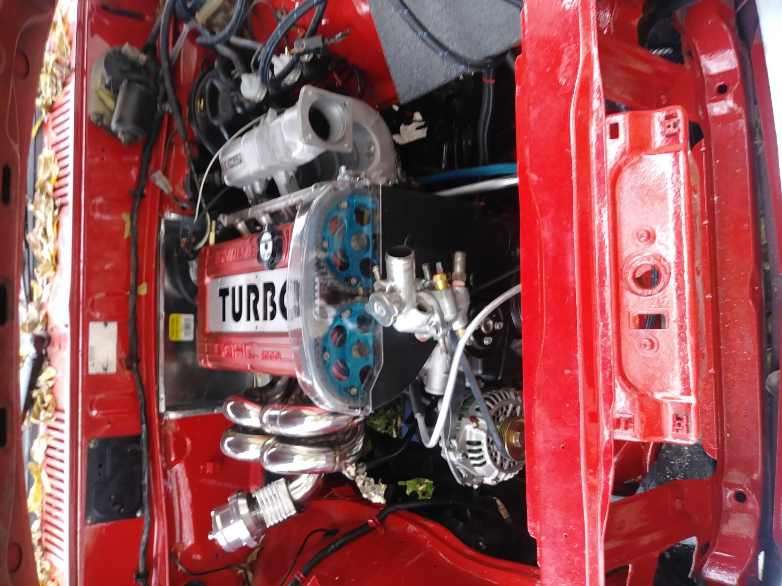

    Hi All,, been busy so not much time to update. got the 4g mounted and bolted in, clutch appears to function.20181024_171828.jpg narrowed the spacer on the brake booster and shortened the rod,, not enough, had to cut off the rear flange off the intake. pushed back the firewall 14x8.5x2inches,, plenty of room back there now. installed a fitting off the rear water plate to move some water back there. have installed the limited slip. per Geezers always good advice. it now has 2nd gen spindles with drilled/slotted rotors. all new calipers, cylinders, and master cylinder. belltech 2.5/3 drop with nitro shocks (blocks and springs). msd fuelpump with an6 lines. is still in mockup, so please excuse the clutter. ordered up the aftermarket air conditioning kit. got new rims,, 15x8 with +19 backspace. bfg radials. umm,, more stuff that i have already forgotten. been taking pics as i go. sooo,,,, all is well and fitting at this point. so will just keep plugging away at it. Thanks for your time, Mike

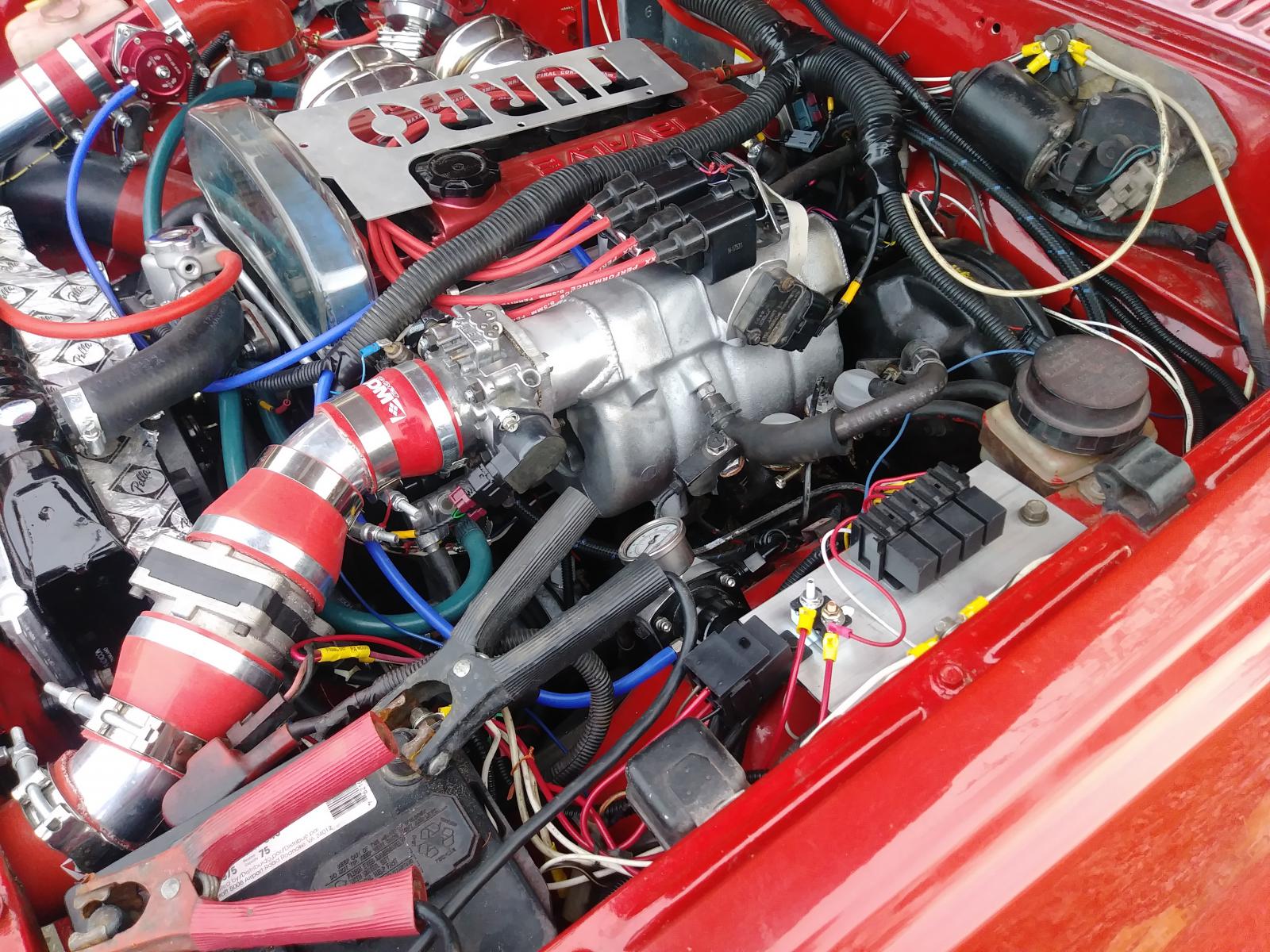

    Hi All. Been quite busy but have had time to get some more done on the red truck. am about done under the hood, need some clamps and little things but all the hard work is done. wired, plumbed and ready to go. still need to add oil, pull the plugs and prime up the oil. hook up the airbox under the dash so i can add the coolant, and a few more things i best not forget. can't believe it all fit.20190322_190622.jpg20190322_190638.jpg20190322_190732.jpg

    Damn you have been busy And I can't believe it all fits in there either. So now you've got grip from the rear end and bite at the front. Any chance you can post up a pic of the brake swap and front end etc? You've done an amazing job, it shouldn't be long before you're road test ready
