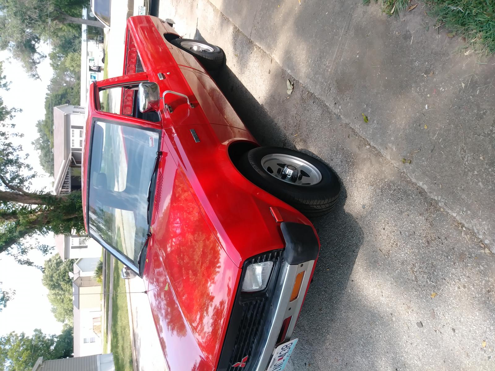

Hi all,, just wanted to share with any who may be interested. bought this 86 for less then $500. 20180813_123511.jpg smoked like it was burning tires in all 4 cylinders, rebuilt the anemic g63b and it runs great with the weber carb but wanted more, looked for all the go fast goodies for it only to find that was not likely to happen. so,,, found me a fire breathing 4g63t 6bolt,, .20 over wisco,, 272 cams,, ported heads etc. have done a bit so far,, installed jays water relocate kit, 20180818_154145.jpg put the truck pump on,, made a new water tube 20180908_110244.jpg found that if you press off the 1g waterpump flange, drill out the holes to allow pass through bolts, and ream the center hole enough to slide on the truck shaft,, all lines up well. and cleaned up the front20180819_164427.jpg on to the intake,, drilled a hole in the front of it and welded on a true 2.5 id pipe and flange20180915_235909.jpg. needed exhaust so got a good set of headers, gt35 turbo, 40 mm external wastegate and made a full 3 inch stainless downpipe. was going to attempt the wiring, but decided to buy a standalone 1g harness. eprom and dsmlink v3 complete that. have a lsd diff to install. made a "tuff enuff" pan for the trans out of a 3/4 aluminum plate. had a pilot bearing pressed into the lightened flywheel20180915_235642.jpg am at the point where i will do all to the truck that i can to keep it a driver til i swap out motors,, install lsd, trans pan, run new fuelpump and lines, fit the intercooler ect. will post more pics as i remember to. wish me luck as my skill level is about at the minimum required to do this lol. should turn out pretty good, most of my toys do. Thanks,, Mike
