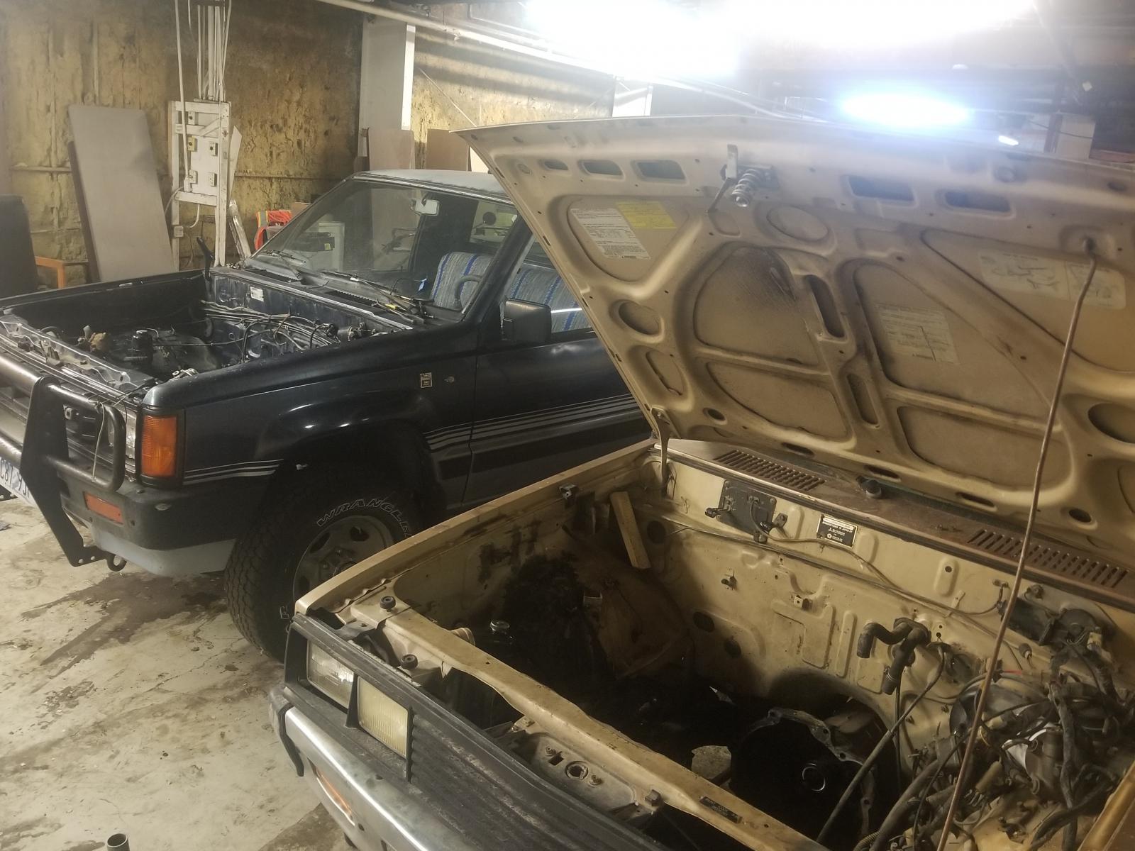

    Thanks. Here is the day I brought it home. The swap has been going well, the starter was a slight issue for me, but where there is a will, there is a way.

    First thing I did was try to get the 2.6 going. The truck was bought believing the engine was shot, so I didnt really worry too much about it.
    It is such a shame, because the engine has all new fresh hoses, plug wires, gaskets, the carb looks clean. Oh well, I suppose.
    The 2.6 was seized, and I didnt really do much to find out why.
    The diesel swap just seemed more fun to me. Plus, I think I needed the slight challenge, given my basic mechanic skills.
    Anyway, I found a first gen truck that had already had a 2.3 4d55 swapped in, but the 4x4 had been deleted, and there was no real mount for the transmission.
    Plus, the body had rust issues, and it was already a swap from a gas engine.
    First thing to do was pull the engines, of course. Josh

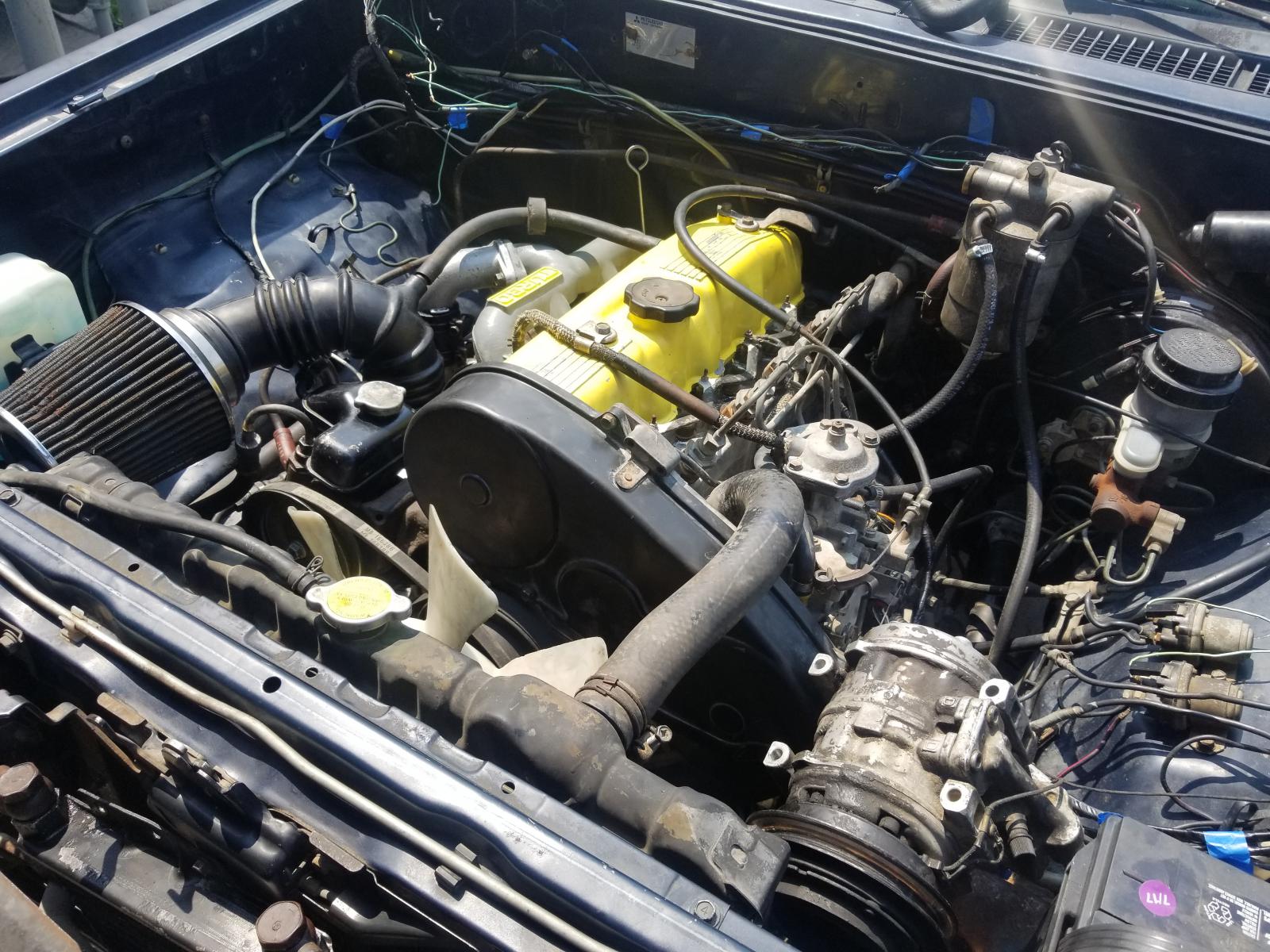

    A quick update. Got some of the wiring sorted, and the engine fired up with little problem. The 2.6 starter is giving trouble and I just finished flipping the gear on the diesel starter.
    I wasnt too fond of the glow plug controller, and decided for 12V plugs and a relay with a momentary push switch.
    To flip the starter, for me. Required grinding the retainer portion flush to fit inside the Bendix opening. It wasnt extremely difficult, but getting the retainer over the clip was angry for me.
    Purchased new tires since mine decided to be old, and basically useless(even as rollers).
    Radiator was leaking, thankfully only through the drain, and a new plug was an easy fix.
    One thing I havent changed is the fill neck. Filling it with diesel sucks because I use a long screwdriver down the hole, ugh.
    Just trying to finish the last few things before I get it on the road. Josh
