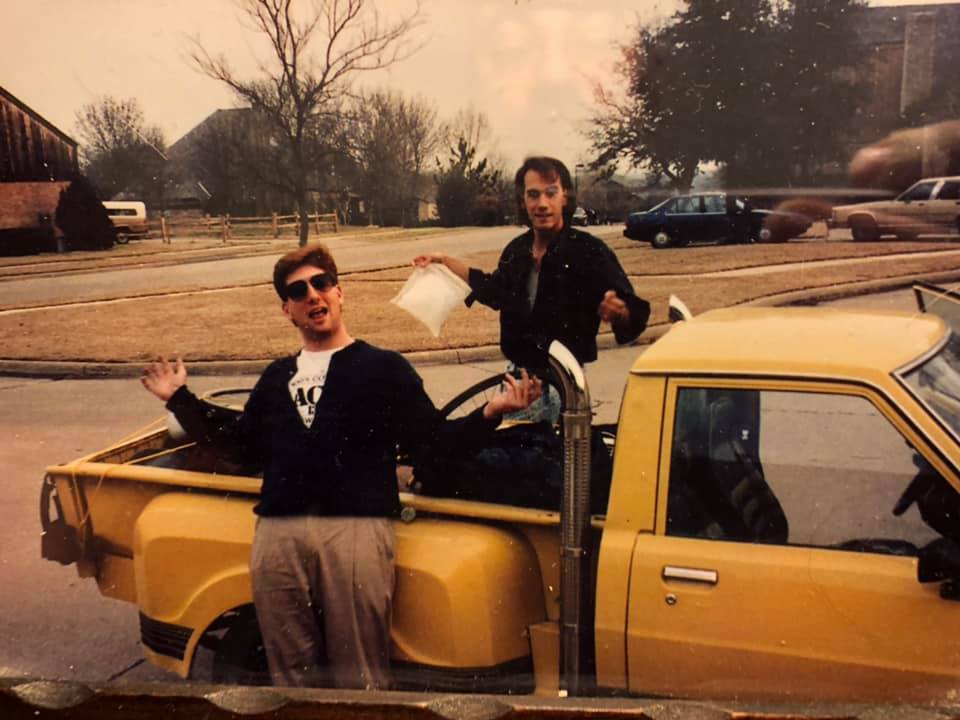

    I have and I'm the original owner of a 79 D50 sport with the Stepside conversion from the dealer, I believe it came from Bud Anderson in California but that was a long time ago I might be wrong on that. The Truck was my daily driver but it made a few car shows back in the 80s and 90s. The truck took me through my twenties/thirtys and I have lots of fun memories of that truck. I bought the truck new from the dealer with 8 miles on it, I took off the stack muffler pipes in the parking lot before I left ,yes it had the same stack as the Little Red larger Dodge.

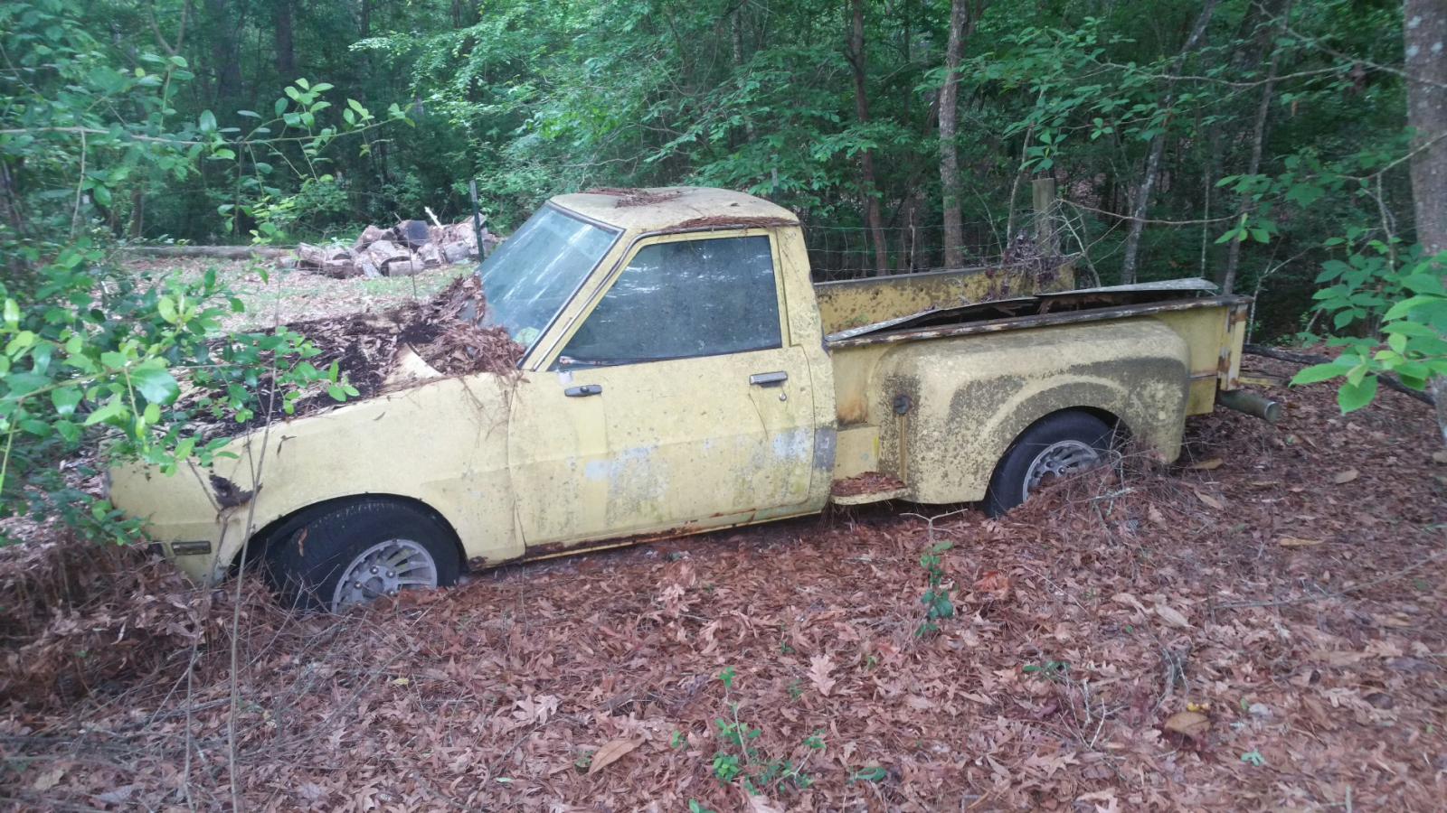

    It's lived the last 20 years up in the country sitting under a pine tree, never had a bit of trouble until about 260,000 miles. Messed up lifters and rod so it was trailered to the country. It's losing its home so I'm trying to decide what I need to do with it, has lots of sentimental value, looks like body and motor parts are available and with the knowledge from this site I'm sure it could be rebuilt,so far I can't find another one on the internet.The best I remember it was about a thousand of them made in 79 - 81 with the majority being the Tan model non-sport,I thought there was only about 80 of the 2.6 liter sport yellow models but I'm sure someone on this site would have better information on that.

    I will keep it the way it was ...the front spoiler might be a problem to find

    isn't the front spoiler fiberglas?? If so it wouldn't be hard to repair or fab up another one, I would think?? Cool truck. Do you still have the side pipes somewhere? I would think those would add to the collectibility, but lots of guys on this site know a lot more than me...

    Yes. It was fiberglass it was lost in a dark road in 1990...put a straight (non-flare) one on then..the side pipes went to a cousin for his truck..long gone now..I put knock offs on the wheels but that us the stock wheels..

    A few of these have appeared on here over the years. Yours being a sport 2.6 makes it very rare of the converted ones. Bud Anderson did make that conversion, but I don't have any info on it. If you can get it out of the ground and it hasn't disintegrated, it can be a neat truck to have once again. Those trucks do not have lifters, but mechanical rockers with manual adjustors. Jet valve failiures were a common weaknes with these motors, especially with 280k miles. If you go try to get it on the road, be sure to source a motor for the transmission type - 79 2.6 auto motors use a narrow block (12.5 inches center to center on the lower tranny bolt holes) and the 2.6 5 speed is a wide block 13.25 inches center to center. All 5 speed 2.6 motors from 79 to 89 are wide block motors. Welcome to the forum!
