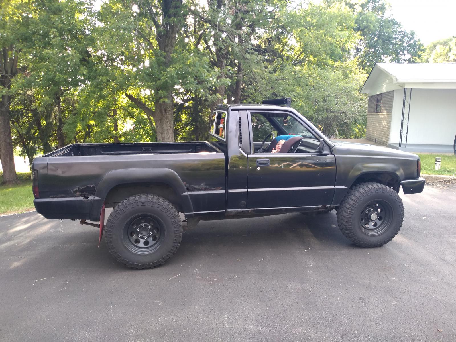

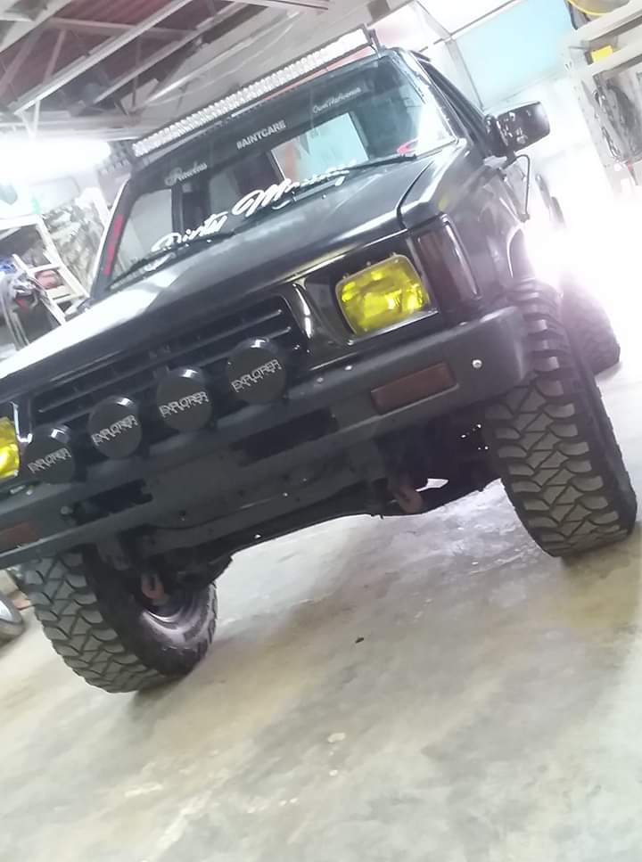

    Here is my set up. 31 inch Mickey Thompson bajas with a 1/4 inch spacer. Sticks out maybe an inch but I like the way it looks. Maybe this will help
