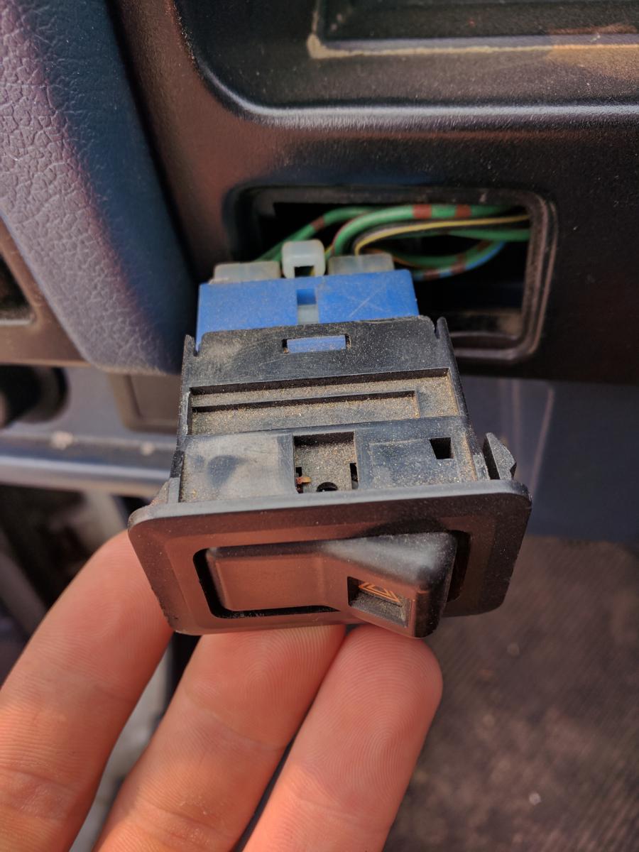

    Hey there I have an 89 ram 50 2.0, when I received the truck the hazard switch was gone and the plug cut from the harness. I found a switch but no plug, I plan to connect the wires individually to the switch. My only issue is where each of the wires go. If anyone could take a picture of the wires going into the switch I would greatly appreciate it.

    Here's the wiring in my '88. Sorry it took so long, been meaning to take these pics for a few days now.

    thank you very much!
