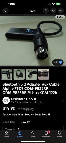

    Has anyone tried to add Bluetooth to the stock radio using an adapter like this with the stock plug in the back?
  9. #34
    05-23-2022
    74
    tucson az
    4G61
    thats only for a alpine radio.. that needs to be plugged into the back of the unit.. I dont think there is anything that will work with a stock 80s or 90s radio.. only way to get bluetooth is to upgrade to a new radio. sorry.

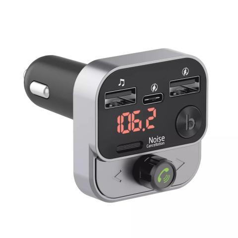

    You could use those Bluetooth adapters that plug into a power port and it broadcasts a radio signal, then you just tune your radio to that frequency.
    Here is an example of one.

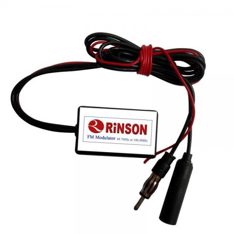

    Better yet, get a hardwired FM modulator with Bluetooth, which plugs directly into the antenna port in the radio head unit, then your stock antenna cable plugs into the modulator. The modulator taps the output signal from the Bluetooth directly into the physical antenna circuit at one of (usually) two selectable frequencies on the radio dial; here's an eBay search for them:
    https://www.ebay.com/sch/i.html?_nkw...m+modulator%22
    There's also similar, older-style FM modulators without Bluetooth, just an aux-in jack; these were commonly used to tap aftermarket CD changers into stock factory radios back in the day. IMO these would be preferable if your audio source (e.g. phone) has an aux-out/line-out or headphone jack. Anywhere you can eliminate a wireless signal in favor of a hardwired connection for audio, the better.

    I just spotted these new posts on the thread i had started and thought i should mention that there are different plugs on the back of the radios depending on who made the radio. the mitsubishi ones had a 7 pin din and the american made ones had an 8 pin din. i think accustar or something was the name of the ones used in DSM cars, they look similar to the mitsubishi ones on the face but but with black knobs and buttons and are very different internally. I think, if memory serves me that the alpine radios shared that same connector but are wired differently. i would not connect an alpine changer or Bluetooth without verifying the pinout first!

    never seen these wired in options have you used on on a mighty max radio.
  14. #39
    08-29-2016
    253
    Siskiyou County, CA
    those will work on any FM car radio with a standard Motorola type antenna connector (the kind used on just about every car radio since the dawn of time including our 80s and 90s Mitsubishis). They connect between the antenna and the radio and simulate a radio station. you just turn it on and tune to the station you set it to and you have FM stereo reception of your auxiliary or Bluetooth music. if you have ever used an older tv to play a video game its like the box that connects between your console and the tv. I have never personally tried one for myself but im sure it would work fine. another option would be to get a right angled din cable, a switch, and a 3.5 mm aux cable and make a cable to "trick" the radio into thinking it is playing a tape by opening the two pins on the back of the radio to put the radio into aux mode. This would give the best sound from a stock radio but requires making a custom cable.
