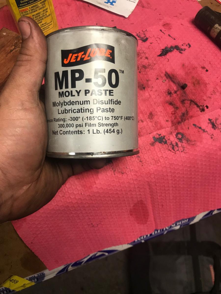

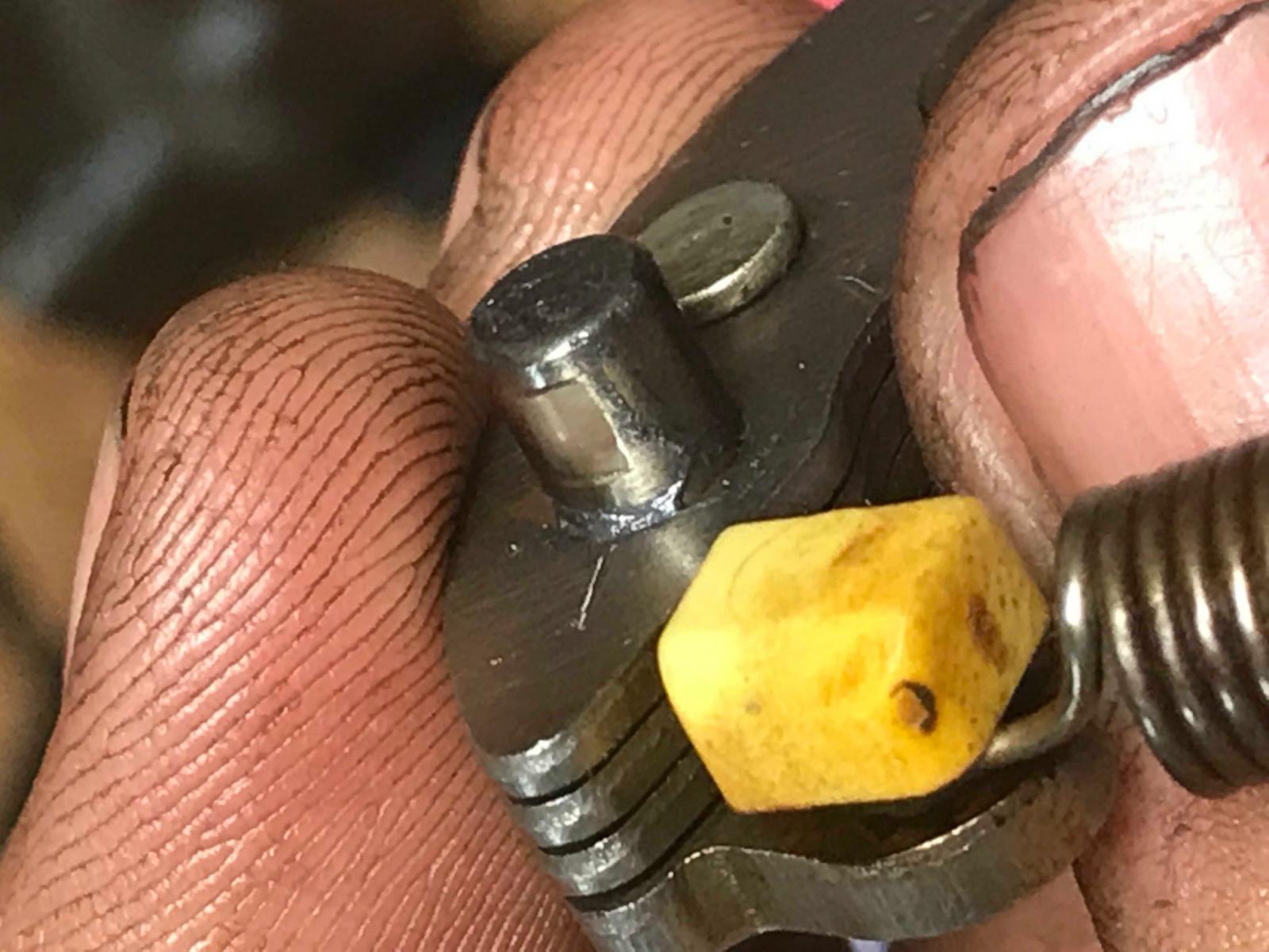

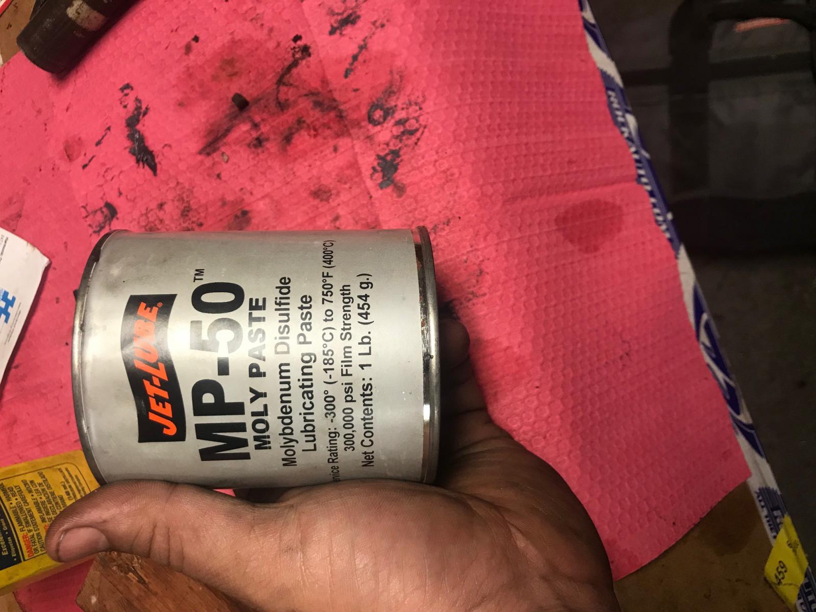

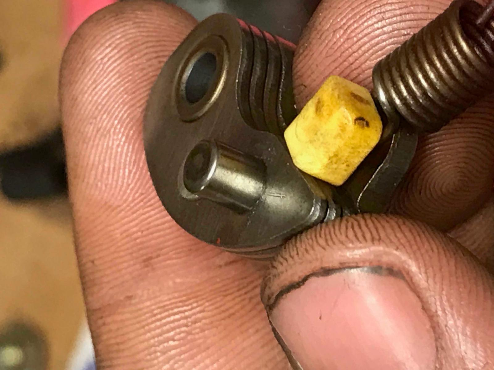

Nice - a fix that only took some CSI work to locate. There's going to be anomalies with AFR's due to all the variables in a neanderthal tech engine. It's never going to be rock solid but anything that isn't pinging or sluggish is a start
