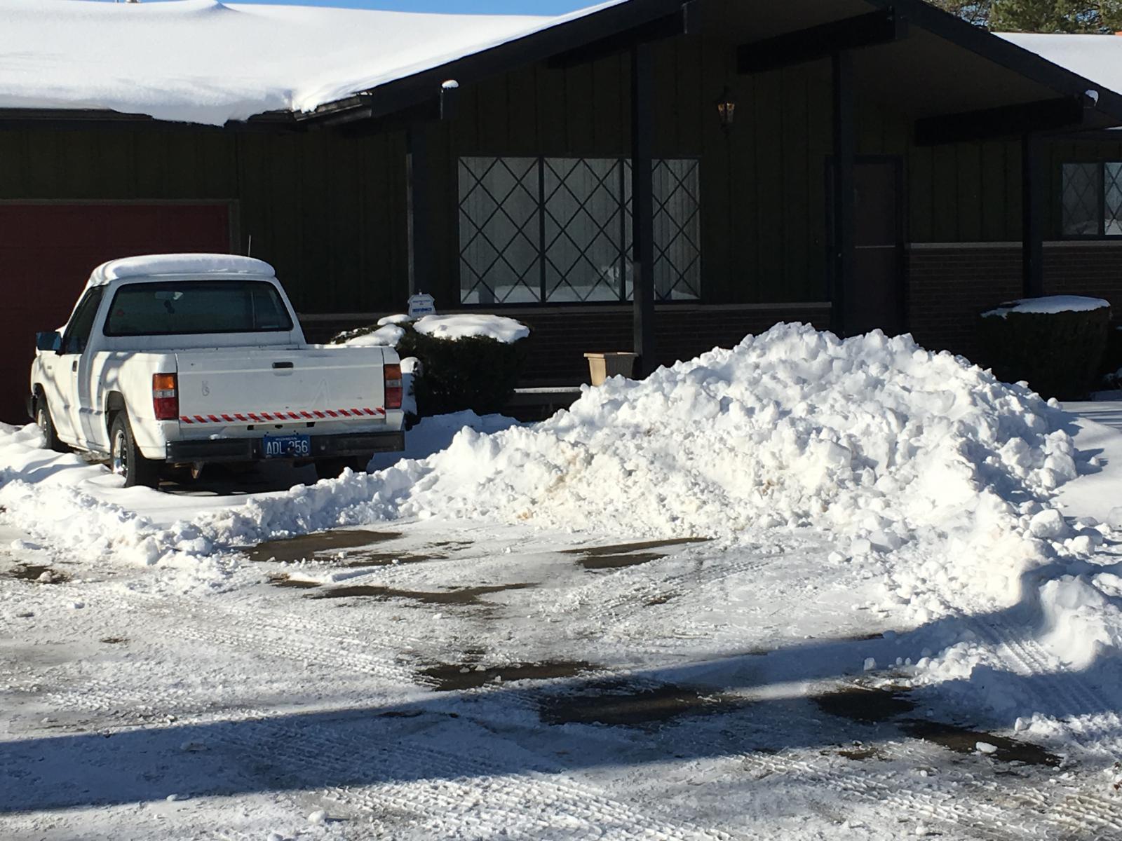

    Now you know why when we get these trucks, we don't want to part with them. I have owned Geronimo 38 years August 2nd - bought him new. My Dad said he would rust away in 5 years - it took 10, but my friend and I rebuilt him better than new and I still have him to drive when I want to.
