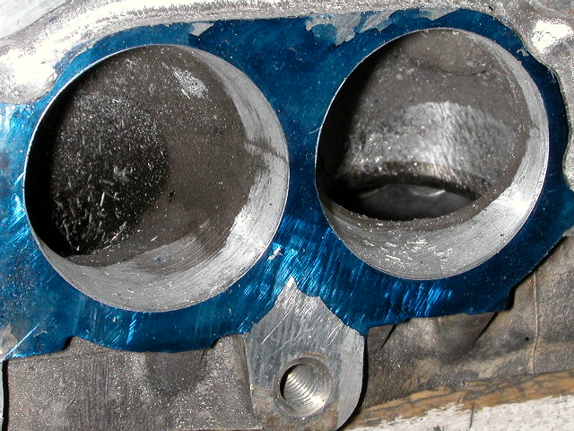

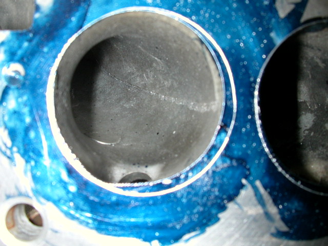

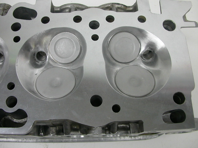

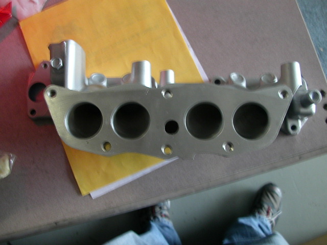

    Go the full hog and match the volumes of the chambers and port match to the inlet and exhaust gaskets.
    The small amount of work I did to my old flathead got me up mountains in 2nd and 3rd rather than 1st
    Go ahead and port match the intake side of the head to the manifold - but do NOT open up the exhaust ports. It will ruin your engine tune (there's a bunch of complex harmonics and exhaust gas pulsation going on just outside the exit of the exhaust ports - you get it wrong and it will result in crap fuel economy and loss of power) But do go ahead and and clean the ex ports up and polish the hell out of them. It will aid in gas scavenging If you have headers, get them thermally wrapped - this will allow a more aggressive engine tune. Hot gases move faster
    http://www.mightyram50.net/vbulletin...ll=1#post31683
    (links to some of my work)

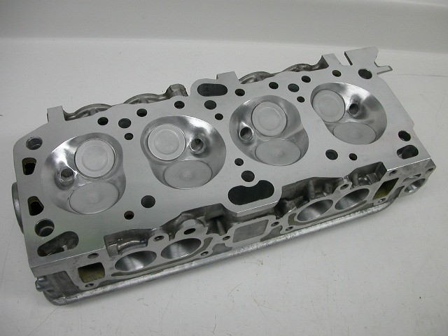

    So here's the low down anyway of why you should do it. First up - labour. This is a long process (to do it properly). When you sit down and start working a head and manifold yourself and see how much time goes into it, imagine paying a shop? Most don't want to do it. You'll get it back and it will look 'ok' if you're lucky and the bill will scare you. Then there's the 'specialist' shops that do this stuff (and some of them have earned a shiteful rep - google it. Heads disappearing, overcharging, unfinished work - if you know a shop with a solid rep and are cashed up, that's fine...)
    For the most part, newer castings are easier to tidy up. All you're planning to do is take out sharp edges, radius transitions and get the port walls nice and smooth. The intention is to make every port behave the same way - same volume of gases in and out at the same speed. It's worth the effort to get the intake manifold matched to the head. As this is being done to a EFI engine you can polish the entire intake runner and ports without the need to worry about fuel molecule drop out like what allegedly happens with a carb'd motor.
    Be warned that this kind of work won't make power, so why are you doing it? It improves efficiency and will smooth out both idle and the engine power curve. Now you can meddle with your ignition tune to dial in hidden power. And this is easy to do on a stock OBD I and II ECU. You will know when you've got it right as the engine will pull through gear changes faster, your midrange torque will be beefed up and it will show an improvement in top speed.

    Will it help if I split the intake and match the ports on the intake too?
    I'm doing it mostly to improve longevity and mileage.. not HP
    Also... this truck falls on it's face between 4200 and 5000.. not sure if this would help that
    Key word here is 'efficiency'. If you can improve air velocity into the head it will help. All of the port work you're thinking about doing is aiming at making the engine more efficient. The story goes that 'the total power/energy created is greater than the sum of parts' when it comes to engine building. A port that isn't flowing right or a valvetrain component not working at its potential robs energy from the rest of the engine as everything else is trying to compensate. If you have a look @ LSRMike's pics you'll notice that the casting shrouds around the valve guides have been completely ground down to the gallery walls - this really improves velocity and flow into and out of the head but it requires the valve guides being removed. Is you coil in good condition, exhaust flowing nicely etc? What is your tune like? Might be another reason why it's falling on it's face...

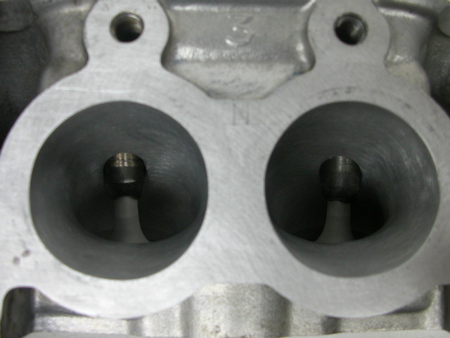

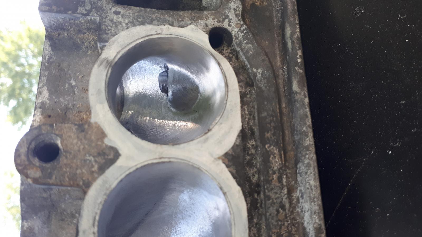

    Intake ports are almost done
    Transitions look good, casting seam on the intake gallery walls are nicely levelled out, valve bowls look like they have a good radius - good stuff
    Stick your fingers through the valve seats and feel for any sharp edges. Are you port matching to the intake manifold? You can cheat a little and just add a taper to the port so it acts like a velocity stack to ramp air speed. How long has it taken you so far?

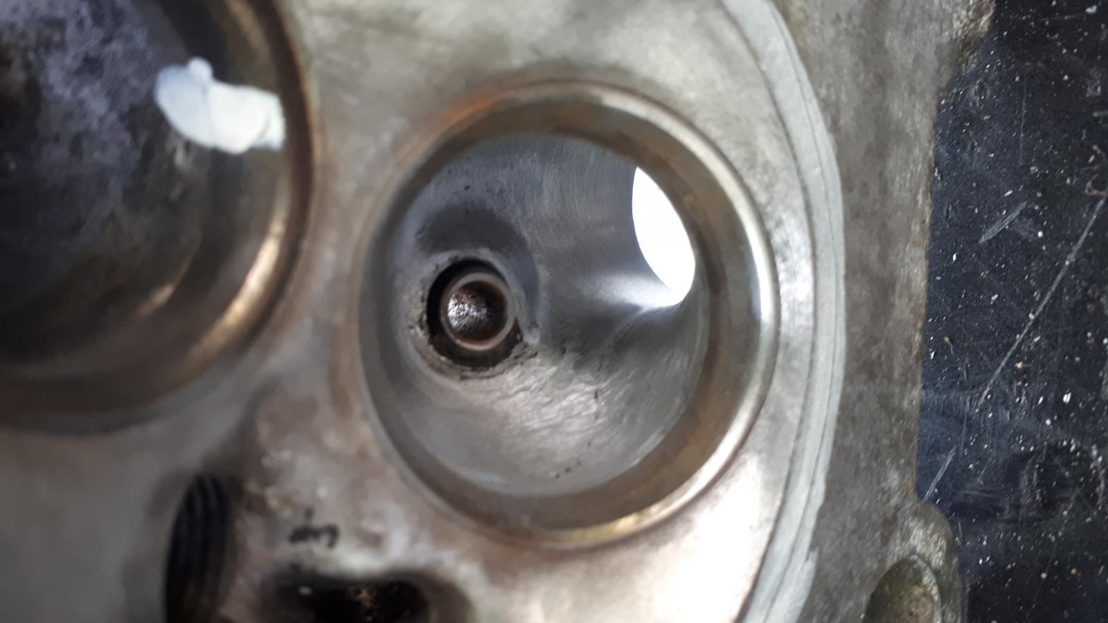

    Does anyone feel that I should take more material off near the valve guide?
    I have been using my finger a ton to ensure there is no sharp edges and everything has a smooth transition

    I am going to split the intake as I bought a gasket set anyways. I will match where things touch.
    I was thinking about tapping and sealing off the EGR in the head and intake. Since I don't drive this very often in the cold I really dont need the intake heated anyways nor do I need the EGR.
    My old Big Block Mopar picked up over a tenth when I blocked the heat cross over ( but that was in a 12 second car) so I know keep the intake cooler is certainly worth some HP.
    I am really curious just to see what the port matching and cleaning up of the ports will reward me in power. I don't expect much, maybe 5 or 8 HP... but in this little truck that is a ton.

    1,219
    looks fine to me for a daily driver.
    race car you would get rid of as much as possible and just put new cut down valve guides in each season
