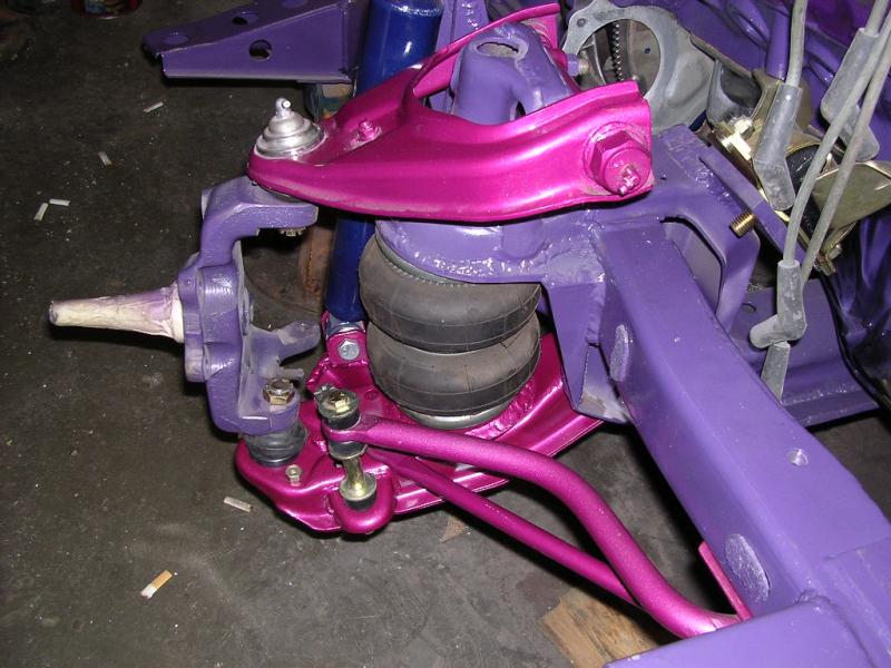

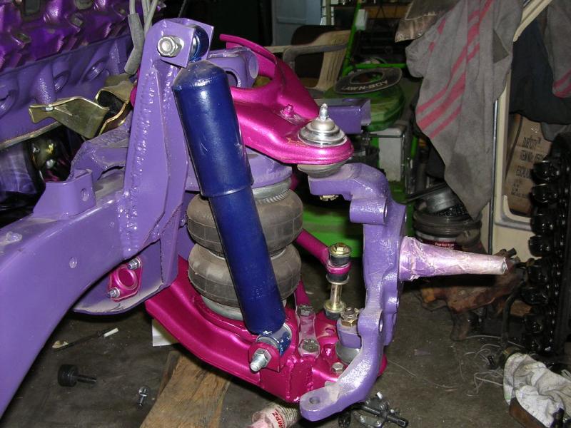

    Here a couple pic's of how I did my front air that might give you some idea's
    I hope this helps.

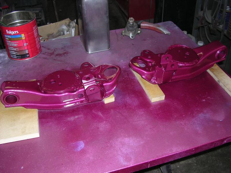

    I opened the hole in the top of the shock tower to bolt the bag to the frame mount. The air lines run from the bottom of the lower control arm.
    Plates welded to lower, with relocated shock mount

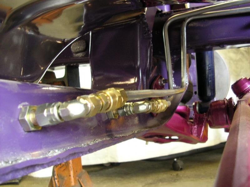

    Air lines run through the X-member and then used fittings made to go through a bulkhead
