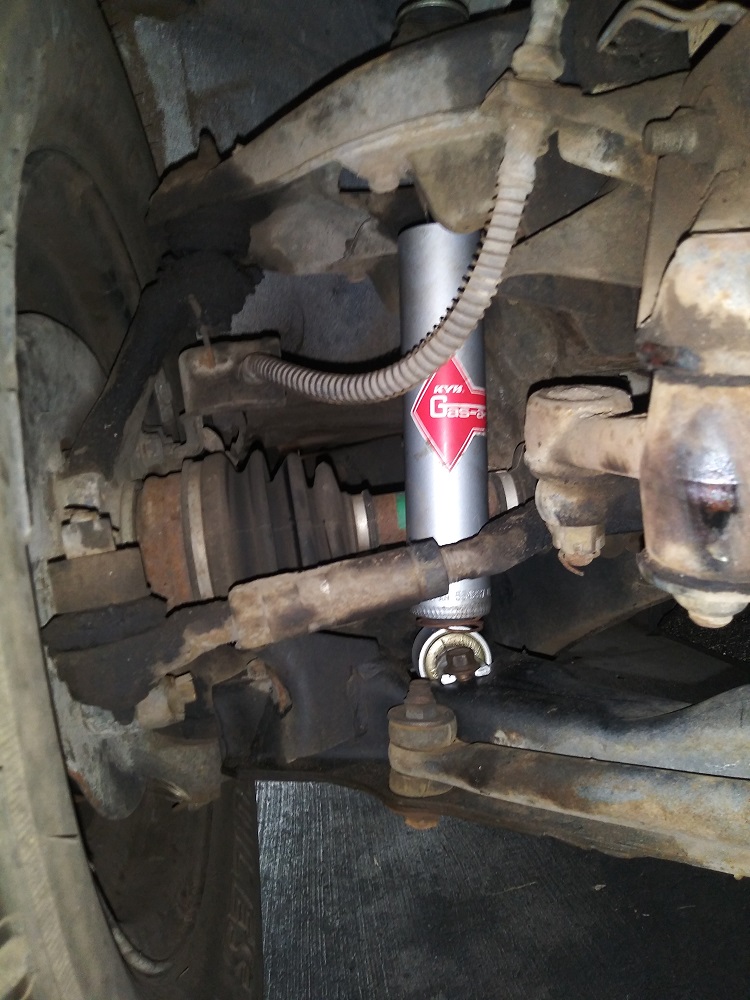

    Front KYB shocks finally installed, rears soon... I'm very pleased with the monotube performance as compared to completely shot stock shocks (try saying that fast five times) Am hoping to find a cheap n' easy way to clean the dirty suspension & steering...

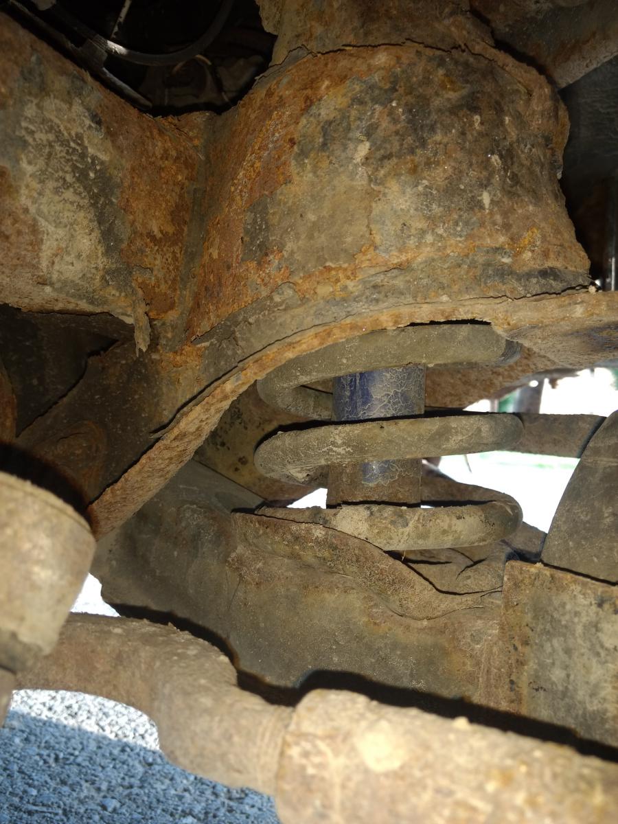

    I've got coil over's on Mine. Is there whole strut assembly I can get to make it easier to replace?
    these trucks never had struts - not sure how you would convert it unless you got suspension from a Montero sport.

    Are they mounted separately then. I can just remove the shock from the truck itself? I plan on getting all 4 shocks replaced next month. Just want an idea of what to get for parts.

    Mine are a lot different than yours.
    you are 2wd - those are regular shocks then.

    They come right out of the bottom of the control arm after unbolting it? Is there a link in the forum somewhere I can get more info.
    There are 2 retaining nuts on the top of the spring tower as well (one if it's been replaced already depending on the shock and the guy who bolted it up) - it might put up a fight and you will need it off the ground so you have enough clearance to drop it out.

    You're right, lots different, front torsion bars on my 4x4 truck... Rears might be same, who knows..? Got the rear shocks installed today, old ones completely worn out... Ride & handling improved even more, should not need limit straps IMHO...

    Yeah, mine look like they're original. So I can only imagine how much new one will help. Lol. Thanks for the info. I just like to make sure so I know what I'm getting into. They shouldn't be too bad. It's got some surface rust too. But it is in northern NY. Which I don't care for. Yours looks really clean compared to mine.
    The front have I stud on top of the front shocks, and 2 nuts on the lca for each shock. The rear have a nut on a mount for each end of the shock. Be ready for a dirt and rust shower with those shocks.
