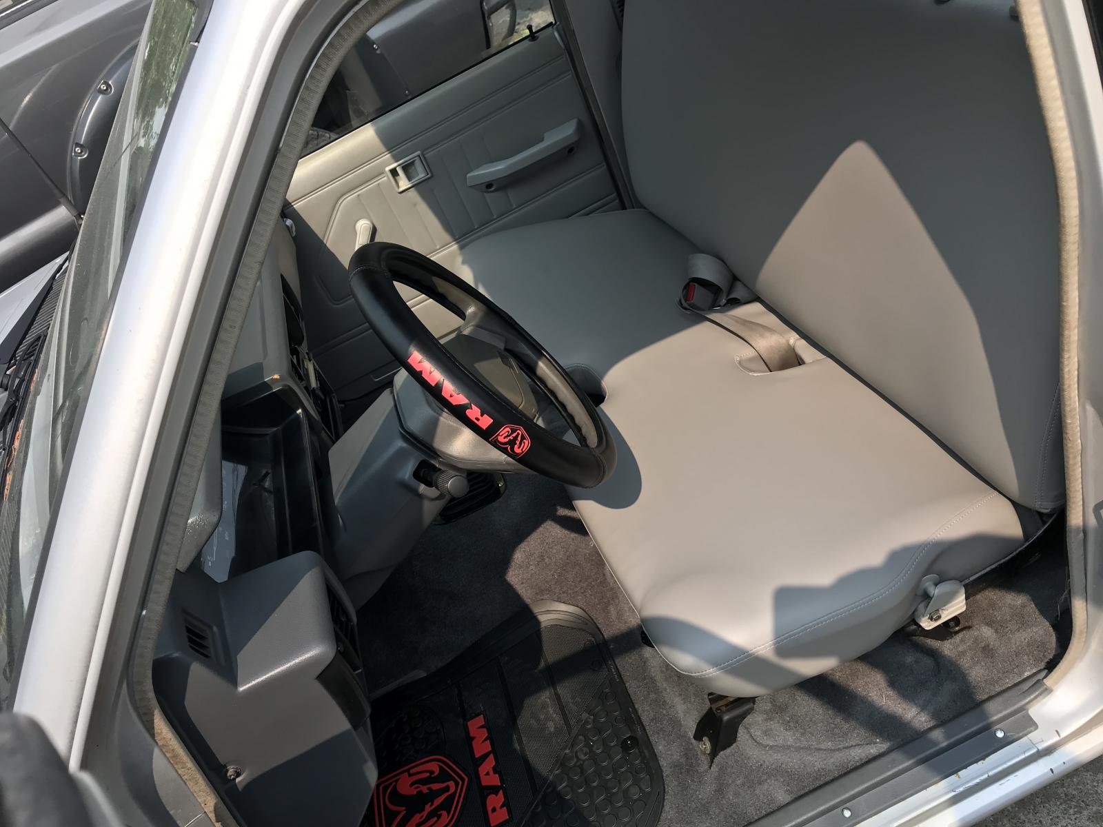

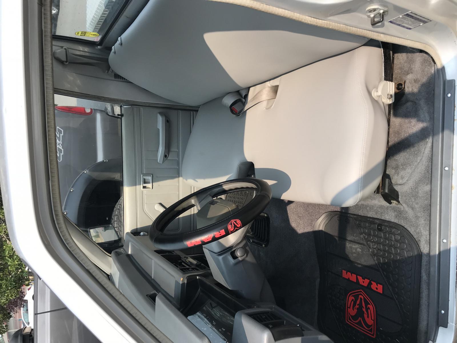

    Well, finally wrapped up the back to serviceable condition project:
    The reupholstered bench seat came in today and she's officially race ready!
    Overall I've done a lot:
    Plugs, wires, cap, rotor, thermostat, tstat housing, battery clamps, coil, belts, 95 amp alternator, wipers, rear brakes, front brakes (all new), front wheel bearings, shocks all around, sway bar links/bushings, tires. Also coated the skid plates and wheels with bedliner. Changed every fluid and filter on the truck (yes even the blinker fluid). Lastly, upgraded the headlights to Rampage H4 headlights.
    On the interior we dynamatted the floor, roof, and back wall. Added some spray window/door foam in the holes to help minimize noise. Made a new back wall panel, installed Infinity Reference speakers and a Sony single DIN media receiver paired with a 8" powered sub. New cab carpet and a heck of a lot of cleaning.
    Still on the to do list: Bedliner, ashtray, LED fog lights, back up lights, Class III hitch, window tint, and under rail bed lights. Also looking at a new exhaust and muffler with a Cat delete.
    She's a beast!

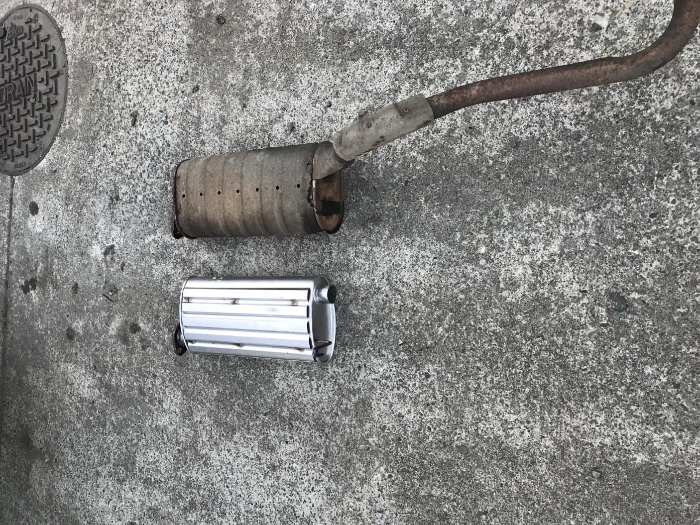

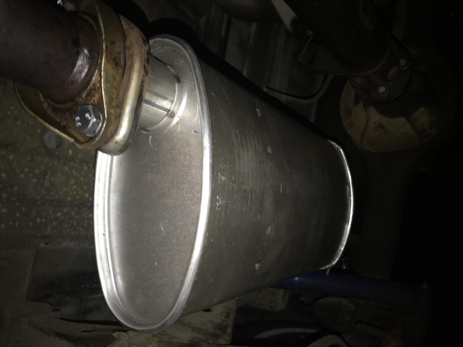

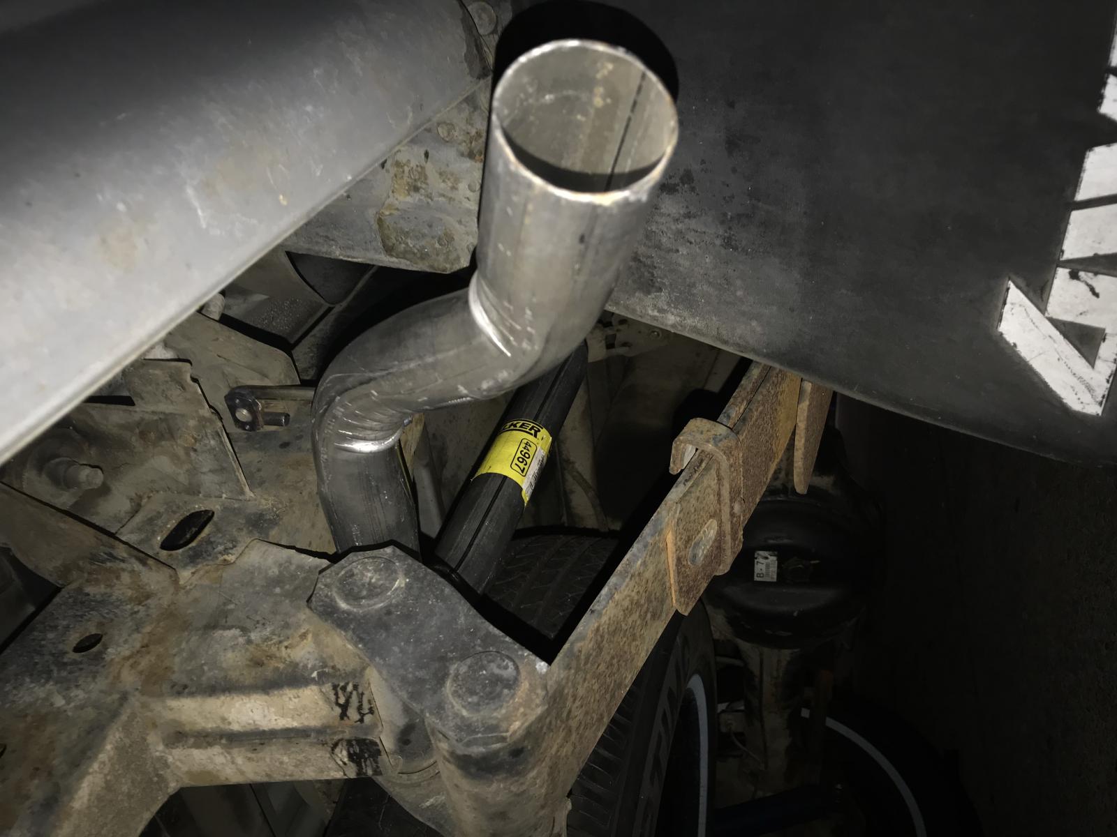

    Cured my rattle and noisy exhaust issue today...
    bolt on walker muffler and tail pipe!!! All in with an hour of work and just under $90
    She may not make a fast get away, but she can make a stealthy escape!!!!
