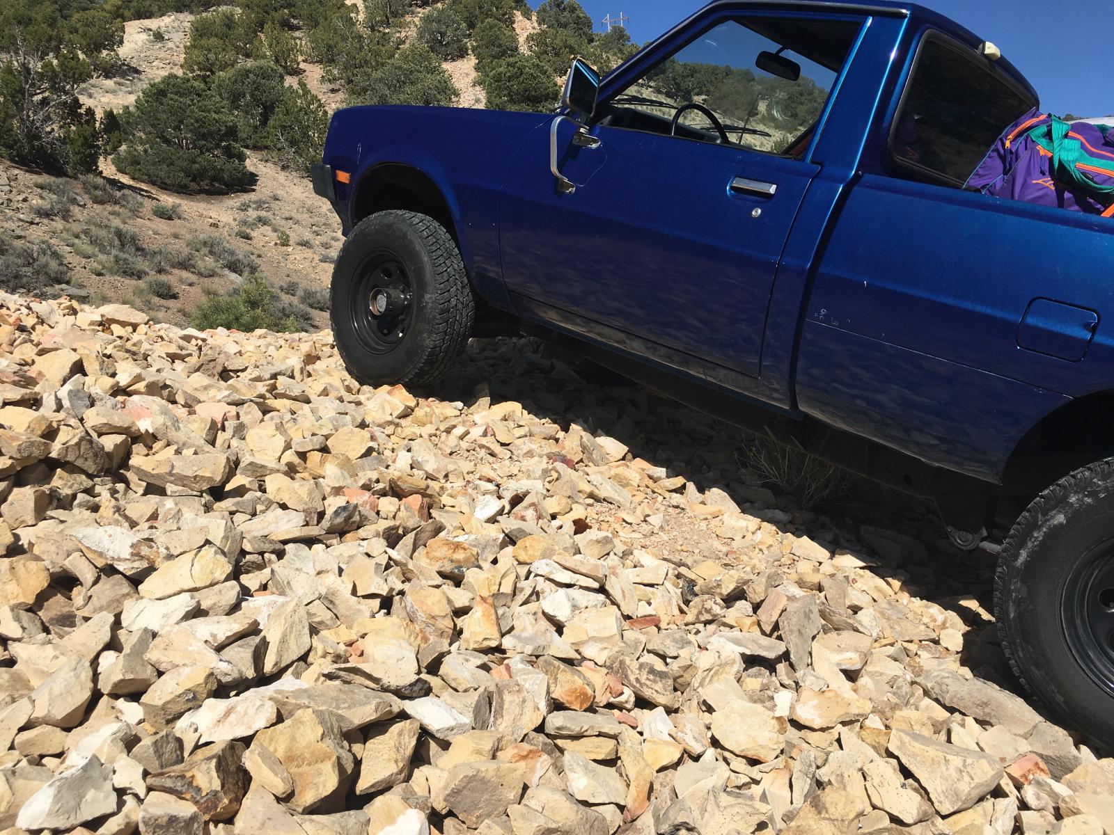

    Hey, everyone! I'm Scott. I picked up this D50 about three months ago, but have been lingering on this page for a while now. I figured it was about time to introduce myself.
    This thing has been pretty rock solid despite my best efforts to kill it. I hoped that the oil pressure switch would have warned me, but it didn't and I started it with less than a quart in it and blew the rings.
    So I was lucky enough to find a guy about 20 miles from me with a few Plymouth Arrows and I talked him out of one of his spare engines that thankfully was the "wide block".
    After I did the swap I posted my first question here and Giovanni was a huge help (thanks again)
    Anyway, just wanted to show off a bit and say hello!

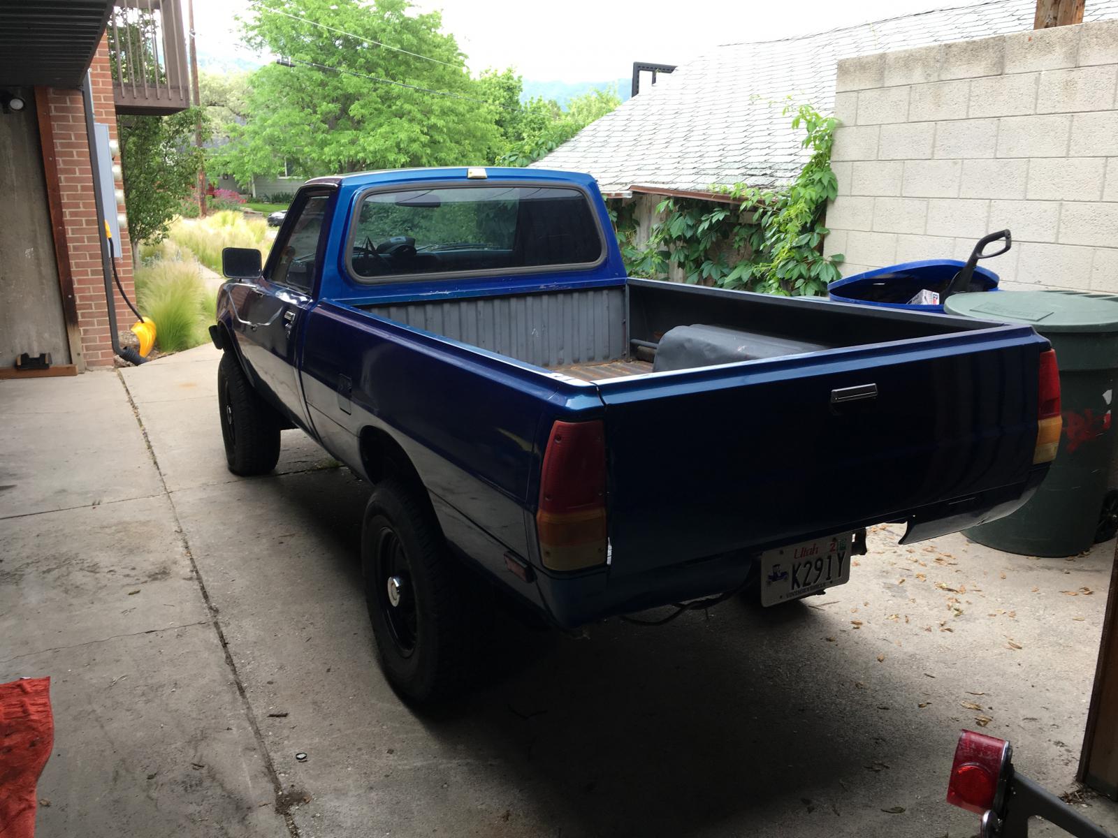

    Thanks Geezer. I guess I forgot to add the pictures of the bad paint
    Just some cracking bondo.
    ...a picture tells a thousand lies lol. If you can find a decent hood just hit it with some satin black paint. Good for killing glare when you're hitting the dirt. It definitely looks like enamel. My paint started doing that (maybe from lack of hardener, I dunno ) but it looked spectacular when I first did it. This paint is a PITA to fix too, NASON seems to have a issue with matching it's own paint (bought 2 cans of the 'same' colour, one had a green flip in it, the original was purple - go figure...) That aside, you've got a cool truck

    And Geezer, I wish that was the hood, but sadly its the roof. I could just paint the roof black. That wouldn't look that weird. I was just gonna try and pull the cracking off of the door and smooth it out the bast I could and do a black circle and both the drivers and passengers side to make that look less weird.
    Quote Originally Posted by scottadams14 View Post
    That's what I was thinking too Pennyman. I'll get under there tomorrow and take a look.
    Damn, I should've seen it was the roof (no hood line ridge) I got a solution - sunroof! No bondo (that has got to be hiding some rust), no repaint. A black roof will cook you in summer but the tilt up sunroof will do the opposite. Trucks came with a sunroof option too. Good if you don't have A/C.
