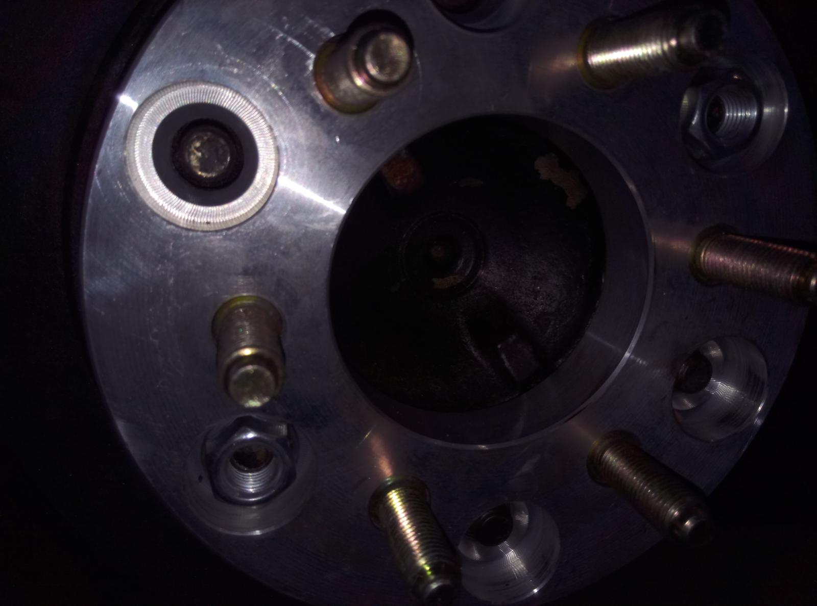

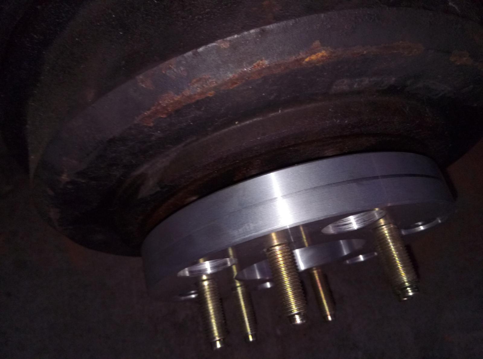

    pa
    Ok test fitted the wheels with adapter s today. Front will be fine but I have to grind down the tabs to make them fit flush. The back drums center hub is a little bigger then the center hub punch on the adapter so it sits out about an additional 1/2 inch or so. I don't want to mess with the rear center hub seeing it holds the drum on. Any ideas???
