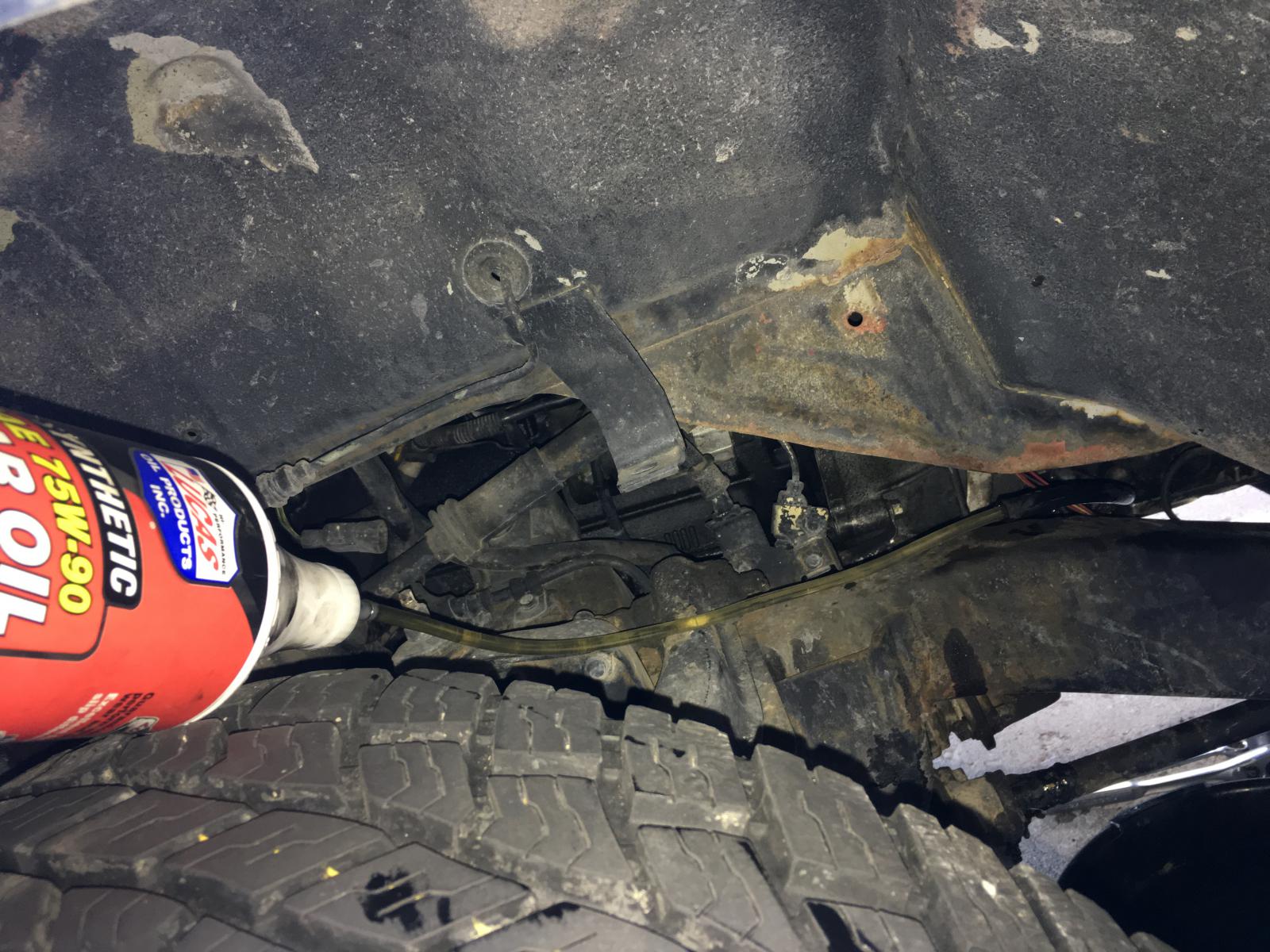

    Pulling the shifter ended up being big pain as well, so this is my solution. IMG_0083.jpg

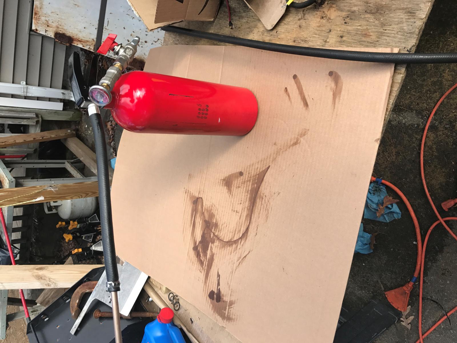

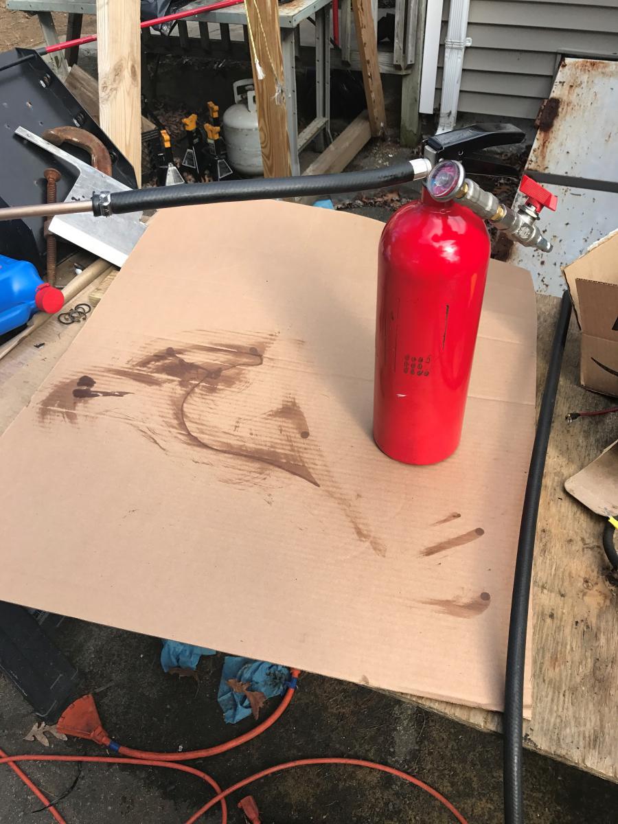

    I used an old fire extinguisher. Unscrewed the top and washed it out really well. I removed the pressure gauge and put a t-fitting. One side of the t has a ball valve and an air coupler. The other side has the pressure gauge. This particular bottle was made of aluminum. Fills the rear axle in about 15 seconds with 80w90.
    You unscrew the top, fill it with oil, screw the top back on, connect an air hose, open the ball valve to pressurize, close the ball valve and disconnect the air line. You are then ready to dispense. I ended up putting a curve in the metal spout at the end of the hose so that I could direct the oil downward as I was filling.gear oil dispenser.jpg

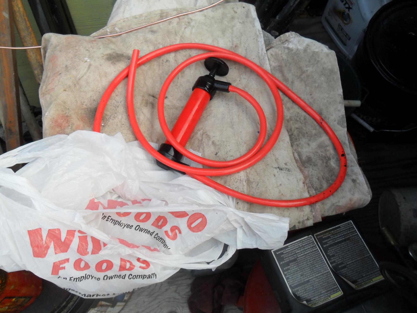

    Oil Pump
    This is the pump I used:
    Works okay. I would recommend a longer hose and clamping the clear hose to the nozzle. It will come shooting off from the nozzle if you don't clamp it to the nozzle. You'll also avoid scrubbing off the oil from your hair.
    This is what I used to do the trans oil. Pumped right out of the bottle. You can pour direct down the hose too. I figure it will work on the differential as well. It was only $8 give or take a couple dollars. I got it at a local parts store cannot remember which one.
