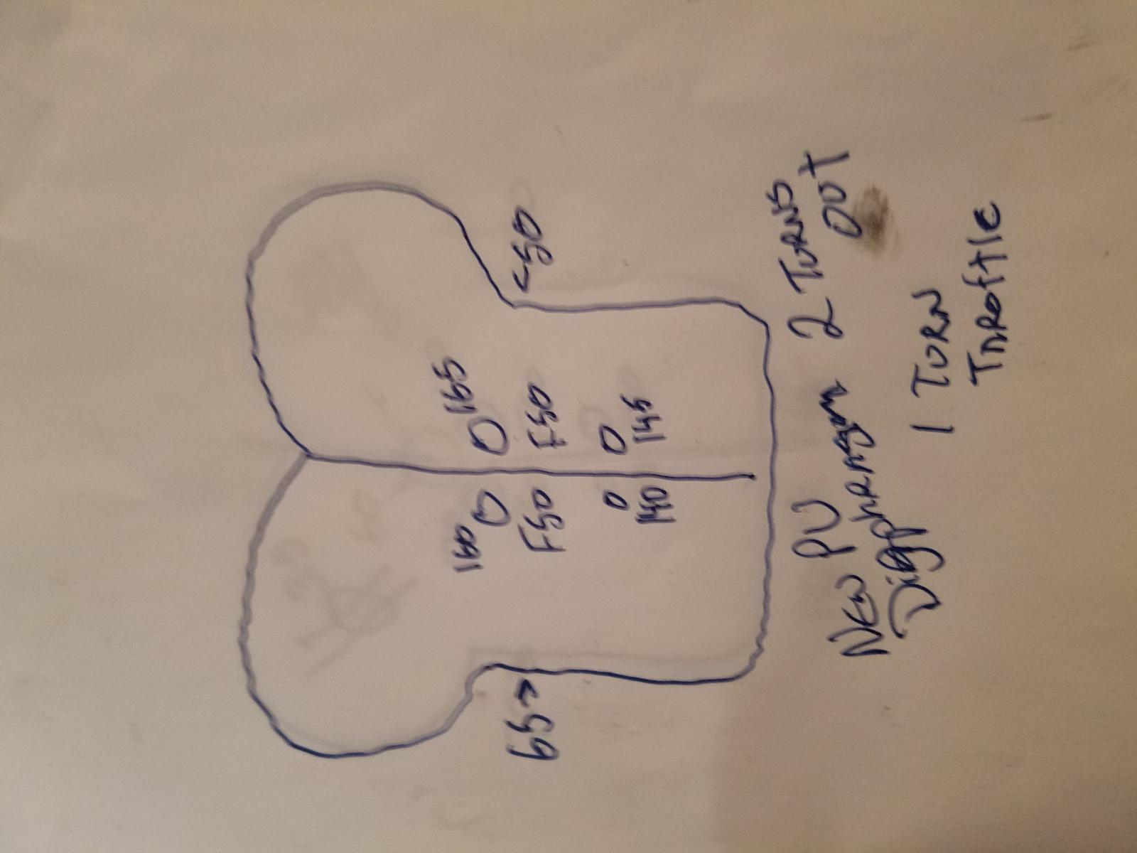

    I appreciate the feed back I'm hoping the power valve diaphragm will fix some of my issues. I may have went the wrong way with my jet selections. But I did get the coolant hole drilled and tapped.

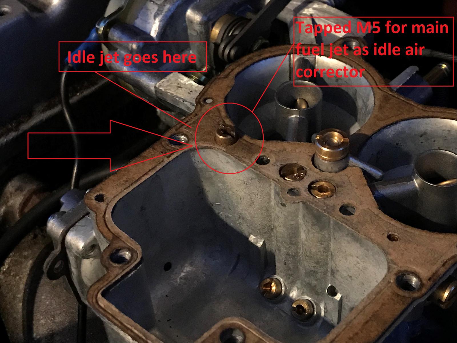

    This is a photo of my idle air jet setup. Not shown is that you have to grind some relief in the top cover of the carb so that it will fit over the head of the jet.
    A word of caution, bolt the carb down to a drill press or milling machine, and use a depth stop. You are intersecting the idle fuel jet hole. When you break through the cross hole it will lift up the carb and if not bolted down could cause some carnage. You are kissing the top of the idle fuel jet seat, so carnage could mean that you idle fuel jet will not seal rendering the carb body useless unless you can re spot the seat. Use a bottoming tap, and watch from the idle jet hole in the side of the carb body. You don't want the tap to to chew up the idle jet seat, which it will do if you go too deep.

    Agreed on having an O2 sensor and gauge installed. Helps even with minor stuff like setting the base A/F mixture. You ever tried polishing the throats and cutting back overhangs and ledges in the carb body?

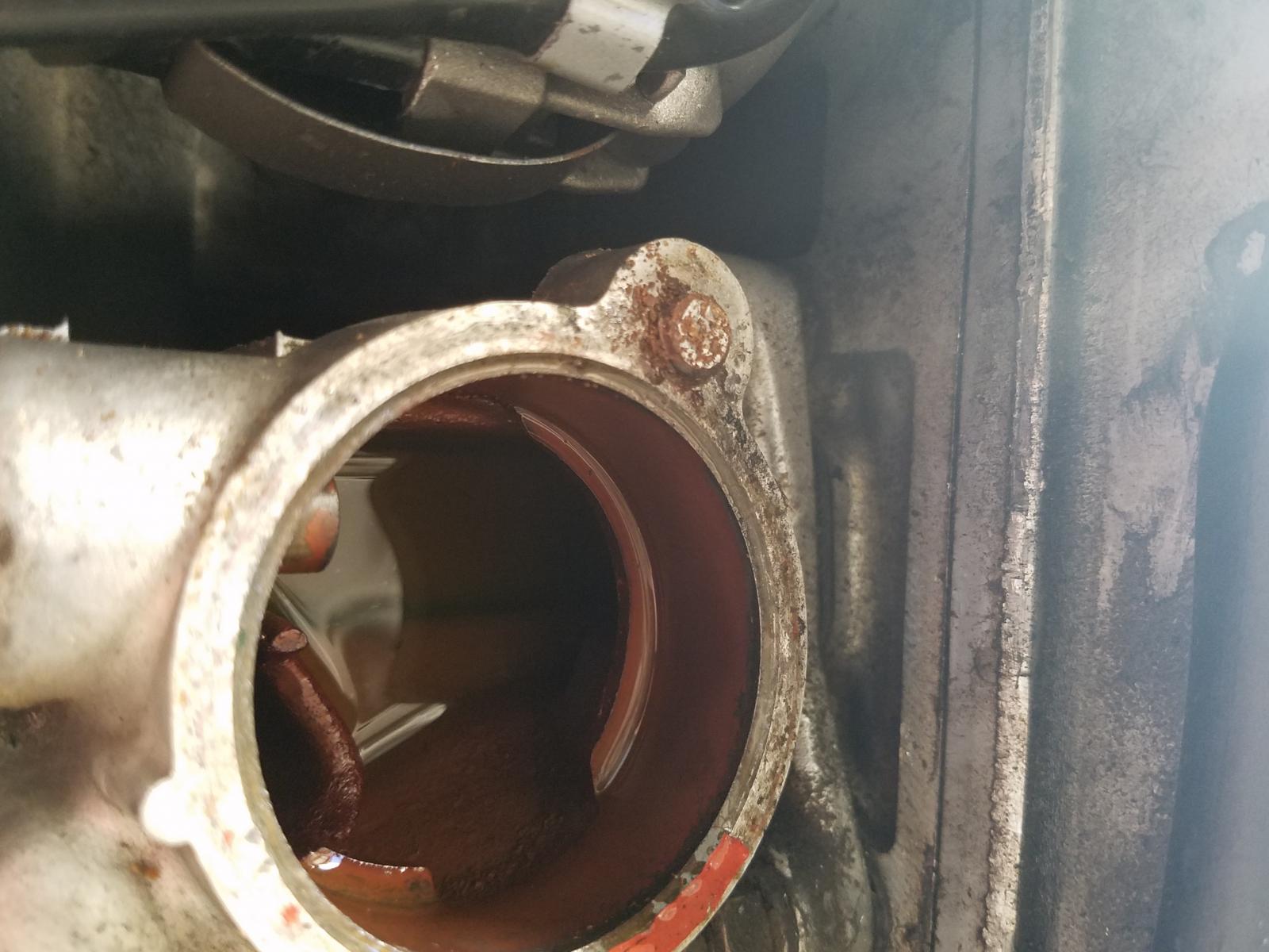

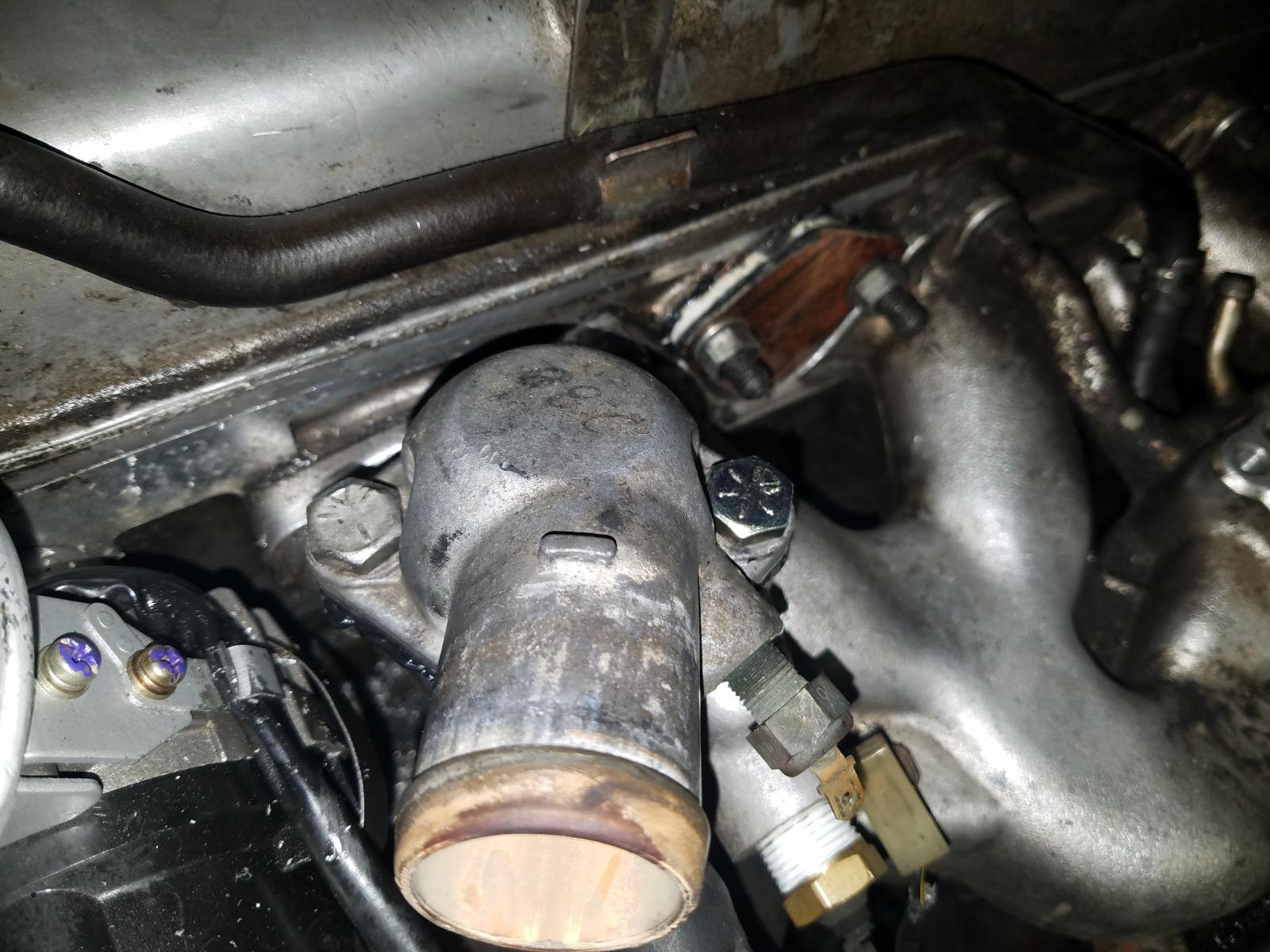

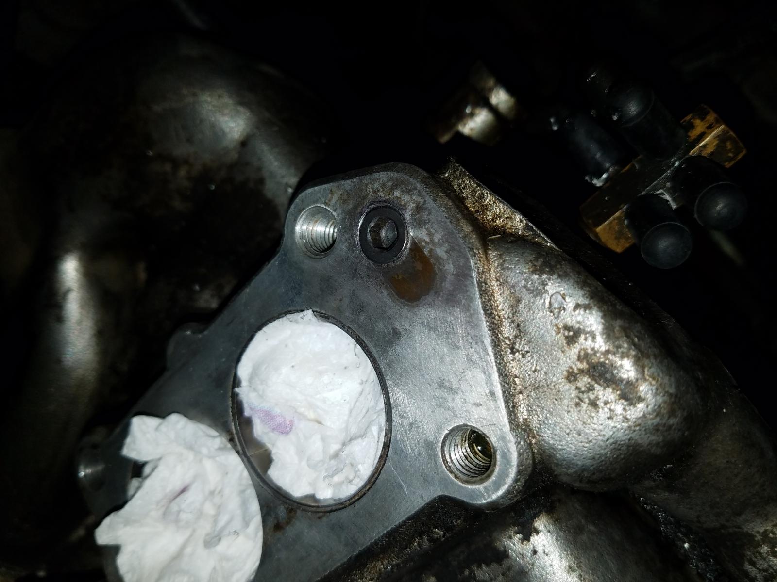

    Dang, seen that before A drill and screw extractor might get it out, or drilling it out enough to break out the last fragments of the bolt and making a pass through it with a thread tap. Fingers crossed this doesn't turn into a major headache.
    08-31-2018
    56
    Smithsburg, MD
    I had the same thing happen. If you have enough thread for half a turn of a nut, welding the inside of the nut to the thread worked for me. I also saturated the threads with break free before welding. worst part for me was the PO stripped the threads on manifold on the other side and used a bent head bolt tapped up through the bottom to "fix it". That was an unpleasant surprise. I had to tap and helicoil new threads in. good luck with your repair, you've been doing a great job on it so far-Keep it up!
    1,219
    Forget the extractor. It will just snap out if that stud is any tighter than finger tight.
    Either put a nut over the reminants, and weld them together and unscrew. Or centre punch and drill out with a sharp bit until the hole is just equal to the threads, then pick them out with a pick.
    If you do snap an extractor off, grind it flat, punch it, and drill out with a new cobalt drill bit and retap

    Extractor was a no go. Started cranking on it and heard the bad tink sound. It didnt break off but the extractor is junk now. So now its drilled thru and waiting till I buy a tap.

    Could go back to sleep this morning so I went out and threaded the hole and put everything back together. Still waiting on carb parts to get back to my original project.

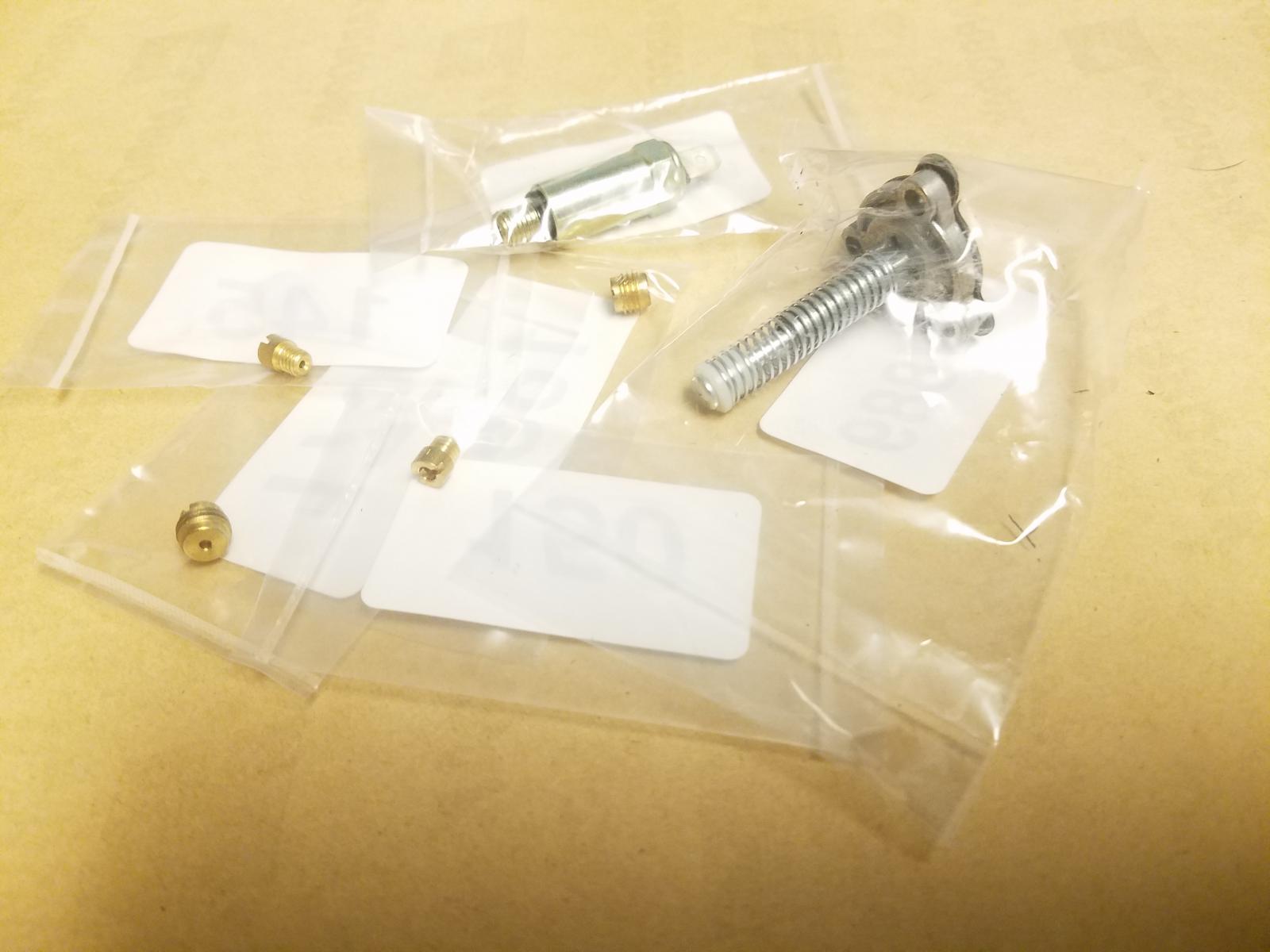

    Carb parts finally made it in.

    Got everything installed changed some jets helped a little but still to lean while cruising in 4th and 5th and when u get on it to speed up it leans out from 2500 rpm and up til I let out when it gets around 17.0 on my afr gauge.

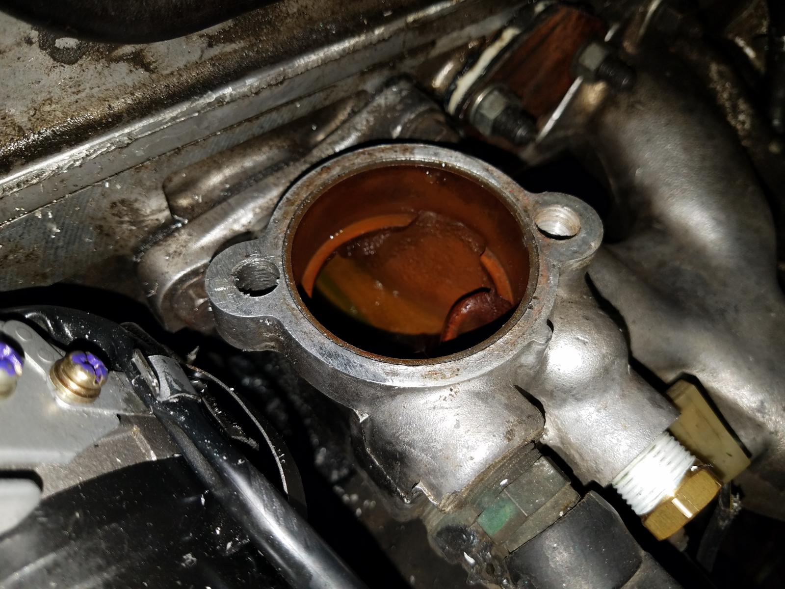

    Cooler thermostat didnt help either. Still getting hot after about 20 mins. It will cool down once u get moving but as soon as u slow down it will start climbing back up.
    1,219
    Cooling down when moving tells us that either the radiator or fan isn't up to scratch.
    I don't recall if you replaced the rad on this, but if not it could probably do with being taken to a shop for rodding out to clear the tubes.
    You will probably find that 30 percent of the tubes are gummed up.
    Also check that your fan is still in one piece, i.e. it hasn't lost any of its blades, and that the clutch is activating. I.e is it turning at a good speed at idle when the truck has warmed up? If not you may need a new fan clutch, or swap to an electric unit
