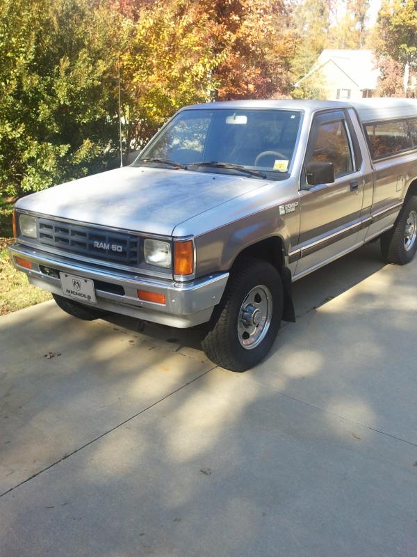

    Nice forum...glad its here....I Just purchased a 1987 Dodge Ram 50 4x4 with power steering and air. Zero rust and orig. paint (two tone silver) It has 170,000 and the owner had all maintenace records up to 160,000 including oil changes. I purchased it not running and seems to be a great truck but it does not run unless starting fluid was used. The fuel pump was bad and then stuck when it was being removed. Found the intake rocker broken at the air jet? Does anyone have one of these? Is this common for them to break?
    Welcome to the site, and NICE truck. It is becoming more common to see the rocker arms breaking right there, find a new(/used) one and you should be fine. Do you have a 2.0l(g63b) or 2.6l(g54b)? If you don't know there is a silver plate on the firewall that will tell you or look at the timing belt/chain cover on the front of the motor. If its a plastic cover its a 2.0, if its metal its a 2.6. Fuel pump should be too hard to replace, its mechanical and on the intake side of the head.
