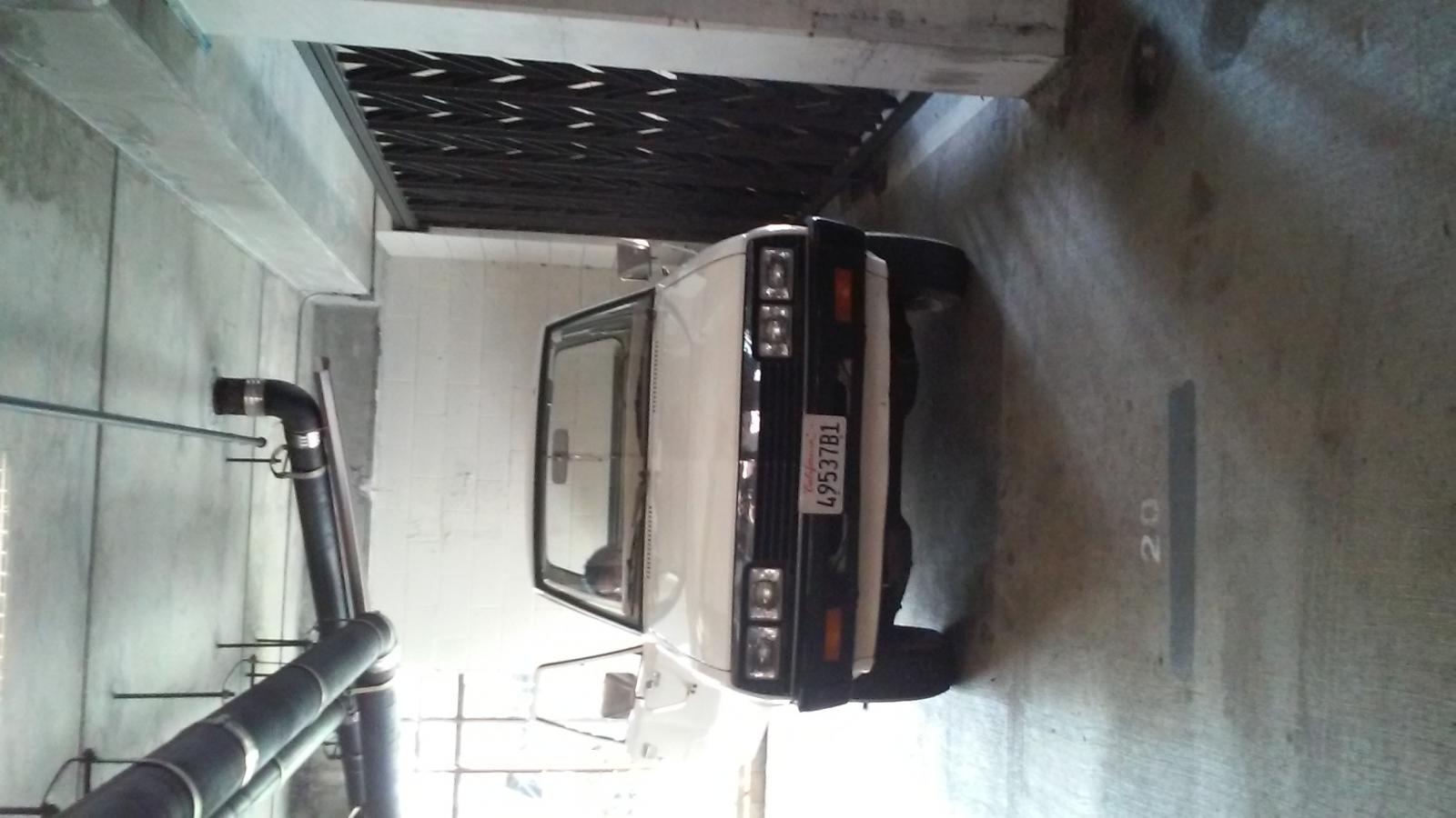

    1st try photo
    Hi and welcome to mightyram. Sorry to hear of your brothers' passing. Sounds like you and this truck are already building a backstory. Yep, get a head without the jet valves. Are you planning on swapping the carb and doing any other mods to it? It looks really clean in your pic (and on Cali plates?) so hopefully Hawaii doesn't have smog regulations to have to adhere to.
