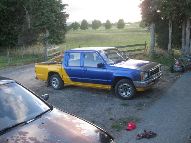

    hii all

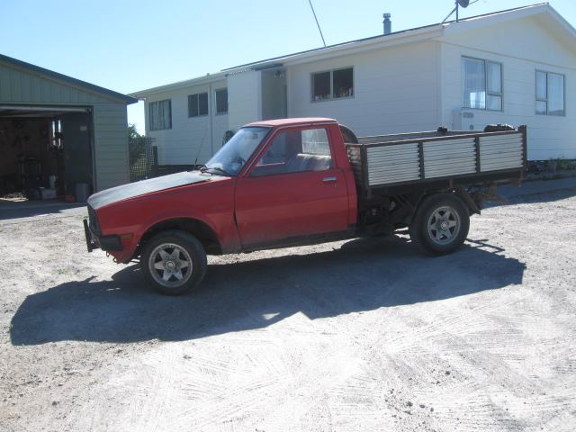

    I had an older model L200 at the time that i had done a 4G54 conversion and tip/hoist deck on but, the body was ready for the scrap pile.
    I brought a newer double cab ute with a blown engine and had been sitting for about 2years under a tree.
    once they engine was fitted to the new ute it was running fine for about 6 months till the heater hose split and i cooked it.

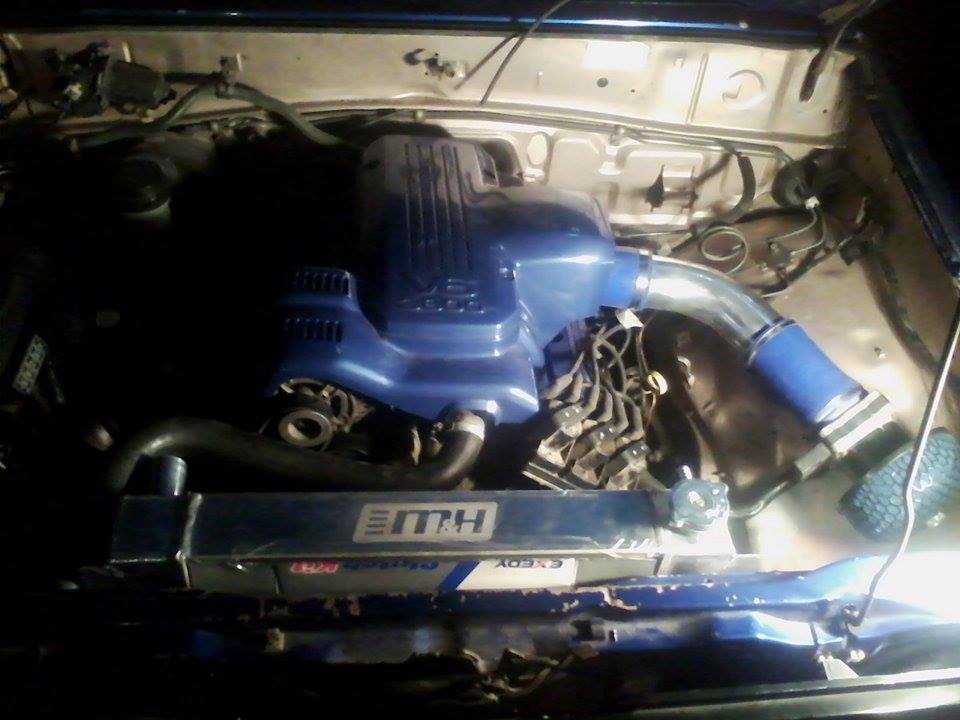

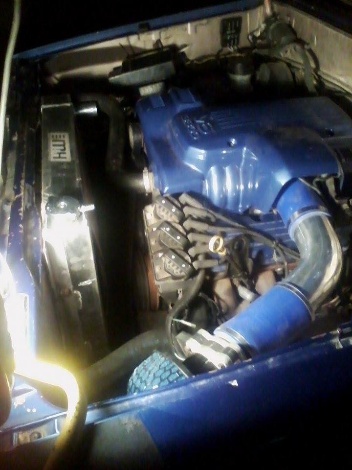

    since then ive fitted a 2003 VX holden commodore engine and auto trans. this was fine till i got sick of the slush box and decided to go with a T5 manual. here are some pix of what it is like now....
    11134420_10153266089629874_1051413760_n.jpg11145931_10153266089384874_772959182_n.jpgIMG_20141221_160634.jpg11124690_10153311326614874_440279577437788620_n.jpg
    just wanted to see what you guys think. any questions?any advice? Im wanting to do a body drop. has anyone done or seen one done before? any info or help would be great!!!

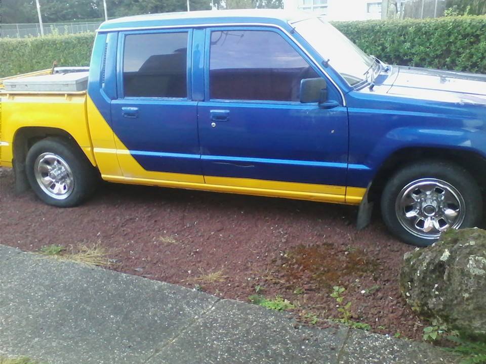

    thanks! I've owned the blue/yellow one for about 2 years now, it has been a work in progress for the last year. It is currently not driveable as i dont have a driveshaft made up yet and funds are a lil tight atm.
    here are a few pix of the build......
    mocking up....

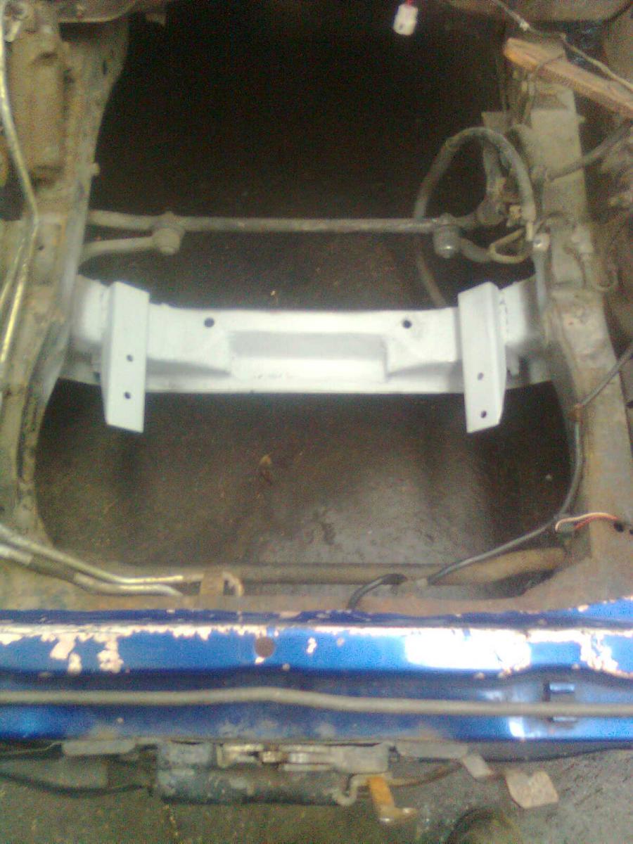

    cut out old mounts, made up new and welded em in. noched the crossmember
    the auto fit in fine with just a small mod to the floor to clear the trans cooler lines and filler tube.
    I soon got over the auto and started gatering parts for a manual convertion. they proved very hard to find in New Zealand so i had to get alot of them from Australia.

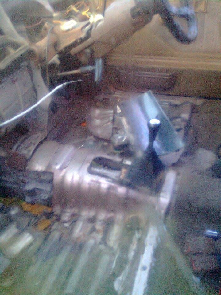

    I soon found out the hard way that fitting the T5 box in the tiny L200 tunel was never going to happen... so out came the grinder....
