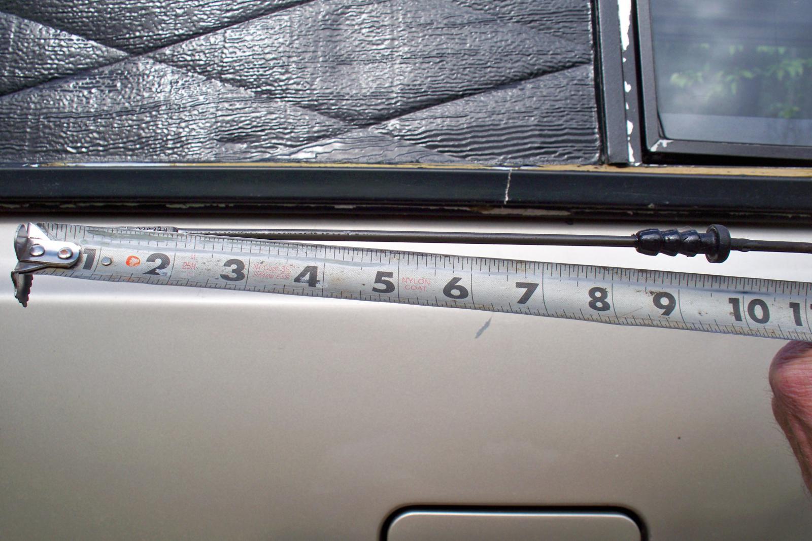

    I still need some one to measure their dipstick so I know if mine is OK. I want to do the diesel flush as I have the dreaded tick and I don't want to over fill the crankcase. I can't find any info on line.
    1,267
    On my 4G64 it measures 8 - 5/16 to the very bottom of the rubber stopper.

    thank you so much for your help
